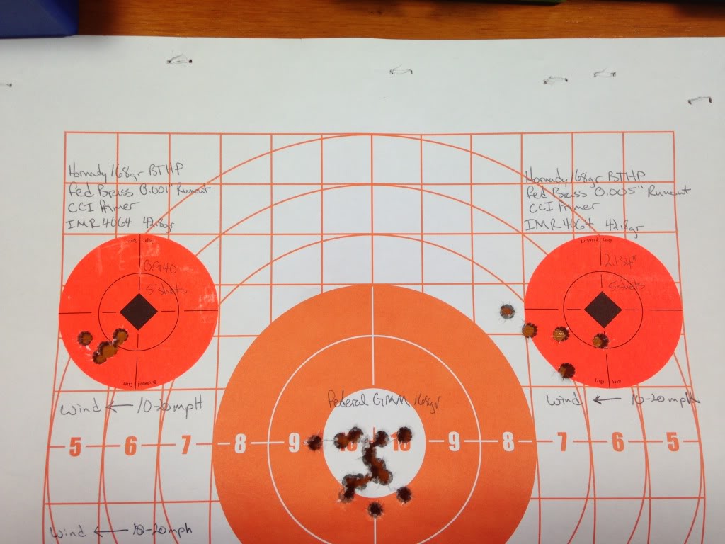

Has anyone ever done a test to see how much runout matters? Like a set of the exact same hand loads separated by runout and shot for groups? Surely someone has. I can’t imagine anything under .0004 would matter to a tactical(0.4 moa) shooter.
Here is a thread I posted quite a while ago, where I did exactly what you suggest.
Measurements are outside edge measurements. The FGMM is not really a group as I was monkeying with the rifle’s function before shooting the handload groups.
It’s a good start but you’d really have to test a lot more bullets preferably in a few different rifles to show any significance. I’ve done a ton of tests to prove to myself which issues matter and don’t matter. I’ve never been able to test runout because my runout has always been pretty minimal. Not sure what keeps it in a good range but I’m not complaining lol.
