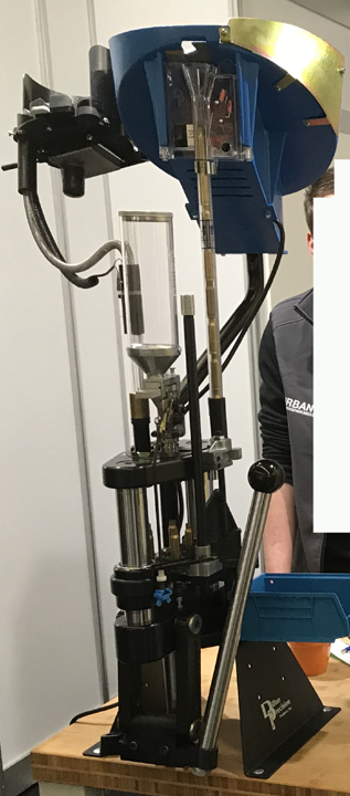

I met both of these manufacturers at the IWA last March. They guys from Treibel can make any die desired and guys over at Turban are testing their new progressive press.
Here are some info on the new press:
- 5 stations fully usable
- quick change headplate system
- all gliding surfaces hardened and finely machined
- all moving parts are supported by industrial grade bearings
- compatible with DillonXL650 conversion kits and accessories
- 7/8 -14 UNF thread in all headplate stations
- compatible with Mark7 Autodrive
- standard caliber size up to .375 H&H Magnum

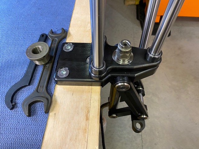

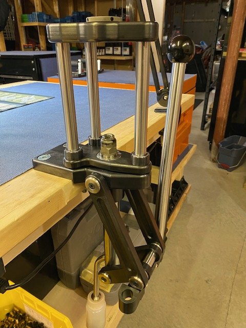

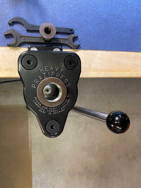

Yes , they speak, read and write English perfectly! The press is heavy 15.5kg (34.2 lbs.) so you'll need a good bench to support it. Mine is bolted to 2 x 3/4" plywood + 1/4" plywood all glued and screwed. So the mounting surface was 1-3/4" thick. Some pics below.

Very very Nice!!! Congratulations. Thank you for the pictures.

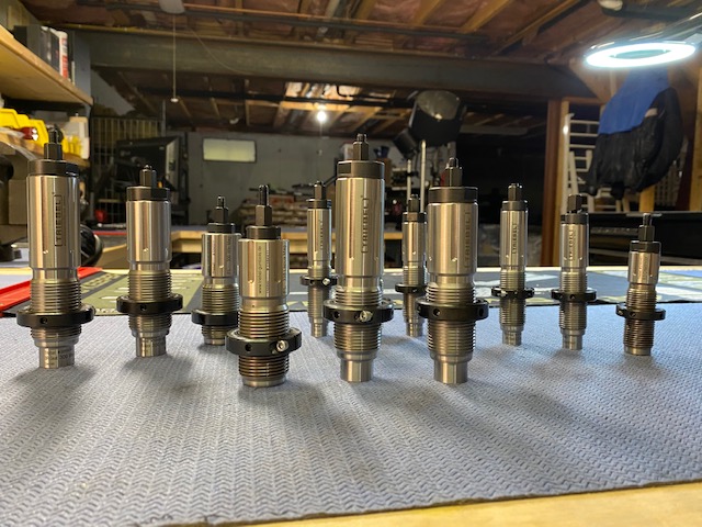

Nice set up man. You need some die blocks to stock your dies. Area 419 has nice ones. Unless your dies are 1 1/4"
The larger calibers (.300WM, .338LM) are 1-1/4", the smaller calibers (.308 Win, 6.5CM) are standard 7/8", the press comes with 2 inserts to accommodate both sizes.
