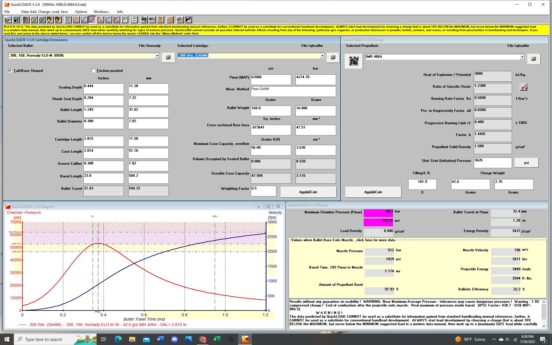

Not sure if this will be helpful but it is my go to for the 168 shoots amazing out of my LEO spec Savage.
