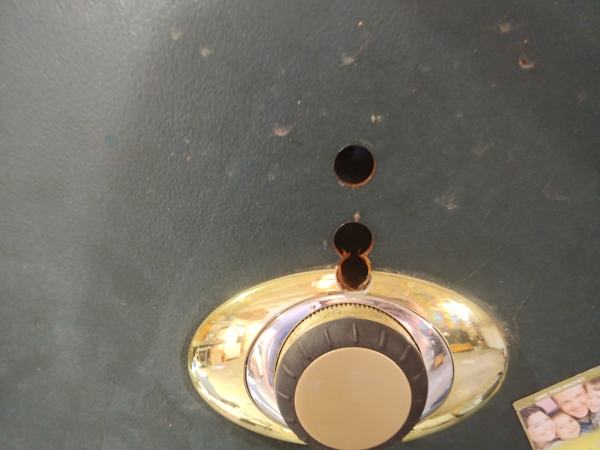

What if my ammo safe has vent holes in it lol.
I reload in the garage. Its 100ish here in the summer and can get almost freezing in the winter. It does frost but rarely stays below 32 for long. All my stuff is in the shelves around my reloading bench. I leave all thebpowsers in the cans they come in. Hasn't seemed to be a deficit yet.
Reactions: Munimula
Locked out before?
If a side has a bunch of powder in it, I wouldn’t trust those holes to be enough
I get it. Just looked at it again and was laughing at my own joke.
It was my fathers safe. He moved to Hawaii and couldn't take most of his stuff with him due to the strict laws there. So he secured them at a family members house. Forgot the combo after 2 years of island life.
I drilled the safe for him. Combo still works. Just looks shady as hell so I can't really sell it or trash it since it looks like a felony. So bulk storage it is.
