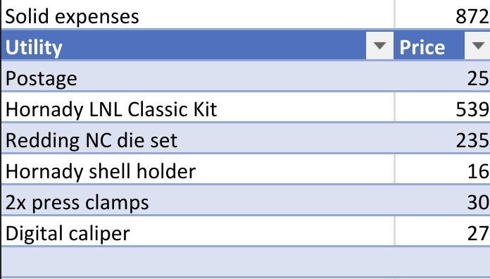

Reloading kit in stock?
richie3888
Mar 5, 2022
91
32
California
Looking to buy a reloading kit with .308 and 6.5cm dies in stock. Originally I wanted to get the Hornady kit but couldn’t find the .308 and 6.5cm died in stock. Anybody have a lead where I could buy a complete set?
Thanks.

My local range has everything. Expensive but not too bad. Imr 4064 for $40 a pound and $75 for large rifle primers.

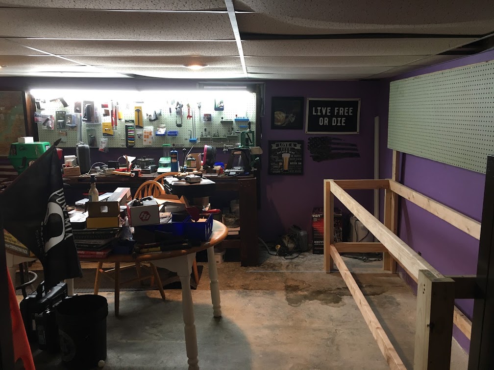

not even close. You can do a lot with $1000 - $1500
Bullshit. These low rent fools don't know what they don't know.
Like I said, if you want to make good ammo , efficiently its about $5K. That is on the lower end. This is for 1 caliber, and it goes up as you add more
Dillon 550 with accessories to run 2 tool heads, one for case prep and 1 for Priming/powder/Seating $15-1800
AMP Anealer $1200
ATV4 $1,000
Dies, Bushings, Mandrels, Measuring tools,ect $6-800
Henderson Trimmer $800
Wet Tumbler and Case Cleaner $300
Probably another $500 min MISC shit assuming you have a good place to mount everything.
Now you can subtract like $1K if you want to use something like a nice turret press, but you will significantly increase the amount of time and steps. But the list above is buying quality stuff that will work. Most people using shitty anealers (Myself included) don't really even know if we are anealing. With the AMP, its down to a science.

If I was starting out right now, I would look at the RCBS master kits as a place to start, you can order directly from them, then order Forster micrometer dies, that will get you loading good ammo, then you can decide how far down this rabbit hole you want to go and sell off what you don’t like or need. If you are looking for a good press comparison check out ultimate reloaded press shootout. Spoiler the good old Rock Chucker does very well
