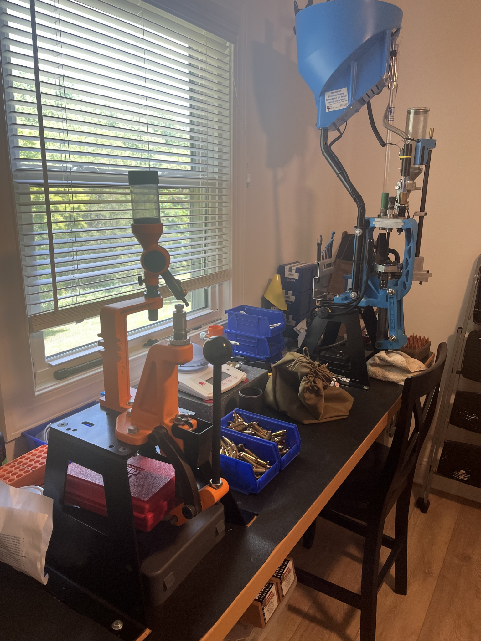

$5-10K for a proper reloading setup with good repeatable tools that are efficient and will not waste time.
AMP with casemate
Turret or Dillion 550 with multiple toolheads setup for brass prep and loading
Henderson Trimmer with all toolheads and colets
Autotrickler
Good bushing Dies
Good Seating Dies
Good measuring tools (Hornady is not good)
A good hand or bench mounted primer.
A tumbler, preferably wet with no media and a good cleaner like Brass Juice or BT Brass Cleaner. You could also do ultrasonic.
A dehydrator or other way to dry brass quickly so you don't get water stains on them.
Misc accessories like mounts, inline fab rails, holders, reloading trays, lubes, cases, organization, ect.
Bench worth a shit, preferably mounted to wall for extra rigidity.
Then you add primers, powder and bullets.
