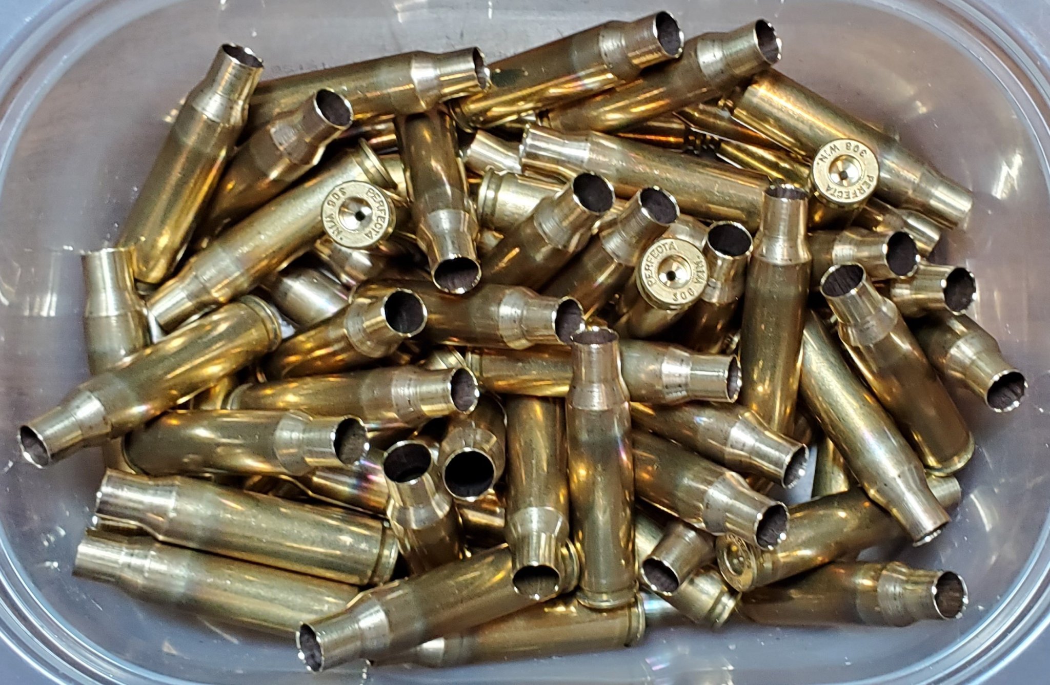

I've got 72 pieces that I picked up as range brass and fired them twice. . . a few years ago. So, they're 3x fired. They were fully prepped where everything was uniformed, including turning the necks. I fully prepped them as an experiment to see how they'd perform relative to good brass. They did pretty well, actually, though still not as good as top tier brass.
You're welcome to have them for nothing other than shipping costs. I have so much brass, they're doing nothing more for me than just taking up shelf space.

Mine are from range brass that I fired 2x times for a total firing of 3x. The loads I used in them were not hot. . . like 41.0 grs. Varget. All flash holes are centered and the primer cups are not loose (not really tight either). Checking for any body stretching for any indication of case head separation show no signs. Currently they've been full length sized for the first time as before I had only neck sized them. The brass does seem to be a little softer than what I see in Lapua and Peterson brass.
Here's a pic of what I've got:
