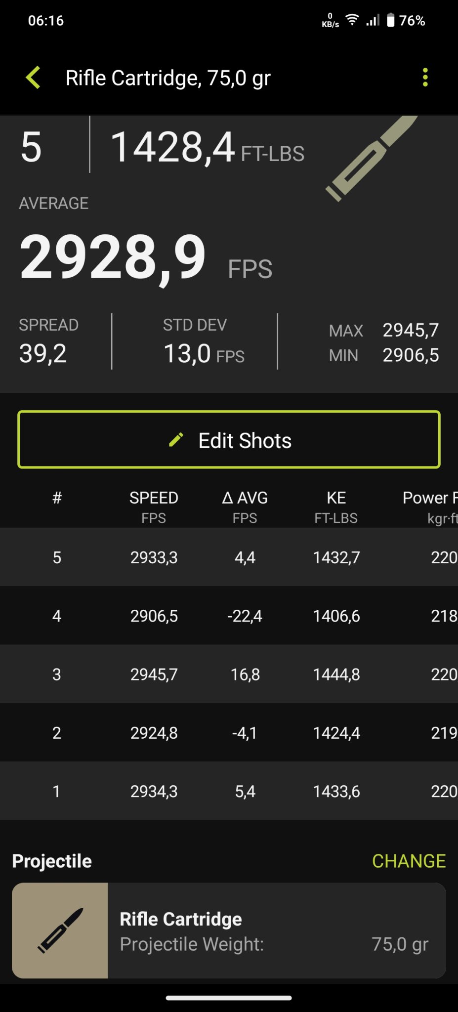

This is the best I can get shooting the Berger 75gr VLD out of Lapua brass

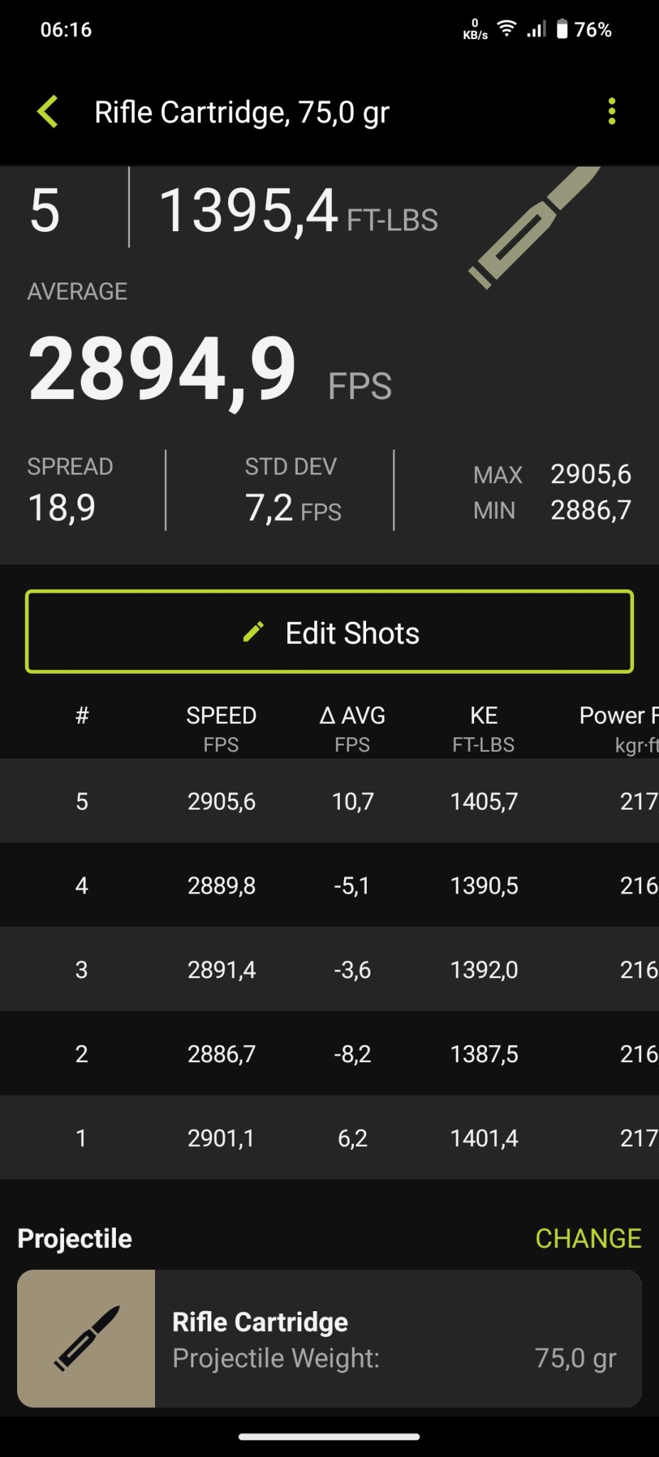

This is from LC brass also Berger 75gr VLD
