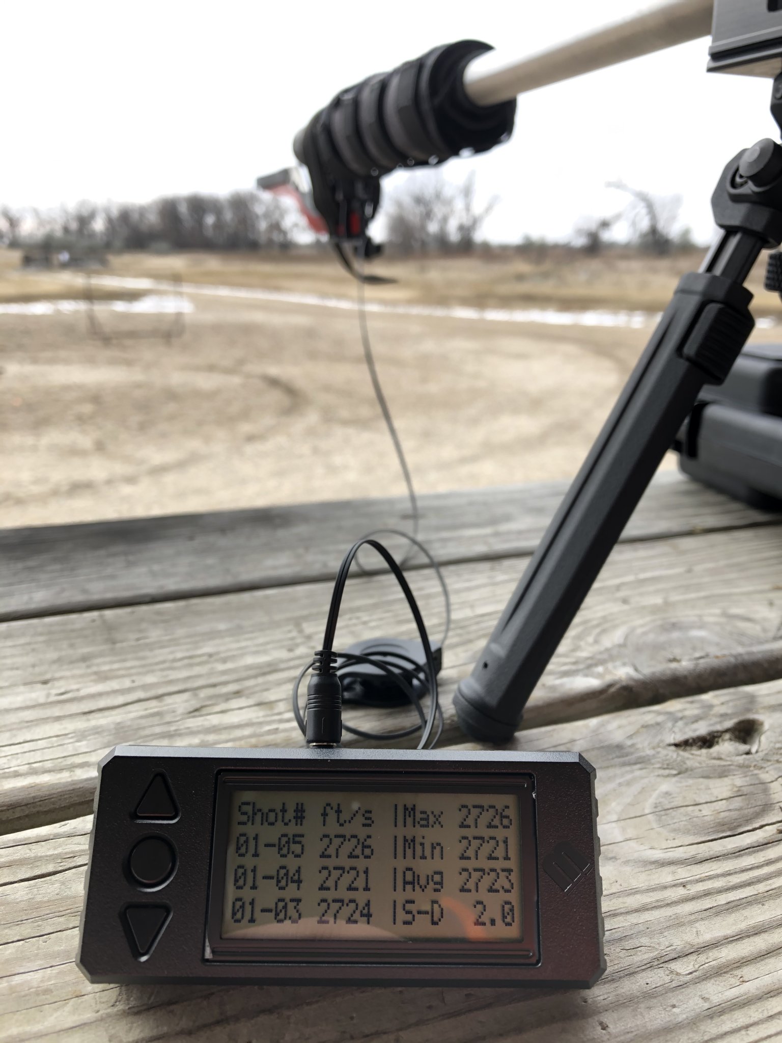

If you are serious doing 1000 yards and beyond, get yourself an chronograph. Try to get your ES to single digit after you gain most precision rifle reloading skill. For Example you can shot a 0.25 moa group at 100 yards with ES 25+ fps. But when you taking the same load to 1000 yards, you will see your vertical spread will be greater and might causes you miss the target at 1000 yards.
For the neck tension, remember that a thick case neck with .001 neck tension might have equal or great than a thinner case neck with .002.
IMO get yourself a good chronograph. Magnetospeed V3 or Labradar. They make load development way easier and if you have any fliers you can be relatively confident that the flier came from somewhere besides your charge weight.

If you have more money to spend and want to automate the process, look at the V3 Autotrickler and Autothrow setup. It throws charges onto the fx120i scale down to a kernel or two in 10 seconds or less when set up correctly

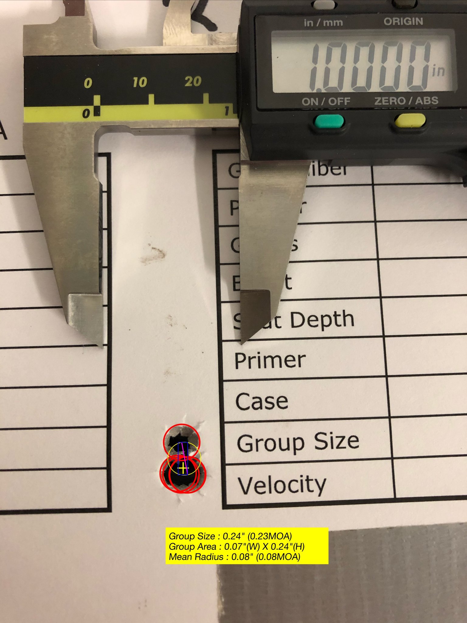

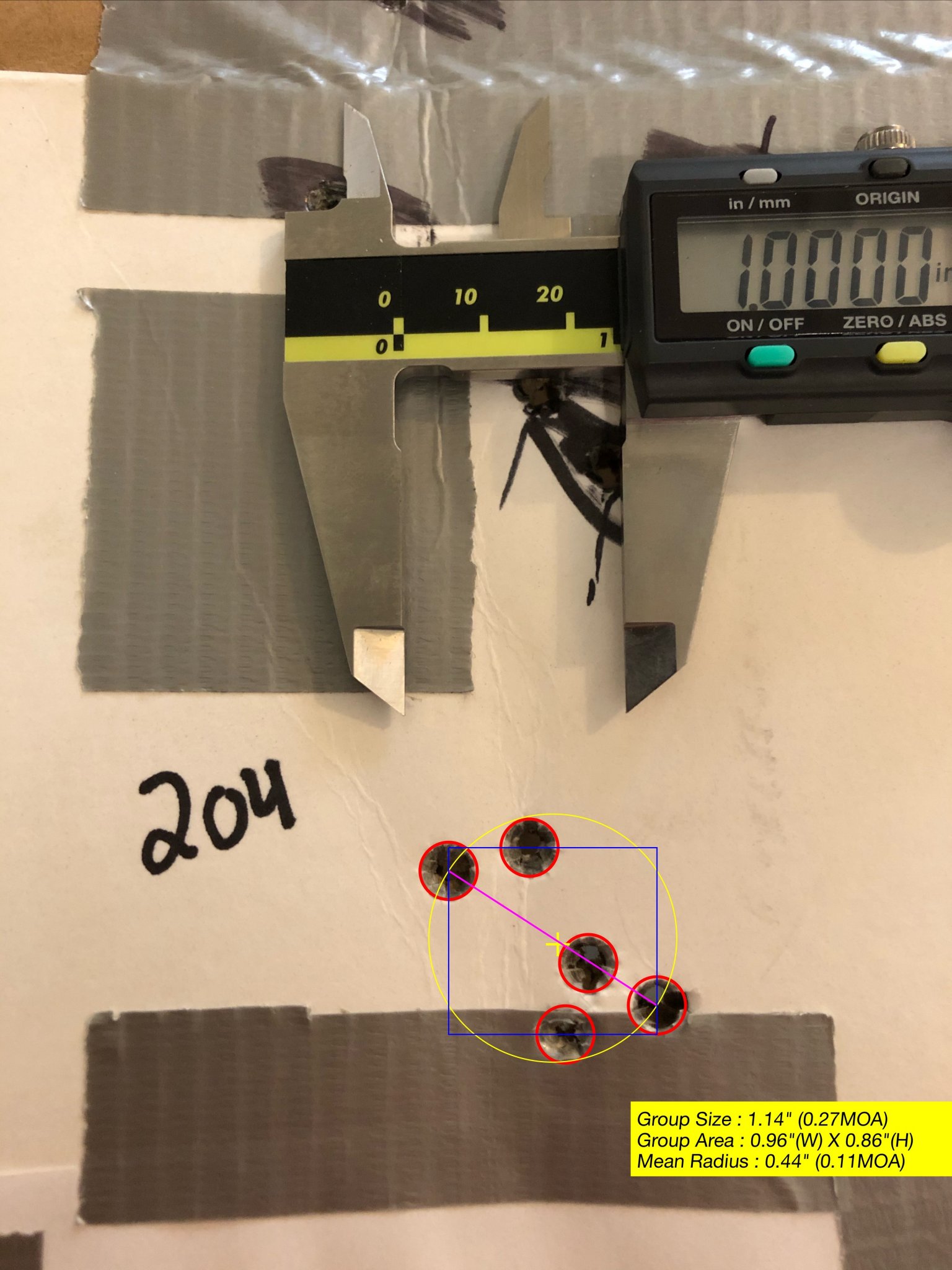

And all that wasted time and money can be avoided by using load development methods that create accurate loads that are tolerant of the minor variations in charge weight inherent in less expensive equipment.
