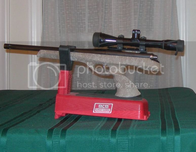

    Technically if you use a neck size die it can work without lube. This little XP runs fine with neck sized brass run though a Dillion in one pass. I even tried it with the RPR and the group at 300 yards wasn't half bad. However, you have to be very careful, checking at least every five rounds to make sure you are getting consistent powder throws.
    Still, with PRS type r the RPR, I size, clean lube then prime, load charges individually with a scale, then seat the bullets. Using the SRP brass for the MPA, ti is a pain to set it up on my small primer Dillion so I wound up loading them on my single stage Redding press. Rifle rounds used for hunting, all single stage on the Redding Boss.
    Still I don't recommend it.
