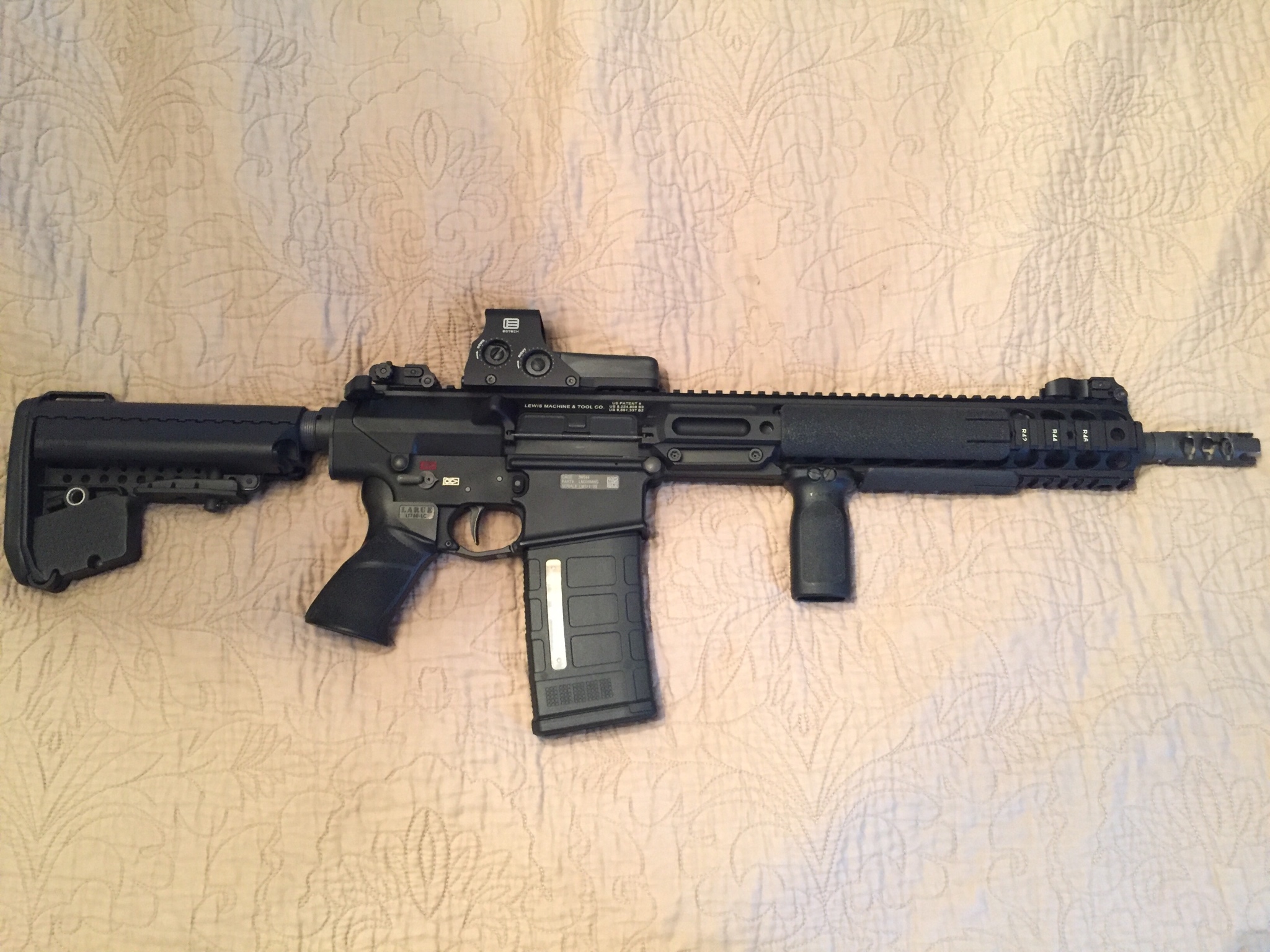

Hello all,
Due to my recent addition of my LMT MWS I figures instead of paying a dollar/rd or more, it would be best to finally get into reloading.
Since I know little to nothing when it comes to reloading I figured I'd ask you guys, what do you think would be the best reloading setup for 300-400$ and your favorite 165/175gr loads?
Thanks guys. :)
(Don't worry the Eotech is coming off)

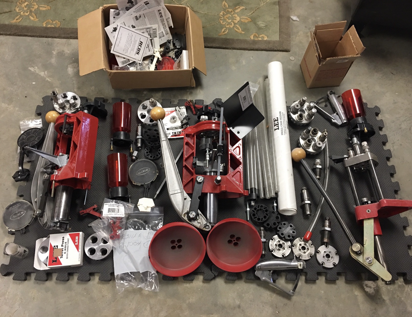

I just got my first reloading equipment myself. Stumbled upon a deal where a guy was looking for a Glock 42. I sold him the Glock for the items pictured below and an additional $180. He also kindly gave me 1,000 SPPs, and 1,000 Missouri Bullet Company 40 S&W bullets to get myself started.
7035723
Pretty good score if ya ask me.
Reactions: Snuby642
