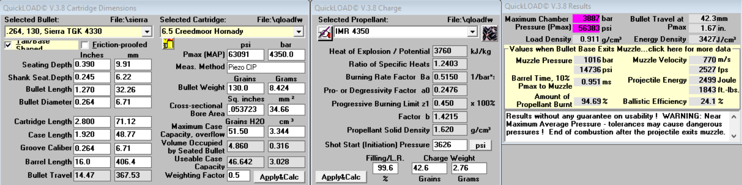

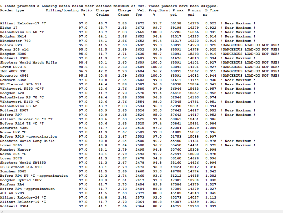

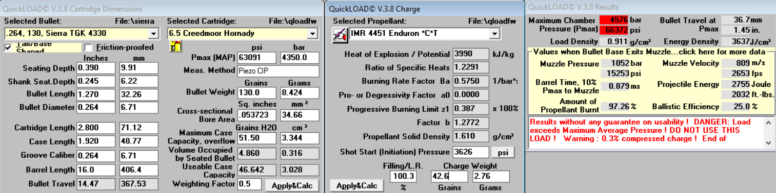

Quickload estimates you're getting close to 97% burn rate in that barrel (the fps numbers don't totally match yours but are in the ballpark)
IMR 4350 is slower, so less % burn in that barrel, but pressures look safer.
Running the numbers for powders with a 97% fill rate at the pressure limits says:
- Shooters World Match Rifle & AA4064 look good but right at the edge of pressure
- RL17 won't get 100% burned but looks the most efficient in your case
Thank you for that information. I will stick with the IMR 4451 for now. With the 16” barrel, the rifle is very loud. I thought that was due to more powder burning outside the barrel. I’m going to a 600 yard practice shoot on Sunday to see how this rifle performs!
