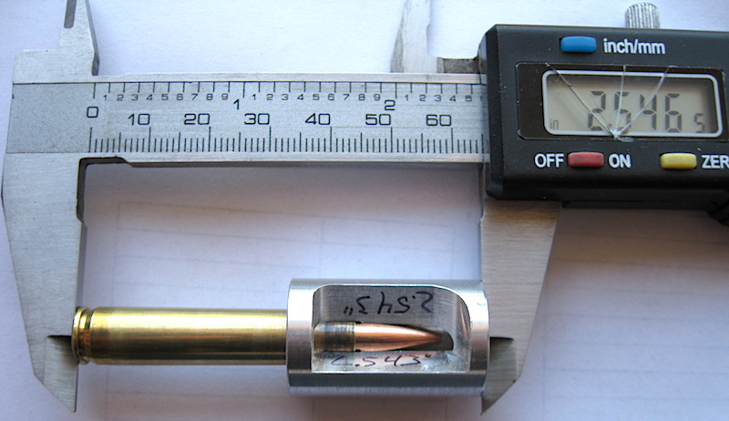

If your rifle's ever rebarreled, ask the 'Smith for a chamber stub gauge cut with the same chamber reamer to go with it. It's been very valuable to me for load development and brass processing. It makes it super easy to set bullet seating depth and shoulder bump for FL sizing and to see when it's time to trim case necks.

4. Buy the Hornady's gauges that let you measure bullet seating depth and case shoulders
