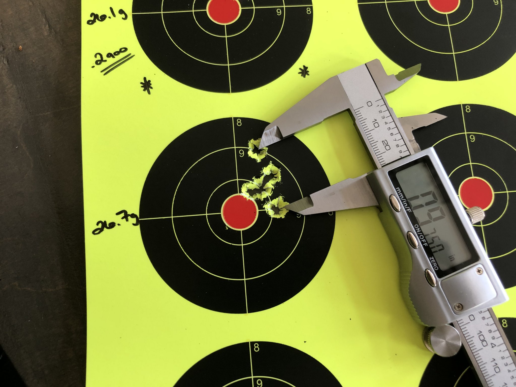

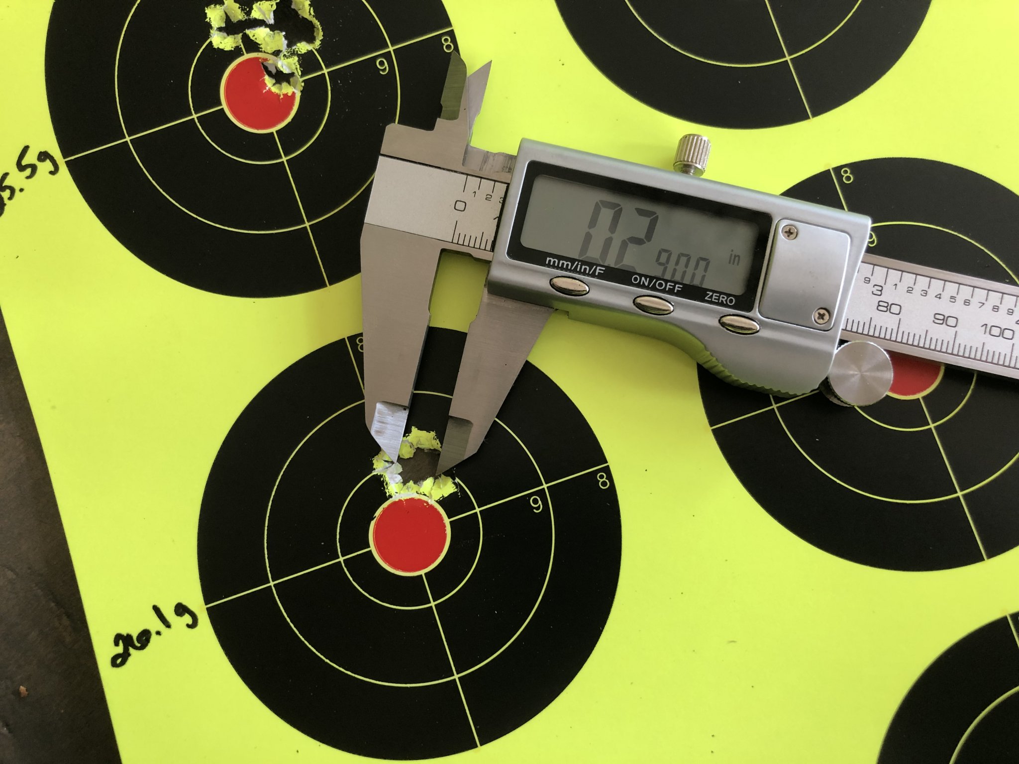

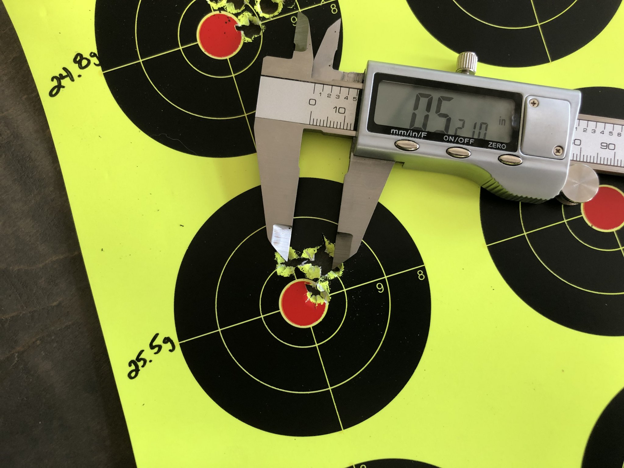

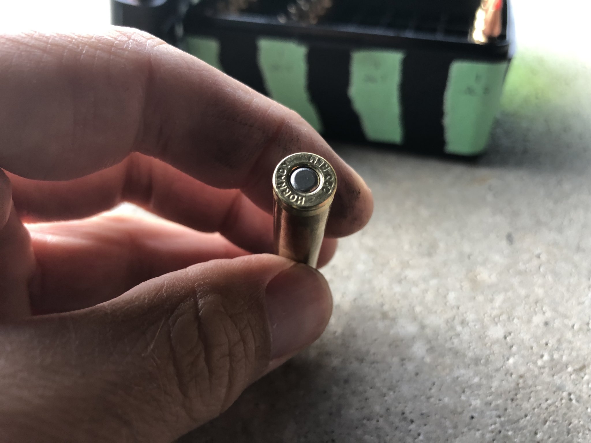

Words can’t describe how excited I am! With much help from the forum members here this week on figuring out my Hornady OAL gauge, I finally complete 20 test rounds to try in my T3x Stainless .223.
I thought the process of simply making the ammo was fulfilling enough (quite a bit of satisfaction in holding a finished cartridge in your had after hours of work).... but having a load work out as well as I just experienced- you’ll see in pics below, well thats the icing on the cake!

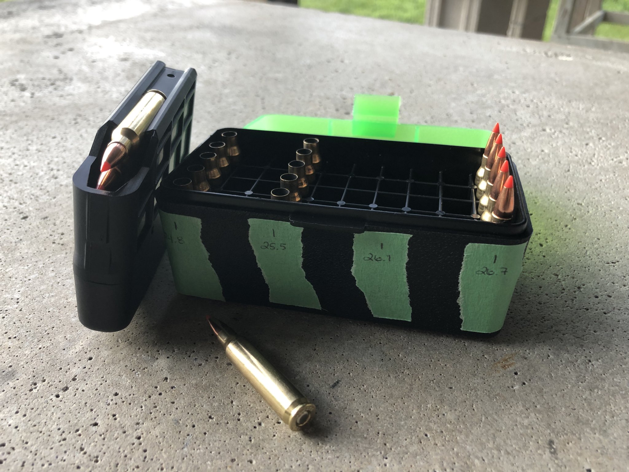

I used Hornady American Gunner brass, with CCI 450 primers, CFE223 and Hornady VMAX 55g bullets. I followed the load data in the Hornady manual and made 5x of 4 different powder charges.
24.8g
25.5g
26.1g
26.7g

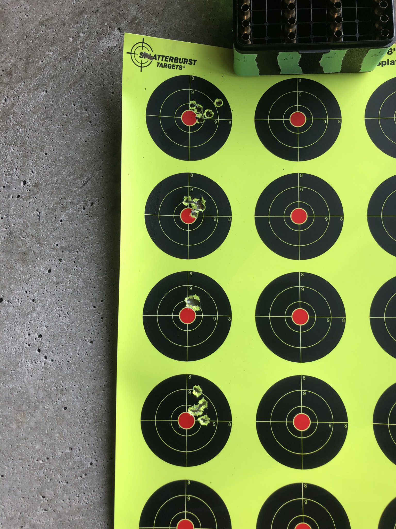

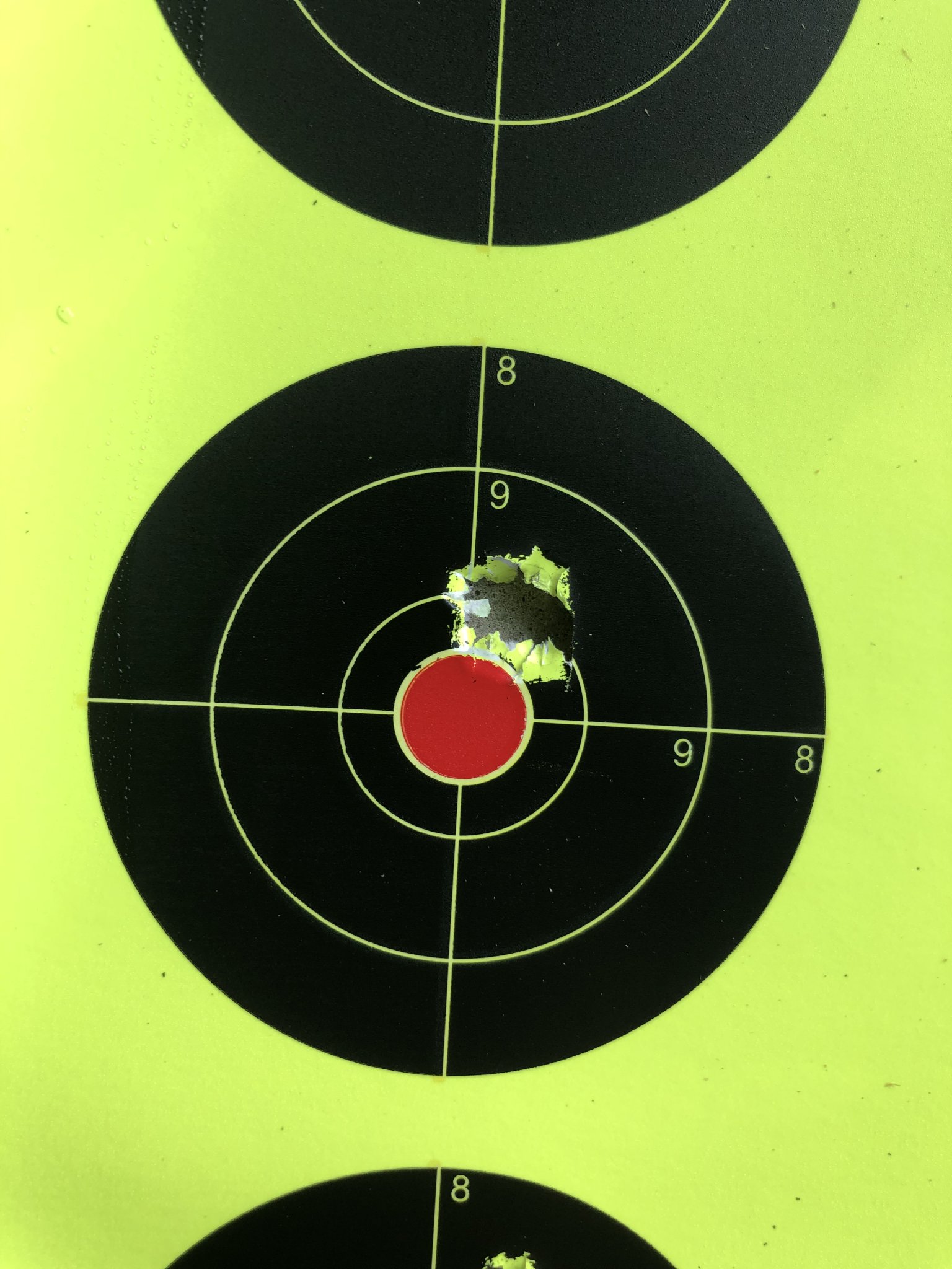

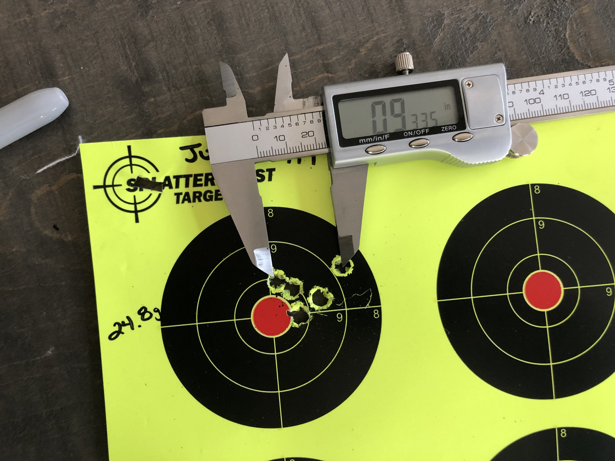

All charges were shot at 100M in 5 shot groups this morning in perfect conditions. Zero wind, about 15 degrees Celsius. Worst ground was under MOA.
BEST GROUP WAS .2900” :) :) :). This was shot with the 26.1g charge. I couldn’t be happier!!
This begs the question, I see most guys will adjust loads by increments of .2g. Should I load up another test batch of 25.9, 26.1, 26.3, 26.7? See if it’s possible to tighten up the group? Or am I asking too much?

I think you found your load @ 26.1 grains!! Nice work!
I think so. I’ll confirm in a day or so - make sure it wasn’t just 5 lucky shots :)
Just joking with you. It isn't always as easy but I'm glad you had good results out of the gate. I had some fantastic groups with the first precision rifle loads I attempted and I thought - what's all the fuss about, this reloading game is simple. After more guns came along, I started to figure a lot of other things out. Just stay with it and don't get frustrated if your pet load falls apart at some point. Or, if it's not as easy with your next rifle. Reloading is a sport, science and art all to itself. Read, research and have fun with it. I still do. Only my .02... And FWIW.
I have 3 more rifles to load up! I’m sure this was just my lucky day haha. I can only imagine how frustrating the process can be when you’ve tried different bullets, powders, charges, etc!
Thanks a lot guys! Pretty excited - this reloading takes time (after trimming 100 223 cases I realized I have to get the power attachment haha - my palm was on fire!).
Last night I loaded up 15 rounds of 26.1g. 5 rounds of 25.9g and 5 rounds of 26.3g. Now to test again. Going to try and punch another hole (hopefully) at 100M with the 26.1g, then do 2 groups at 200M and see how it opens up. I'll then give the 25.9 and 26.3 round at 100M and see how they do also.
