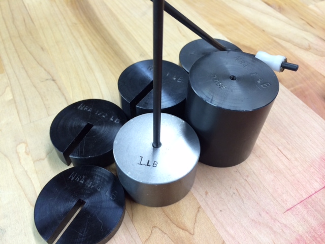

I have all my triggers down to 500 grams using NRA weights, and they have been reliable.
