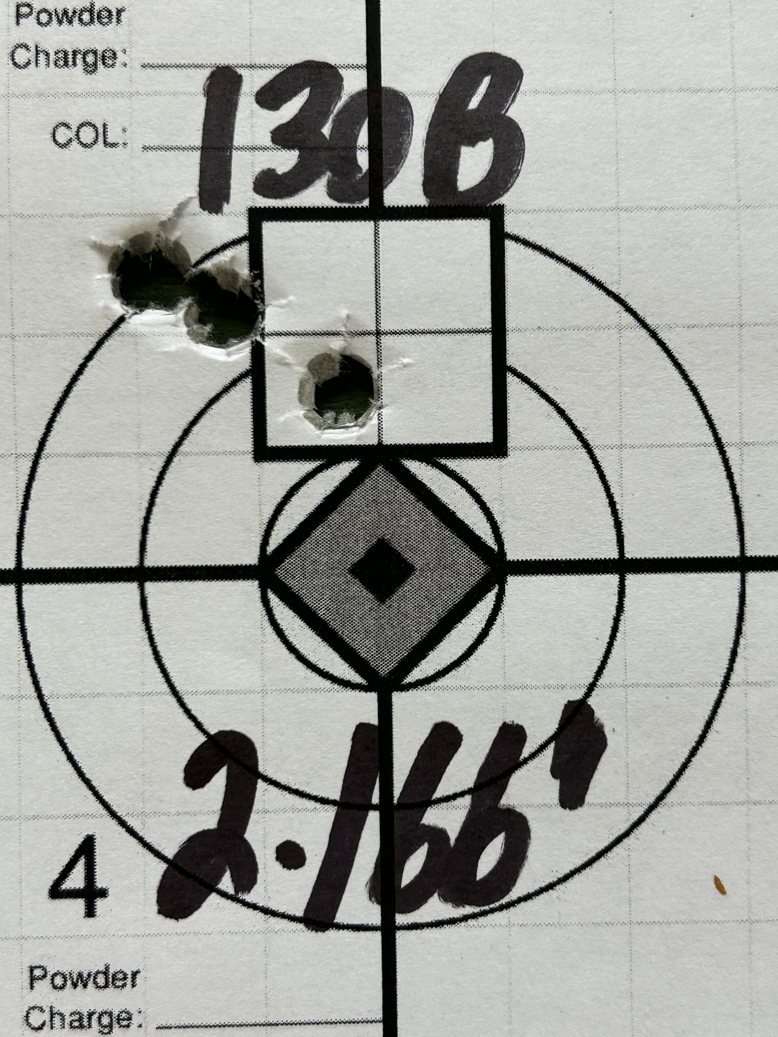

I have a Daniel Defense Delta 5 with a Nightforce Atacr 5-25. This was my first time shooting this setup and confirmed and set zero at 100. Shot two types of ammo that I had done well. My best group was about a 1.5 inch group. Most likely me but my question is, how much of an improvement do hand loads make?
Back in the day, I used to hand load for a .308 I had and I used to set the overall case length to .010 over the chamber length so it was setting case length and seating when I closed the bolt. I sold my setup about 6 years ago but I am getting back into shooting. Just wanted to confirm what people are doing and what kind of results over stock ammo someone can expect?
Thanks

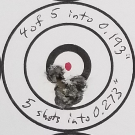

Well, it depends on a lot of variables but if you have a good barrel on a good rifle, you should be able to get 1/2" at 100 yds or better.
On one of my rifles I was working up a load for, everything I tried on it was less than 1" at 100 yards. My latest testing experiment looks like I found a sweet spot that will be under 1/3" at 100 yards.

I'm assuming you mean that you jammed .010, in that your overall cartridge length was .010 longer than when you measured a specific bullet to the lands??? If you were jamming the case mouth into the chamber, well, that would be a new one for me... but I haven't seen everything yet.

It was a trick someone taught me years ago about setting your case length .010 over chamber length. I idea is you are kind of doing the final seat of the bullet when you chamber. I have heard guys do but but you clearly can go too far.

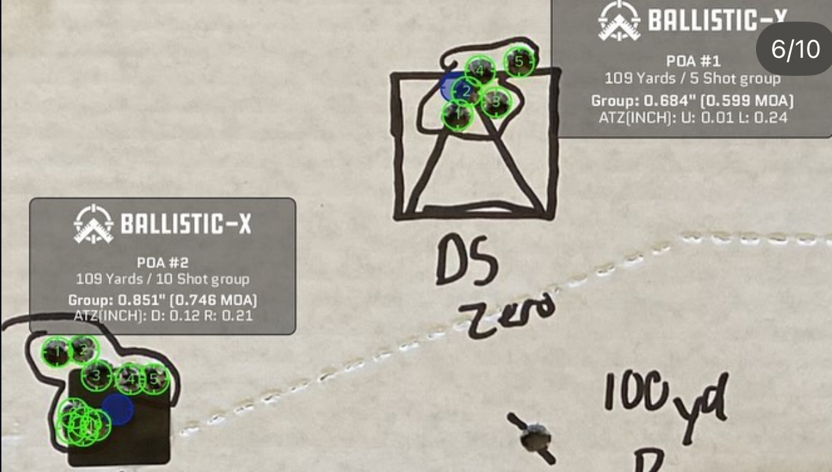

I have a delta 5 pro and have shot multiple 15-20 shot continuous strings out of it and they were below a minute.
6.5 creedmoor Small rifle primer brass, Berger 140 hybrids. 41.5 H4350, CCI450, 2.850 COAL so they would feed in bolt gun mags and my AR10. You can do the same load with a Sierra 142, hornady 140 ELDM it will have similar results. Or just buy Berger factory ammo.
(click on to get larger picture)
Your results only prove that if a rifle likes a certain powder/bullet combo then it will shoot accurately despite the charge weight.
Great shooting!! But these groups don’t tell you anything more than the rifle likes what you are feeding it.
Shoot the same test again and post the results up if you think (good) 3-shot groups are insightful.

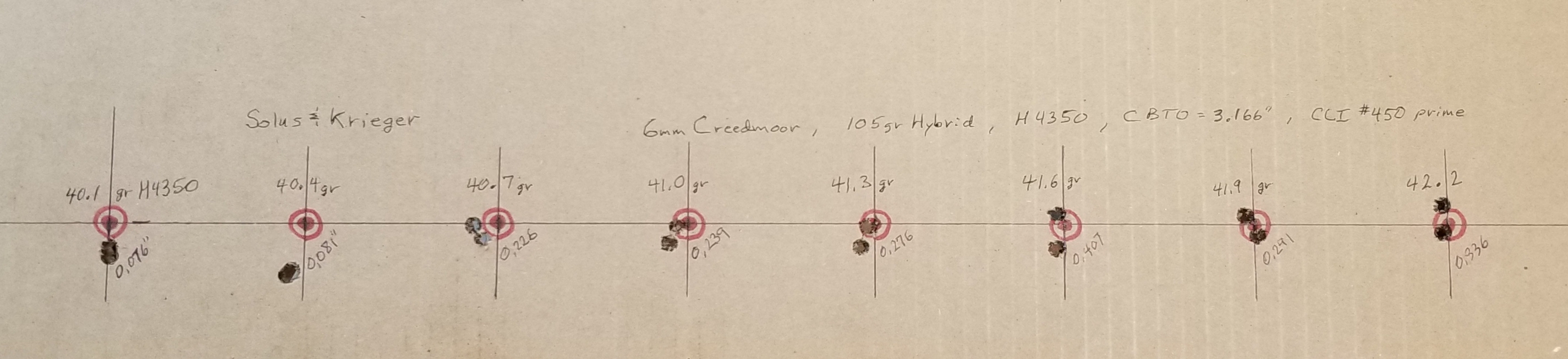

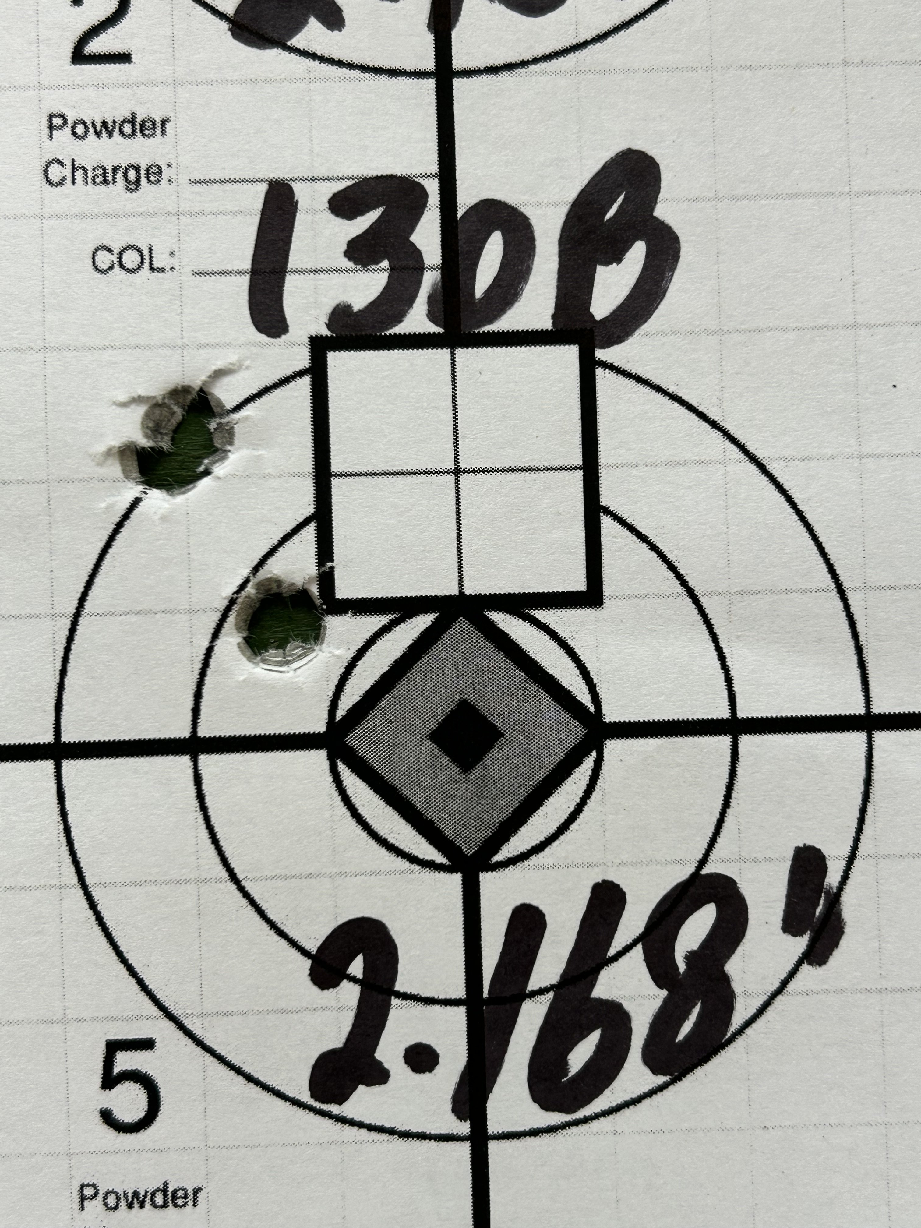

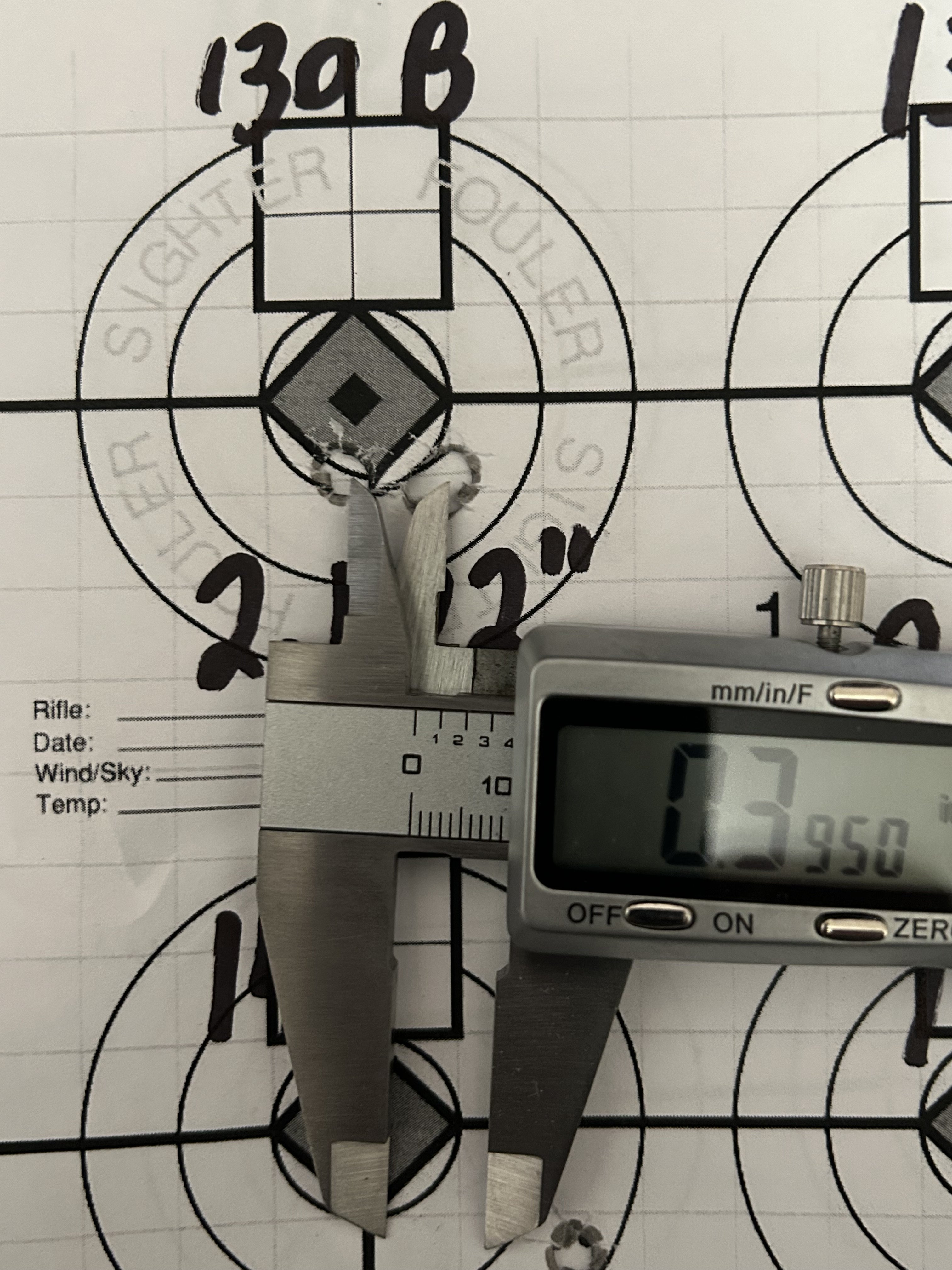

Worked up some hand loads on a Franchi Momentum Elite in 6.5 Creedmoor and shot this ladder test yesterday at 100 yards. Chamber measured 2.224” with Hornady comparitor. Less than $1,000.00 in this rig!
Your terminology is confusing. Do the numbers you have on each group correspond to a cartridge Base-to-Ogive (CBTO) measurement? What are you referring to with your chamber measurement?
I loaded some more up with 40.9 grains of H4350. Here's a picture of a 5-shot group at 100 yds.
(click on for larger image)
