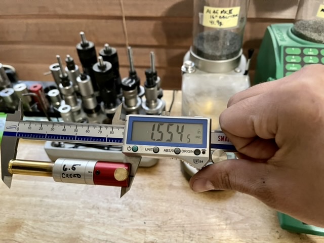

Oversized brass is brass with a casehead-shoulder datum significantly less than its fired casehead shoulder datum measurement after being ran through a f/l sizing die
Example (6.5 cm): fired case is 1.558” without the primer / primer removed.
You size the brass.
New measurement is 1.545” or something like that instead of 1.556” (bolt gun) or 1.554” (gas gun).
Use Hornady’s headspace gauge and dial calipers to confirm your measurements on both fired and sized brass to confirm or deny that’s the problem.
If the unfired round is hard ejecting, your brass may also not be sized enough (ch-shoulder on sized brass is too long) and is jamming into the chamber and bolt not fully going into battery.
Just a guess at this point.
eta: pic of hornady tool
Use a shoulder bump gauge to measure your case before sizing. Zero your calipers(*assuming you use a digital pair) while measuring the case and then size your brass down until the reading with the gauge reads -.003. I use this gauge from Whidden
