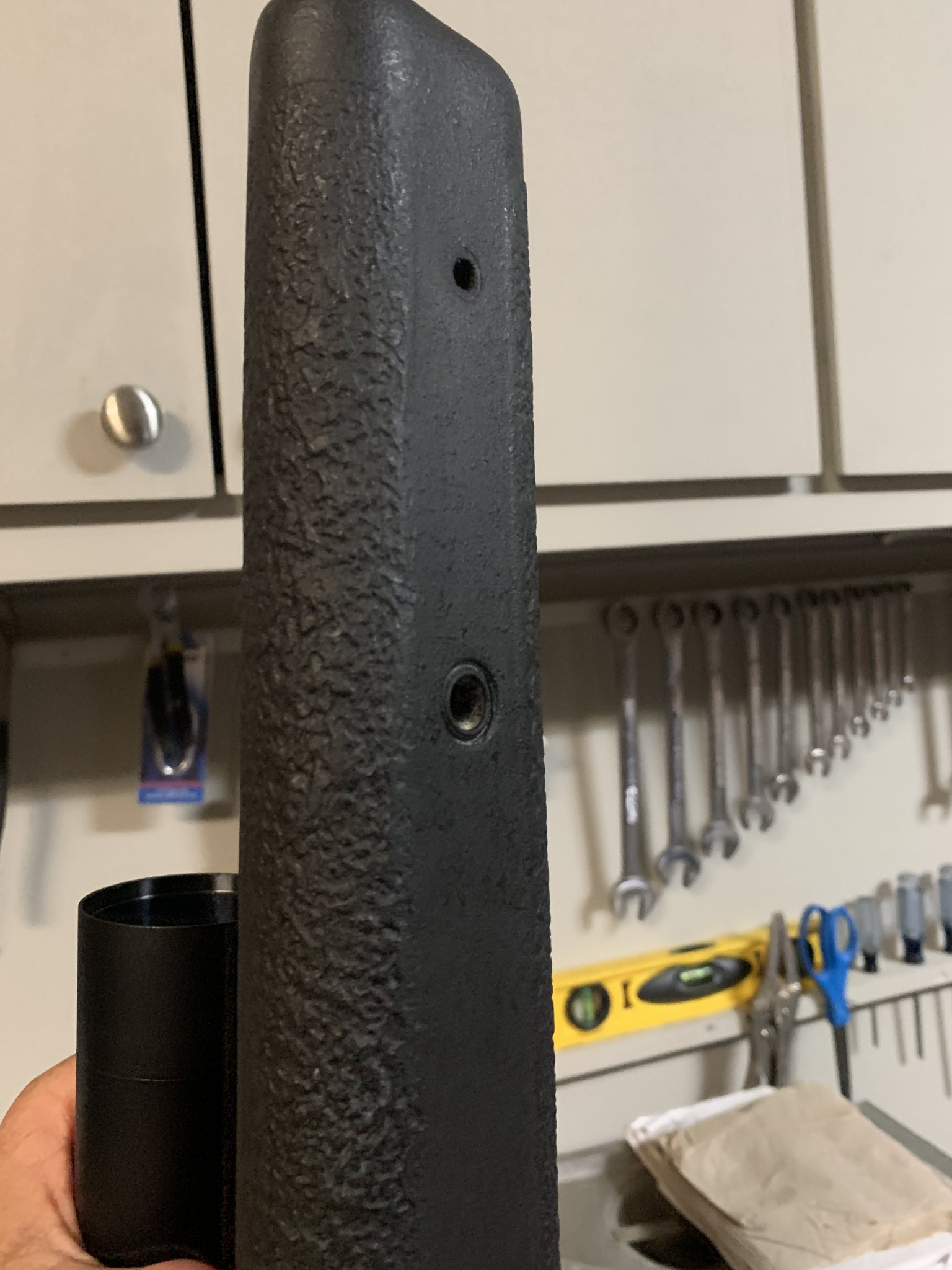

    Bought a very nice custom 40x in Macmillan A5 stock. I prefer an atlas bipod over bench rest, so I need to add a locating rail. Stock has a flush cup and swivel stud on 3” spacing. Any recommendations to add a rail using existing holes? I’d prefer not to drill...
    Thanks in advance!
    The McMillan rail I added to my Greyboe Renegade was a 3" spacing between the studs on the forearm so you could go that route but would most likely need to add a t-nut were the swivel cup is located.
    Another option is find a shorter rail so it stops just in front of the flush cup and add a t-nut so the flush cup is still usefull.
