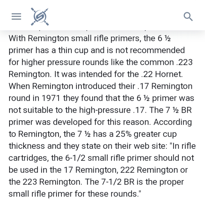

An excerpt from the thread " primer on primers" concerning remington 6 1/2 primer usage:
If remington didnt come out with the 7 1/2 primer, developed specifically for the .17 remington, until 1971, what primer did they use in loading other "high pressure" cartridges like the .221 fireball, .222 remington, .222 magnum and .223 prior to that time?

The post above yours may be what I read in the past that told me in my mind to beware.........now ,after thinking this through a tad more, I'm not interested in being the " crash test dummy " nor do I care to have to deal with possible pierced primer and or a possible "run away rata tat tat ".........Have plenty of other srp to load with.......so the 6 1/2 will be moved to back of inventory for sho nuff " hard times".
