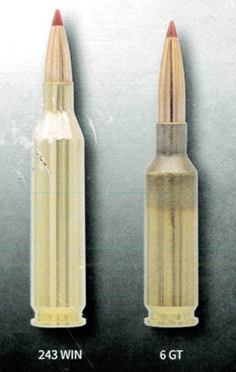

Fellas. Came across a great deal on a used Remington 700 BDL 243. It’s already heading to the smith to get threaded for my suppressor. And, I want to rechamber it. Question being, what can I realistically change to with a 1-9 1/4 twist barrel? I don’t want to buy a new barrel. Want this to be a cheap, light weight truck coyote/maybe deer rifle. And yes I know, the 243 would do a fine job. But I have a couple already and I want to play with something else. I have a large amount of H4350, H4831sc, Stabll 6.5, Superformance, 8208xbr and RL16. So, 243 AI? 6mm GT? XC? x47 Lapua? What’s my best choice for running 60-90 grain bullets with that twist? Thanks!!

Thanks! I was leaning toward the AI before reading that it’s not great in shorter barrels and I’d not really gain much. Having a Sandman L that’s almost 9” long is like the barrel 18-20 inches. GT brass seems readily available. Think I may run that race. I have allot of 90 grain TGK’s. Should make a decent coyote getter.

He'd have to set the barrel back and rethread also. He won't be able to just rechamber for a shorter 6GT. Might want to check if that's all going to be $40.

The 243 Ackley improved requires the barrel removed and set back one full turn...if the chamber finish reamer neck is the same size or slightly larger then the original chamber...it would be better to cut a new neck in the chamber to clean up nicely and have less firecracking if the barrel has been shot much.
But at least one full turn as the Ackley chamber is slightly shorter than the standard 243 chamber.
As Ackley designed it, you are supposed to put a factory 243 in the chamber... but have to smack the bolt down pretty good to chamber it.
Otherwise case head separation happens.
Which means you have to recut everything, pertaining to fitting a barrel to a Remington 700...like barrel tennon, bolt nose counter bore depth and dia. and maybe have thread.
Recalculate headspace.
And buy an Ackley go gauge.
Might as well buy a new match barrel in the caliber of choice.
OR leave it a factory 243, it will suit the purpose just as it is...and cheaply.
