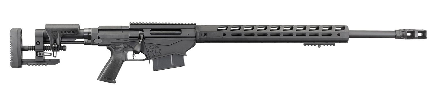

You can buy a RPR in 338 LM cheaper than you can build off of what you have. Not an engineer so I can’t speak to the the safety. Just an FYI, hope this helps.

RPR is cheaper as someone said above, and works extremely well. I have experience with both the 700 and RPR, and RPR is nice.
