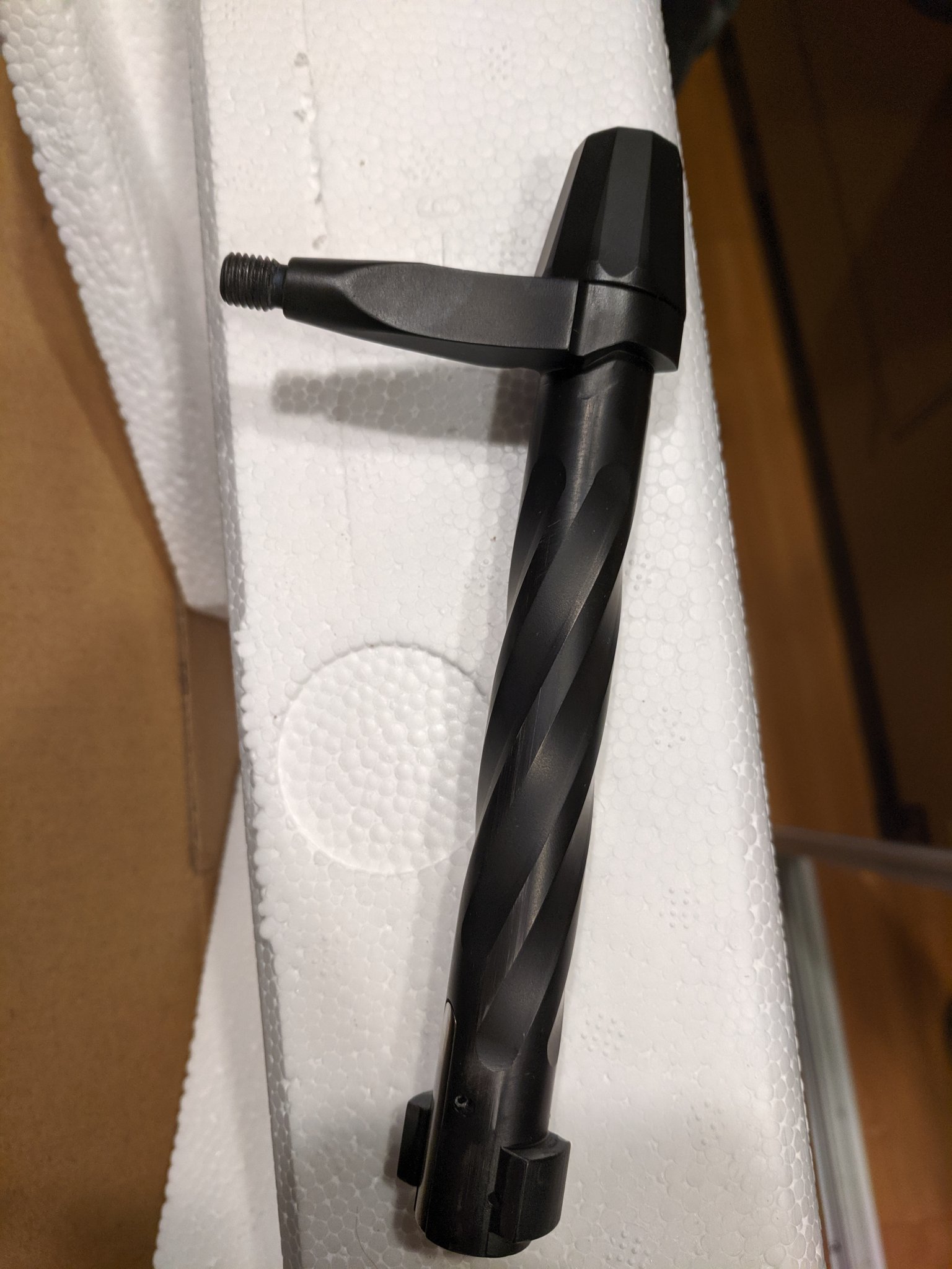

On the later Remington actions it’s a problem with incorrect bolt handle profile. This causes virtually no primary extraction that was designed in the action. The small movement till the click is the normal primary extraction movement. There are gunsmiths that can repair the lack of primary extraction. LRI comes to mind, I believe the refer to it as tig and time the bolt handle
How necessary is this ? The rifle functions, is there a reason or just a want to fix it?
I have an RR prefix action that has the same problem. It functions fine but I plan on doing a tig and time upgrade. By moving and recontouring the bolt handle it
1). Establishes the proper timing of trigger function
2). You gain the proper mechanical primary extraction. This will definitely be an aid if you encounter a slightly hot load that’s harder to extract
Problem is once you have realized it’s there, it will continually bug you. As stated above I have a rifle that has the same issue. Only reason I haven’t remedied the problem is I have hunted far less in the past years, and it’s a semi custom hunting rifle that doesn’t see much use currently. Every time I cycle the bolt it bothers me.
If you plan on keeping the action long term I’d definitely fix it. It’s one of those things I can’t un- notice.
