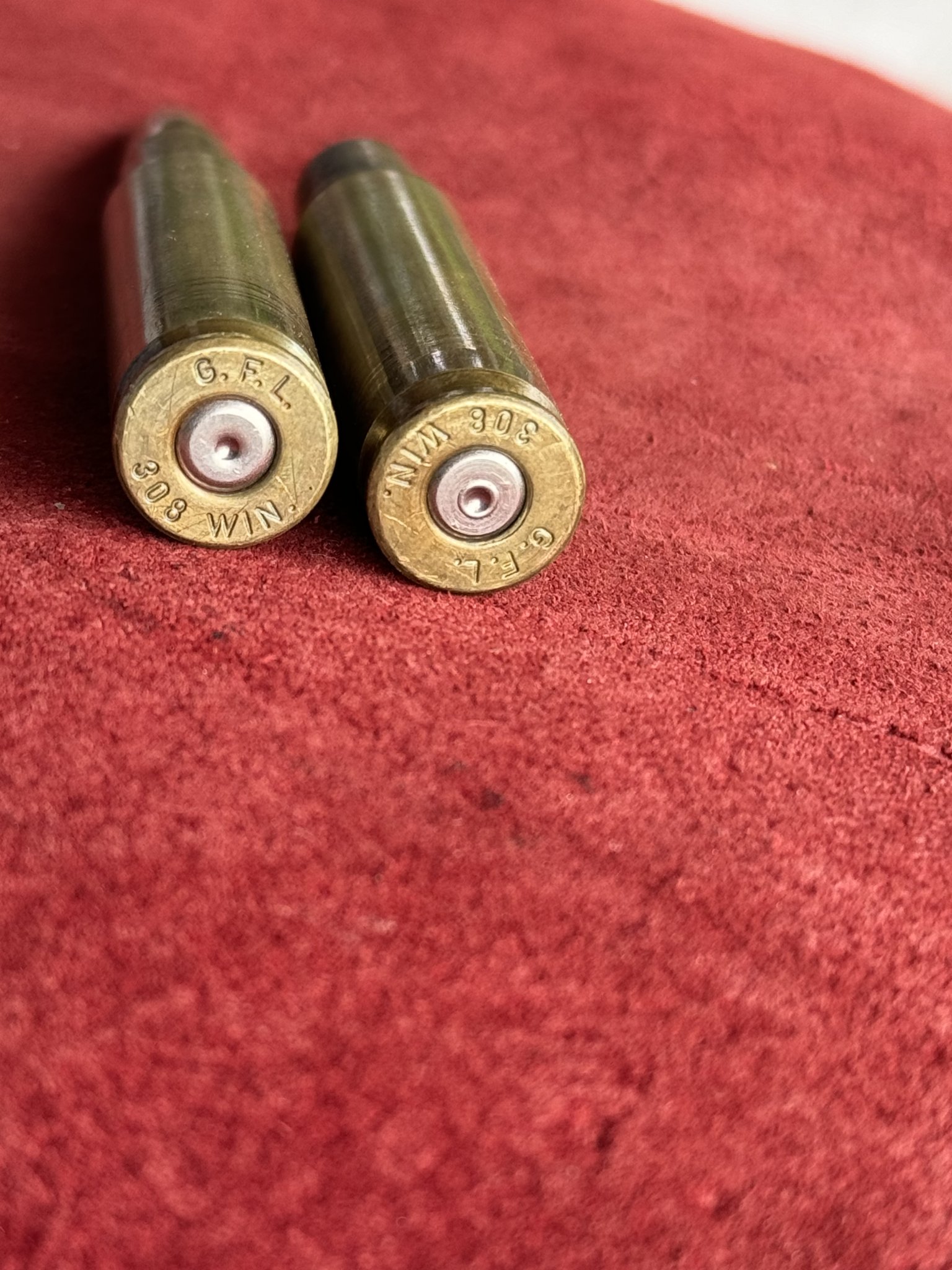

Not sure I was having problem with my trg 22 and was having issues with flyers. On barrel #2 trying to sort it out. My rifle was a 2008 so a pretty old spring. Always would shoot 3 in about .25-.3 of a inch and I would get 2 weird flyers. Replaced my spring yesterday and I shot 4 .25-.35inch 5 groups yesterday. Spring was about 1/2 inch shorter than the new one. They do get old.
What after market striker spring do u recommend ? In what lb? My rifle is not working well ...
The TRG spring is very short due to the firing pin design. Thus, to generate all that energy in such a short spring, they put it under a lot of stress increasing the risk of the spring setting. On the Remington 700's, the spring is much longer and when properly designed and made from the correct material and quality, the spring has a longer life. This is because it can store the same amount of energy for less spring stress.
Reactions: Tikkaguy
Makes sense to me. 170 bucks for the “sako tax” and it was fixed. Granted I did get a new firing pin with it
Reactions: DRAKENBURG
