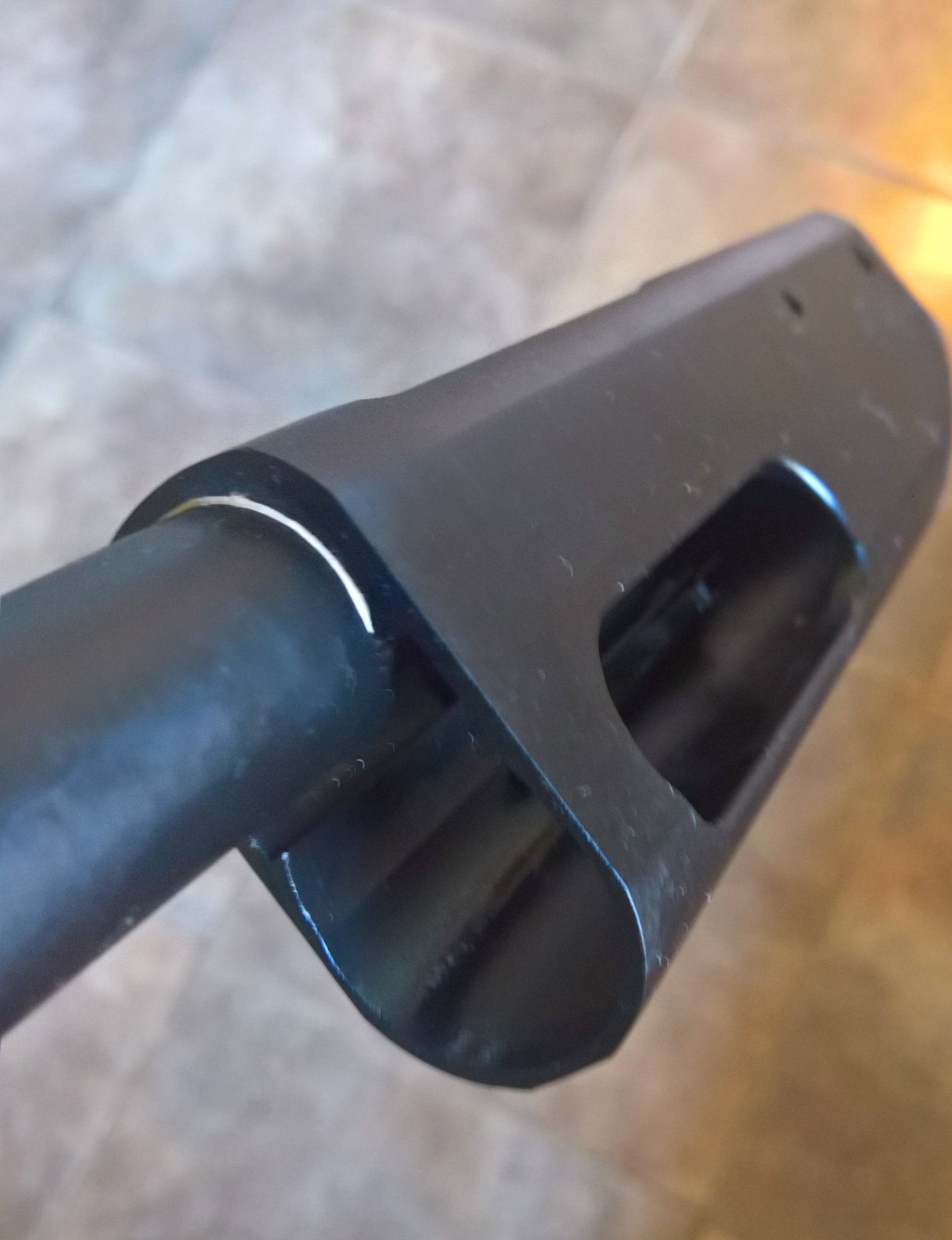

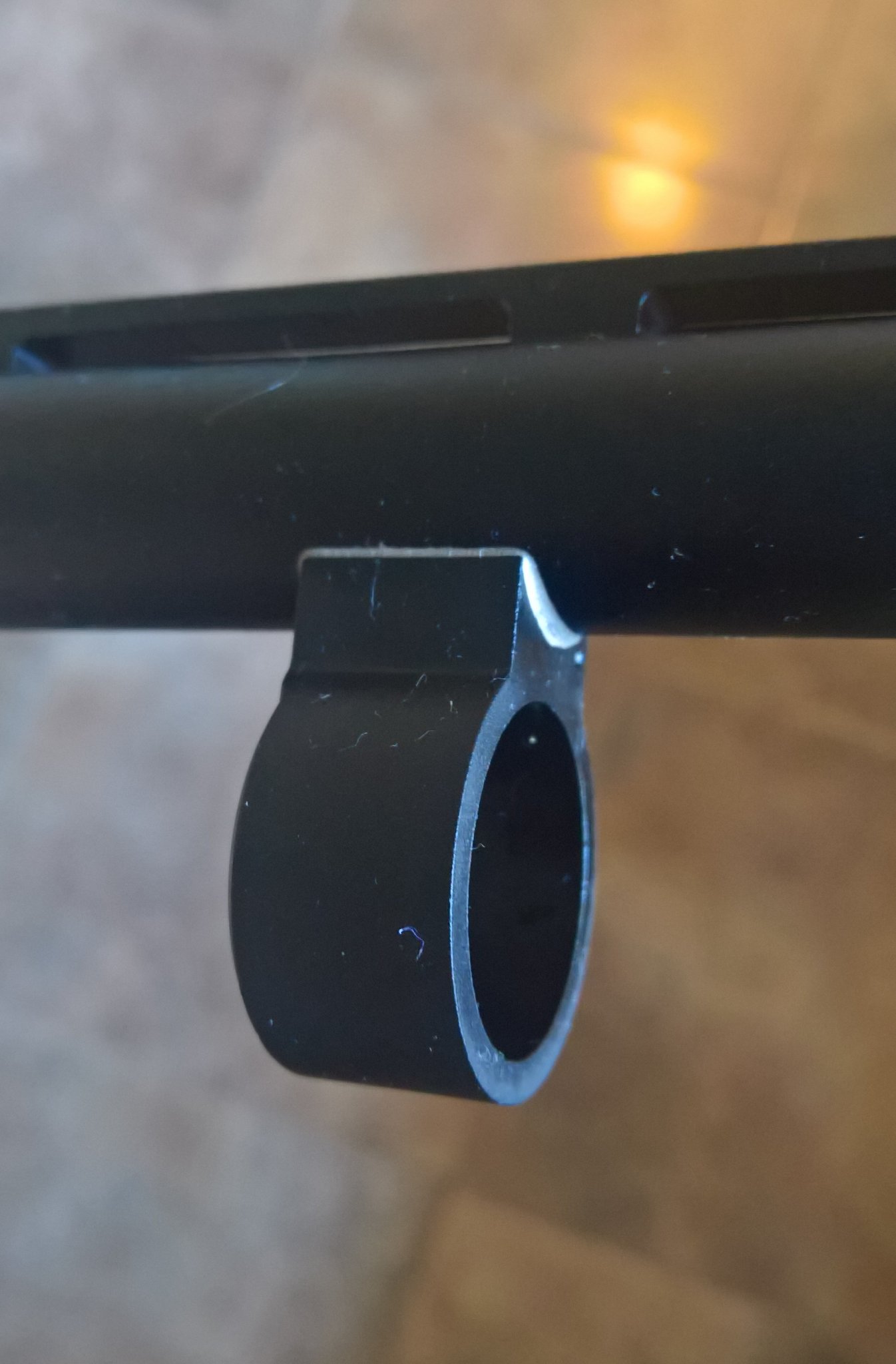

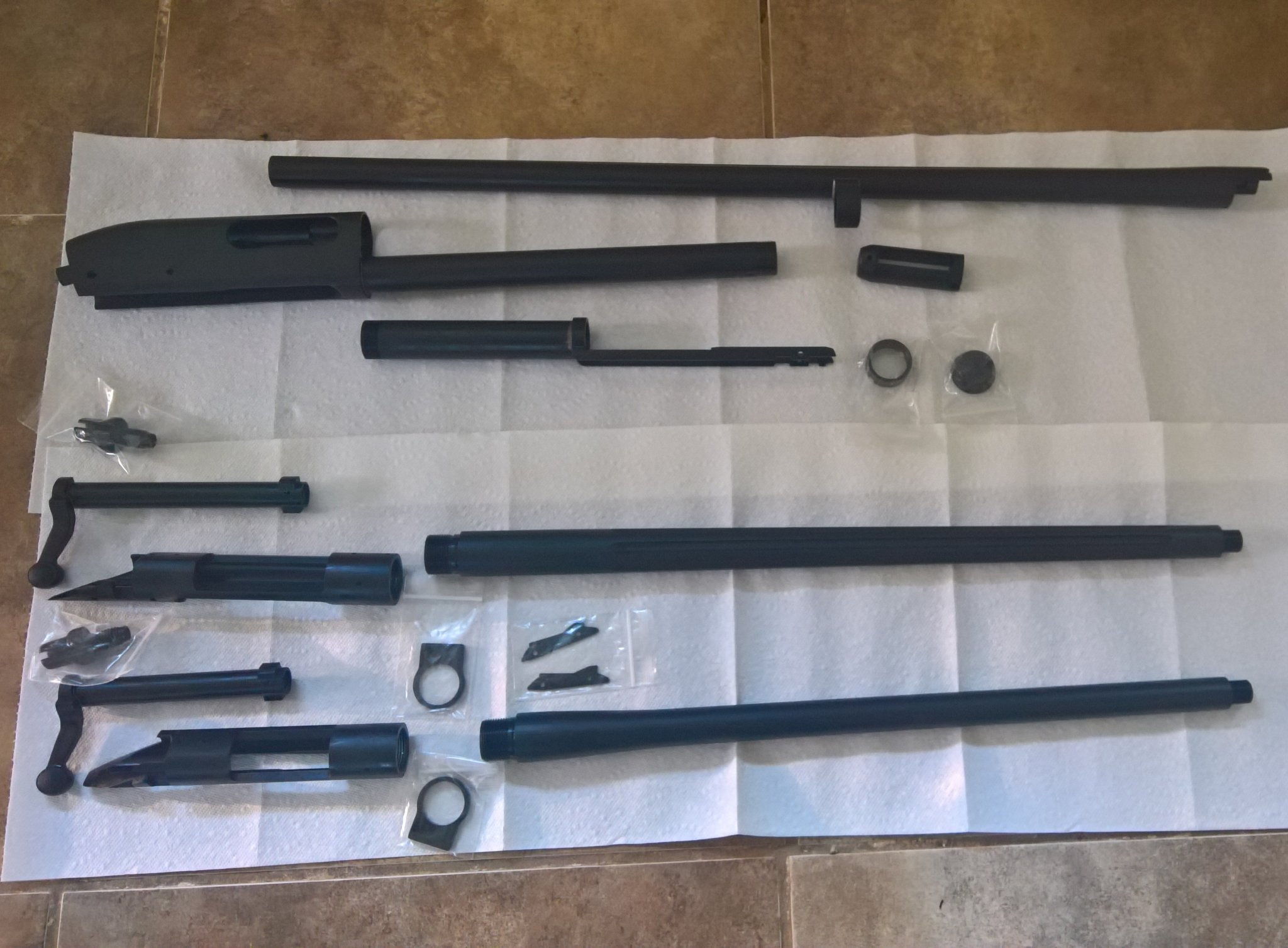

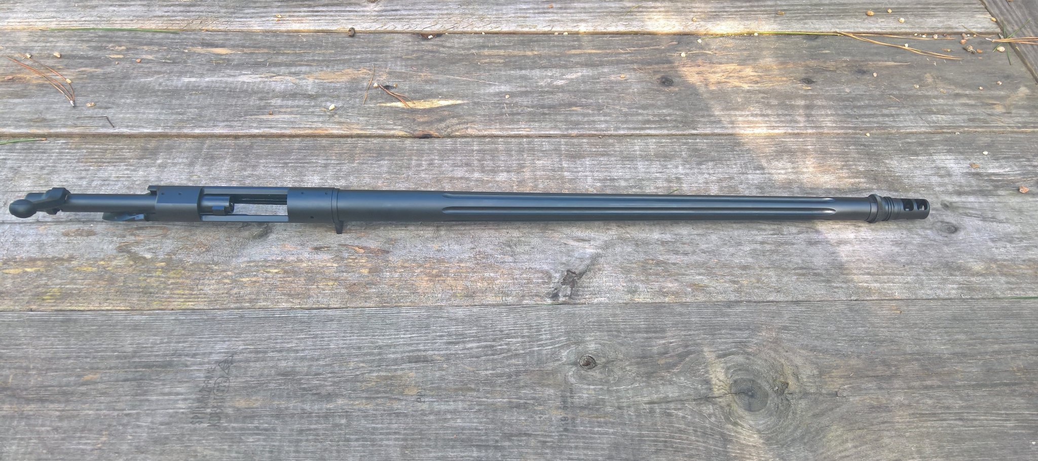

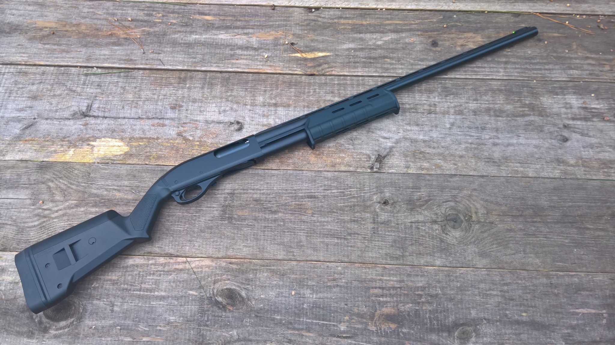

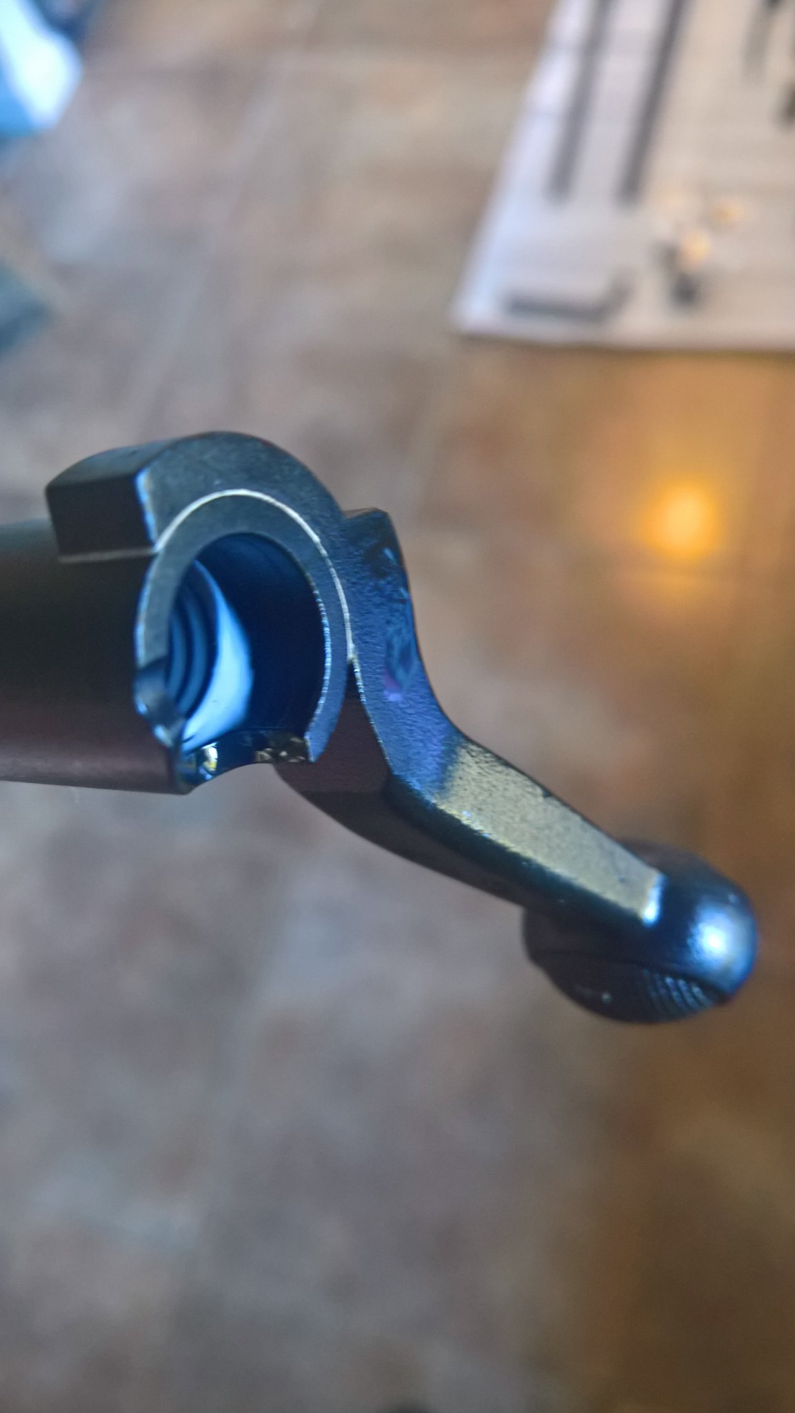

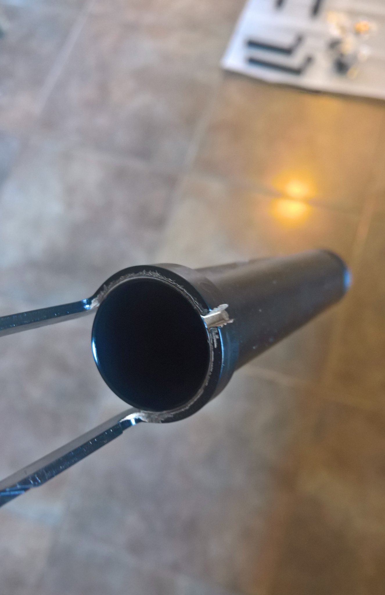

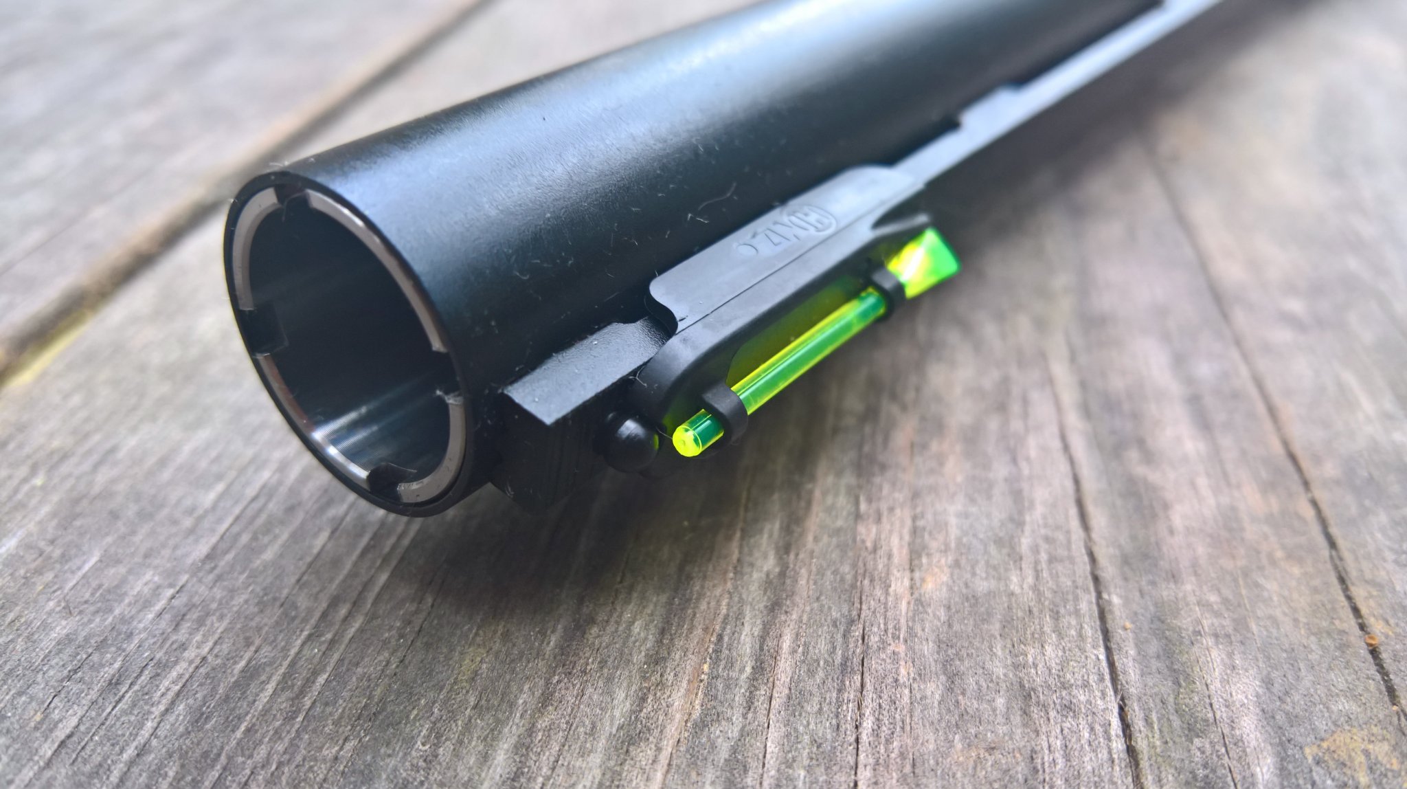

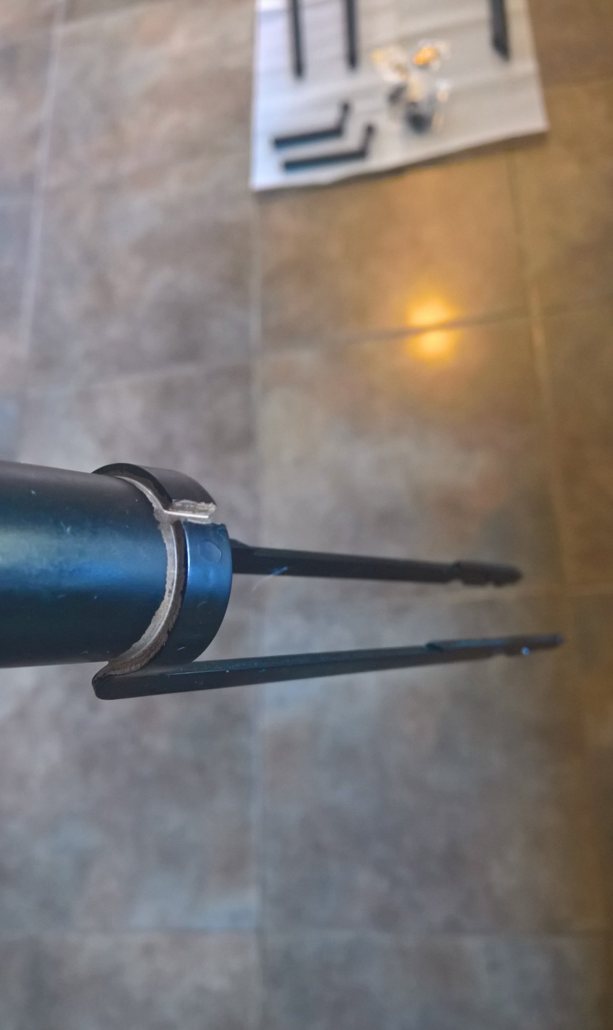

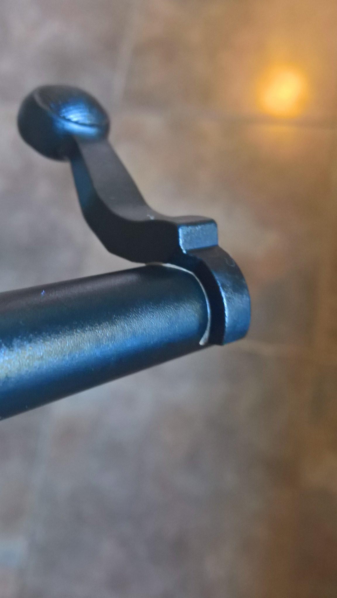

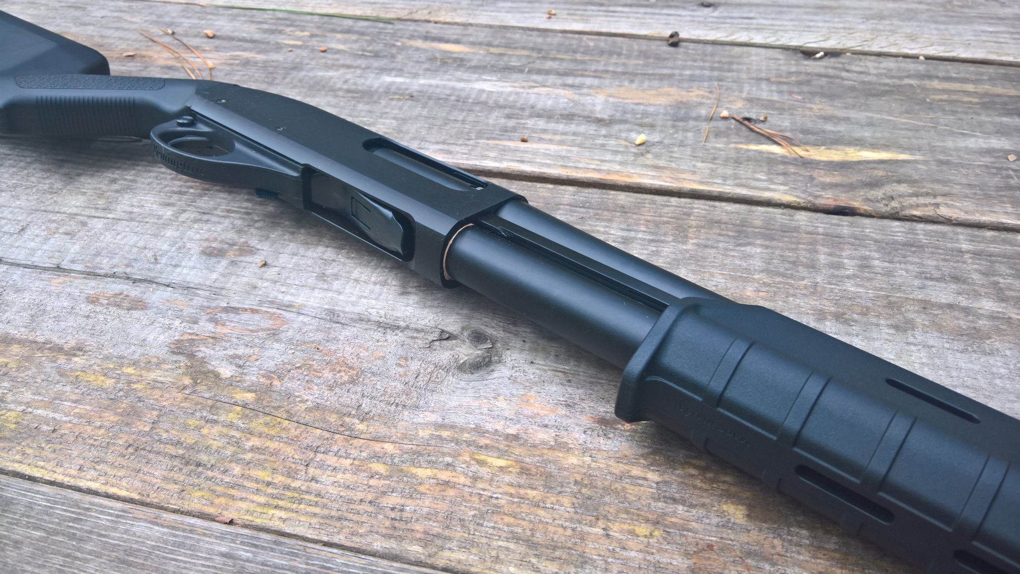

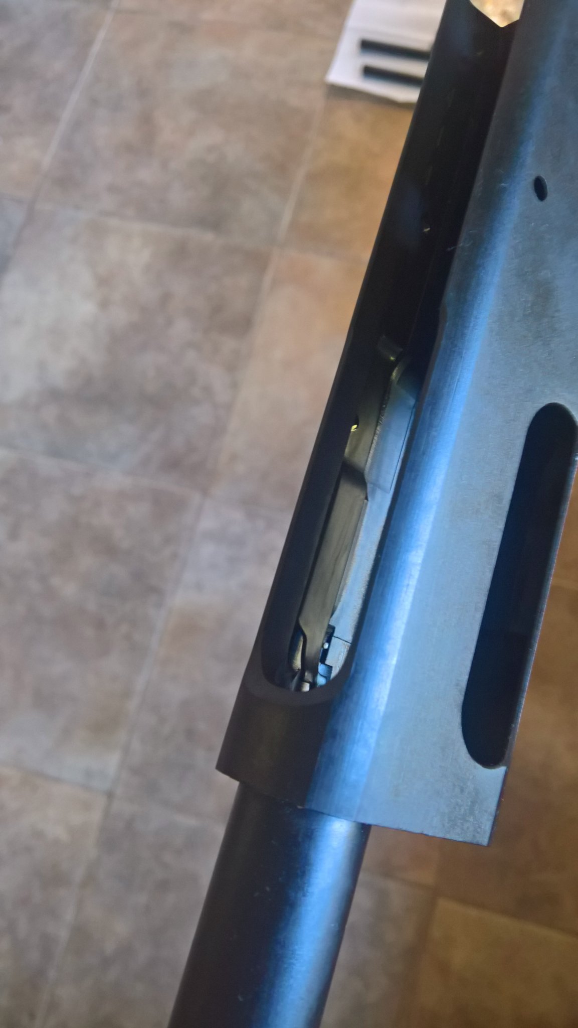

Wanted to share my rem 700's that went through the nitride process. Action, bolt, and barrel. Along with a rem 870. I searched all over for answers on this process and did not come up with anything. All parts were processed at Houston Unlimited in Chapel Hill TX. Rifles still shoot great after process. Only issue with the process is the brazing on the bolt that holds the handle to the body. See pics.

The cost was 150 per batch, one batch processes about 150lbs of parts. So all three firearms only cost me 165 with the disposal fee. The company did all the prep work for the process, all I had to do on my end was break everything down to parts. I would like to add, everything needs to be in pieces. I did not remove the extractors from the 700 bolts or the flat guide/springs pressed into the 870 action. I was warned by doing so may cause a salt crystal growth to form on these areas due to trapped salt. This did happen after a day or two. The rep instructed me to clean with water. I added some CLP when dry and no more salt crystals. Both rifles function great, still need to shoot the 870.
