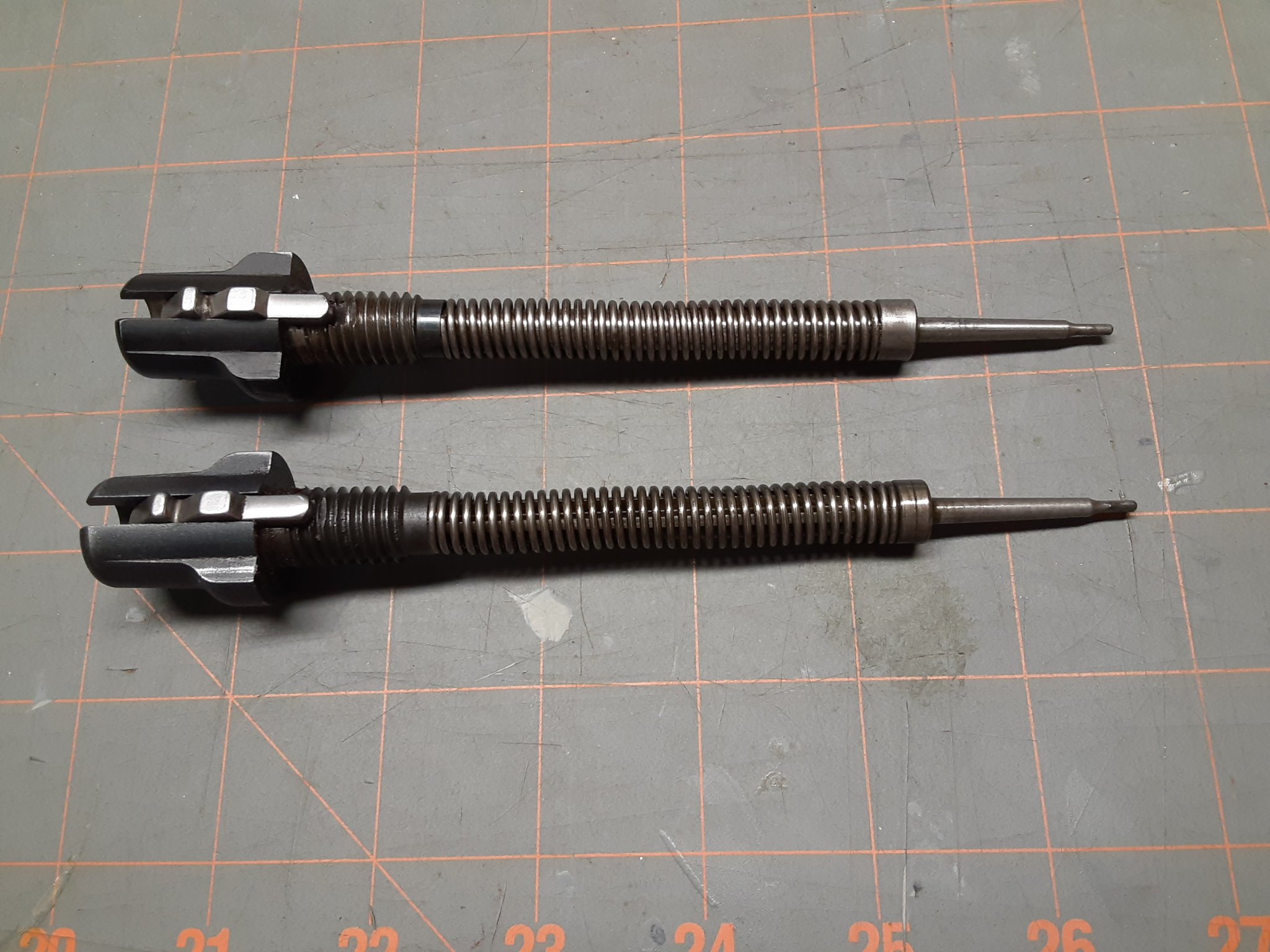

    I ordered two Wolfe springs from Midway - they were $8/each and tool for disassembly.
    Mine don't look bad - but this should be an upgrade. They're not 'snaky' like shown in the Gre Tan video.
    View attachment 7346197View attachment 7346197
    Your springs don’t look that bad. The firing pin in the bottom of the pic looks different. It looks like 2 pieces of metal just after the spring. It may be separating and causing you problems. If the lower assembly is the one that had problems I’d get a new firing pin too.
