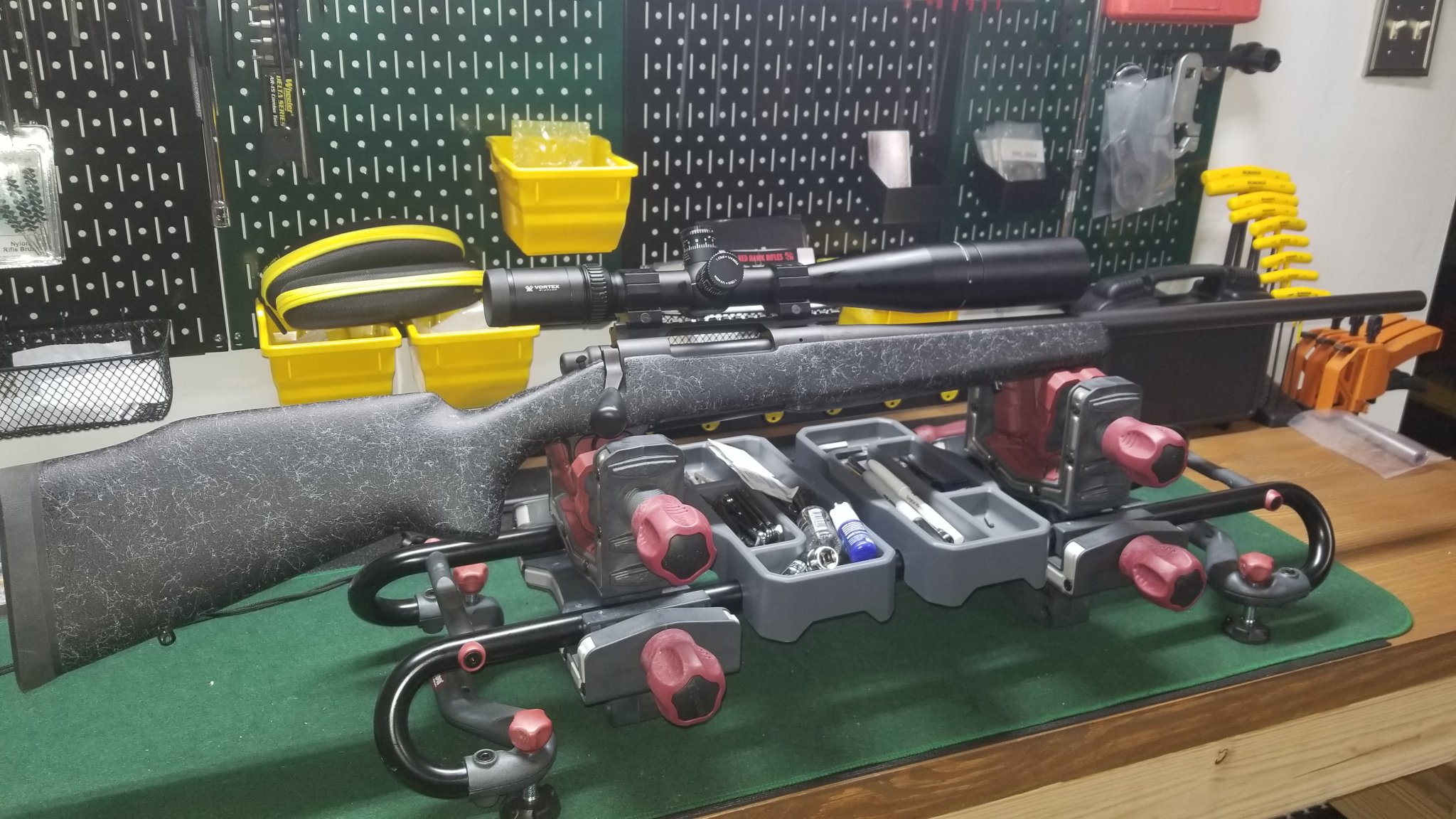

I too have the Remington 700 Long Range chambered in 30.06. I picked the rifle up for $695 from Grabagun. After adding scope, base, rings and bi-pod, I have well over $1700 in my rifle, so you did good for $1000! Any pics of the new-to-you rifle?
Pictures of this beast please!
30-06 great caliber.
Thinking I need a accuracy built rifle in 30-06 than I remember Ive been waiting almost a year for one I have been waiting on since 2017.......
Mine in 30.06. Note, the cheek riser is no longer mounted to the stock, and I have since swapped out the bolt knob:
