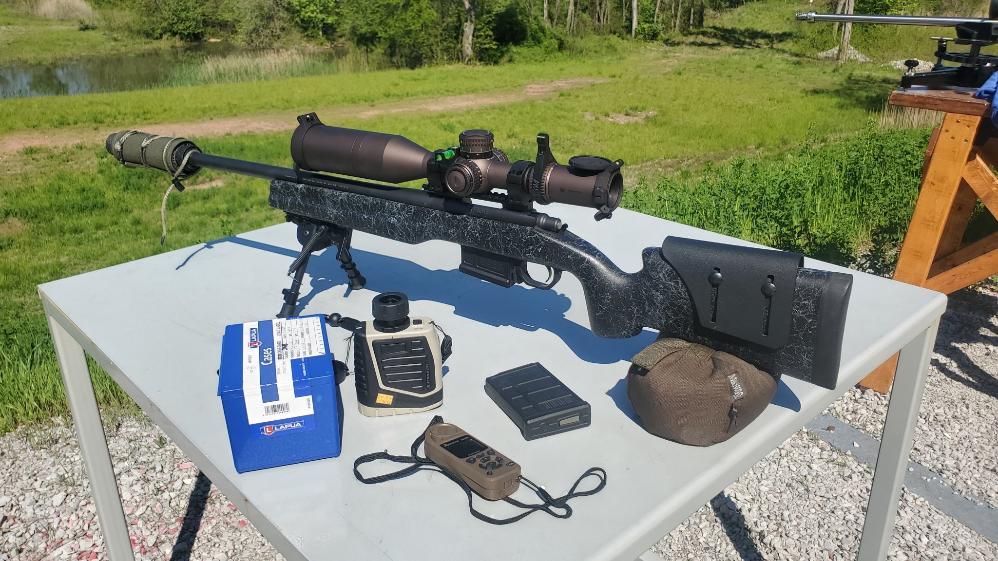

Where does everyone send their rem 700 to get rebarreled? Finally shot the barrel out of my 700 tac. Need a new barrel and going to go a bit longer this time. Thanks.
