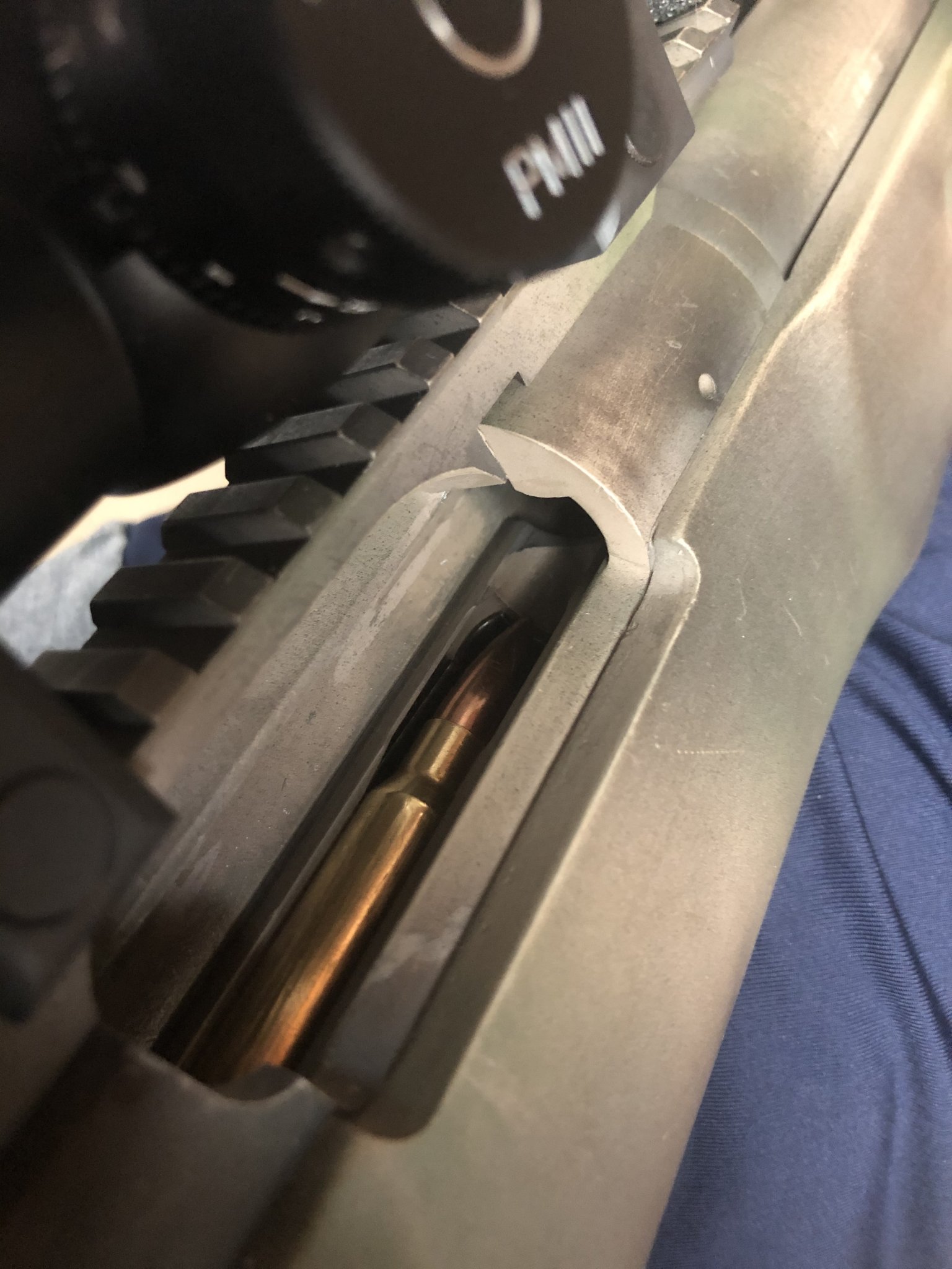

Relevant to see bullet tip / feed ramp relationship.
okay, not the actual other side of the receiver but inside the receiver towards the feed ramp, that makes more sense. This is the only picture that I have showing that angle
Looks like the bolt is just riding over because the cartridge base isn't sitting high enough. Open the feed lips slightly.
That’s what I had thought originally as well and opened them slightly but it didn’t change anything as I had hoped it would. It’s probably not the case, but, since all the “usual” fixes aren’t working, I’m starting to wonder now if maybe the inlet for the bottom metal might be slightly out of spec. I’m not sure how I’d be able to tell that though
Open them farther. Tweaking magazines is a case of just a little bit until it works and leave it alone.
What may be the case is the reciever is undersized pinching the magazine together tight enough that it's not letting cartridges up far enough. Could also be the distance between the magazine well and the bolt is too far to feed.
The fix to either one is presenting the cartridge high enough for the bolt to catch the rim.

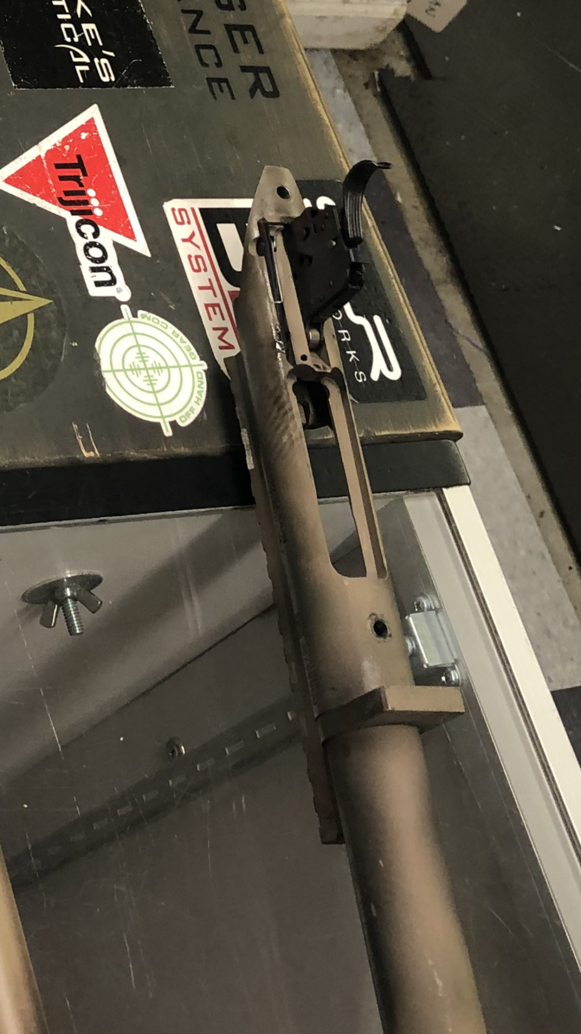

I’m still waiting on an update from the builder to see if he’s made any progress diagnosing/fixing my feeding issue. I found this picture of the underside of the receiver rails in case that gives anyone any new ideas as to what may be the root cause of the issue.
How can he open up the feed lips?
The feed lips are integrally machined into the receiver and unlike DBM systems that control the cartridge with the mag box, a BDL feed systems rely on these machined tabs to help control the cartridge path.
The issue is with the follower and spring not pushing the cartridge stack firmly into the integral feed lips of the receiver.
This will be corrected without touching those feed lips or modifying the floating mag box as long as it is the correct mag box for the cartridge. (BDL feed systems for 223 and WSM/SAUM use a different box than .308 class cartridges.
