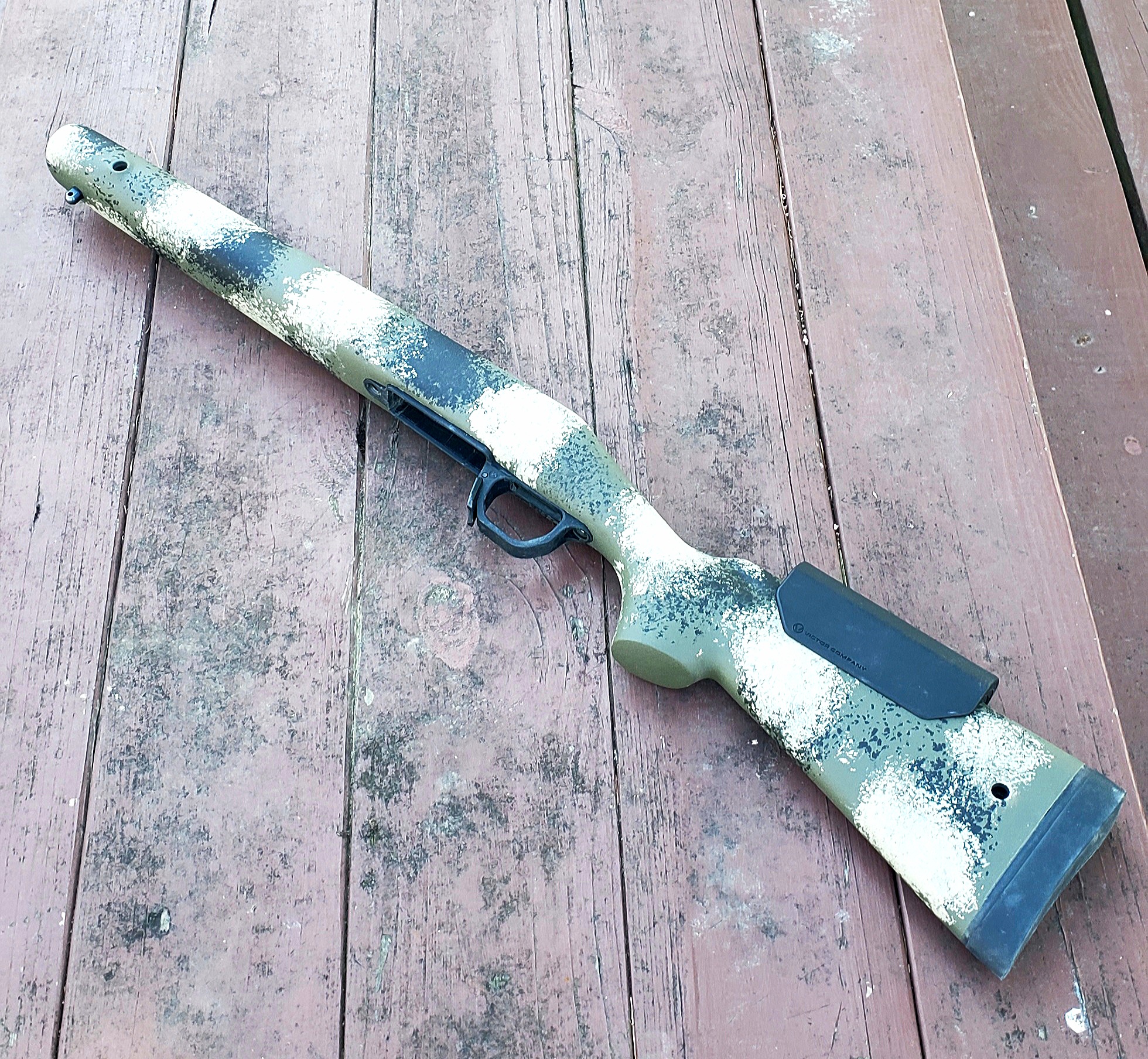

This stock came on a police trade in, I was told it is a McMillan. Can anyone confirm make/model? I also emailed McMillan about this and will update if I get a response. Couldn't find anything on the web about this particular stock, but I'm a lot better versed on pistols and semi-auto rifles.

It's a Mcmillan Baker Special. From the looks of it you have a good base rifle and certainly ungradable after you figure out what you need. Check out the BT pic rails, the BT-17 or BT-15, they should bolt to your stock using the existing t-nut spacing. Drop on a Badger Ordnance base and you'll have a pretty nice old school set up.

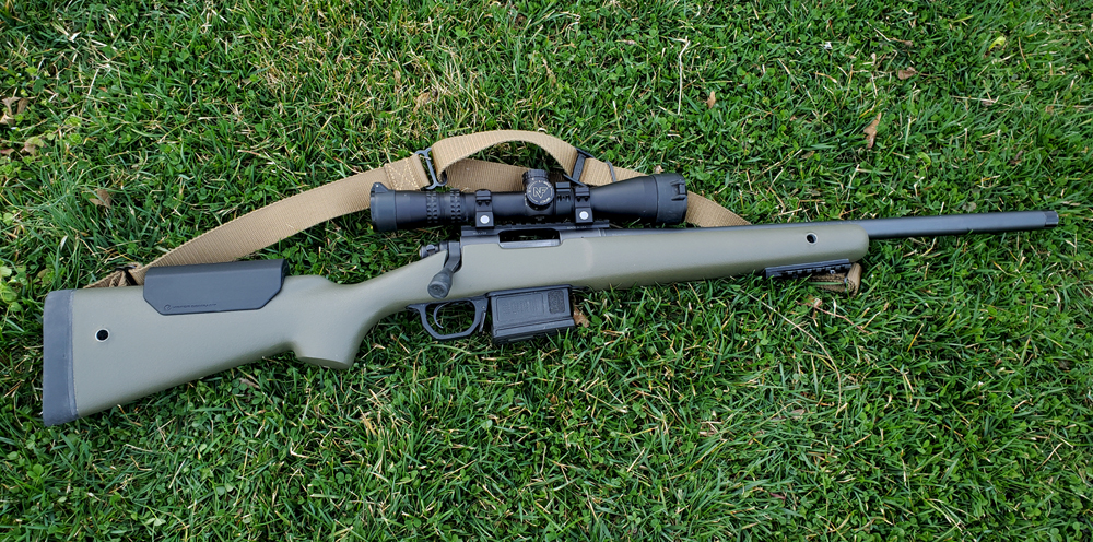

HS Precision makes a detachable box magazine system that will drop into that BDL inlet but the magazines are proprietary and expensive compared to AICS mags.
If you're handy with tools you can modify a Magpul Hunter DBM and do a little inletting on the stock and it will work with the pillar depth of the BDL set up. I did that a while back with a clapped out HS Precision stock that was inletted for a BDL floorplate. It required a little sanding around the magwell area in the stock and mostly modifying the polymer bottom metal but it came well and worked just fine.

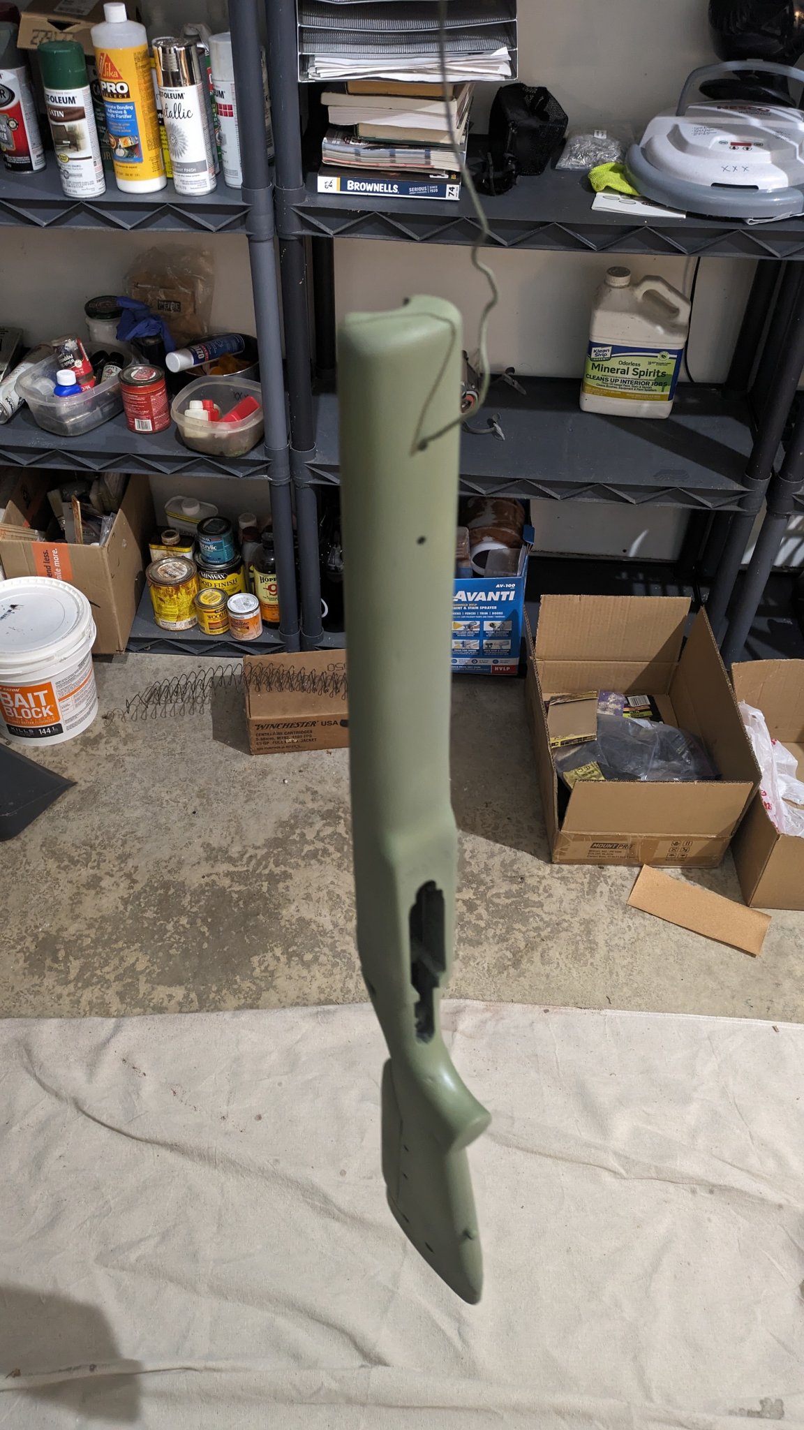

Here's the progress I've made so far:
* Acquired rail with 2 inch hole spacing and sling swivel. Seekins Precision SRS Rail,HS Precision 2.0in Hole Spacing (Amazon, I'm lazy)
* acquired t nuts from Ace hardware. $2.99
* 2 base coats of self etching primer (what I had)
* 2 base coats of restoleum ultra flat army green (what I had)
Essentially I gave up on making it look like the McMillan or Gaprecison examples. This one is going to be totally rattle can custom like only in Illinois redneck can do!

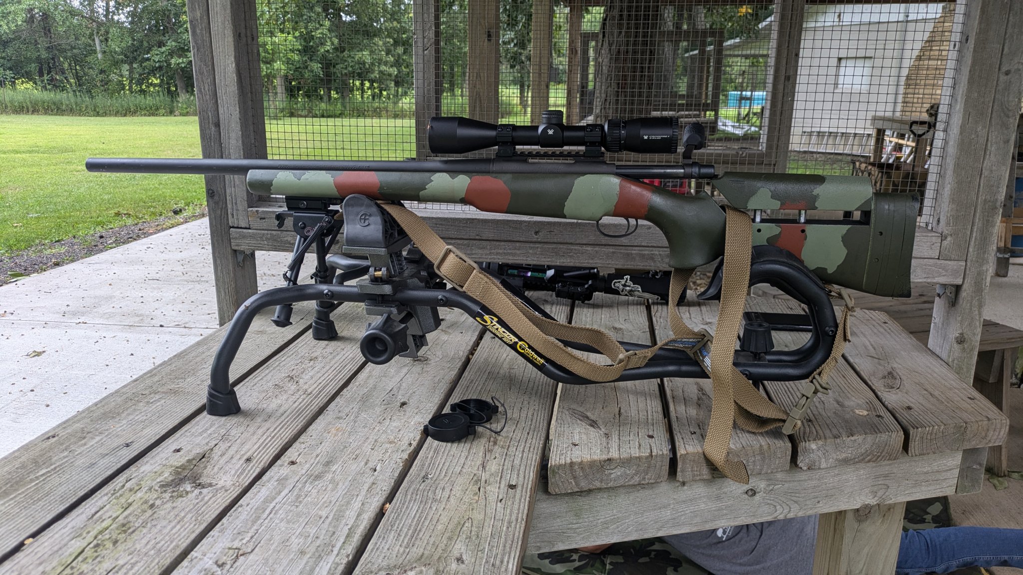

The old school woodland camo does look good. This is "JB" after I'd given it a OD spritz shortly after I got it done
This was after I gave it a GAP Camo sponge job with some off brand flat OD, bargin bin flat black, and Krylon Camo Khaki that I had under the bench with some sponges from Walmart's craft section.

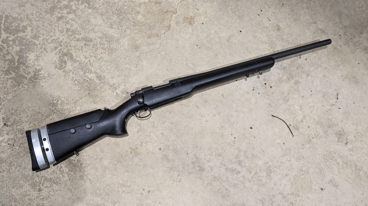

Finally got around to shooting the 700. She's a tack driver. Boringly accurate with factory ammo. But there are several issues.
With aguila 308, I'm getting about a 30% failure to fire. Not sure if it's hard primers or a bad firing pin. The hammer fall sounds kind of anemic. I put a triggertech two stage in and the dry fire sounds more forceful so that may fix it.
Also, the 3-9 scope I put on it is bottomed out to the left so I can't adjust it far enough to zero. I ordered a 20 MOA pic rail and we'll see if that gives me some more room to work with. Otherwise I may need to shim it somehow.
The last thing is that the bolt rear is bottoming out on the cheek piece so I may need to file that back.
Still contemplating what to do about detachable magazines. I might order the magpul one and see if I can redneck it in there. Once I get everything sorted I think this will be one of the nicest firearms that I own and as I mentioned it is definitely the most accurate.
