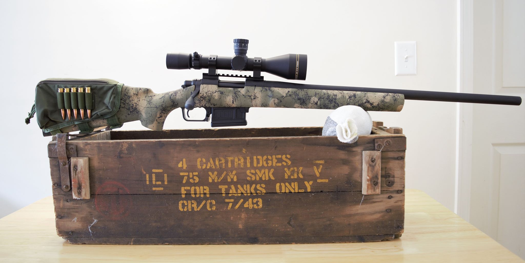

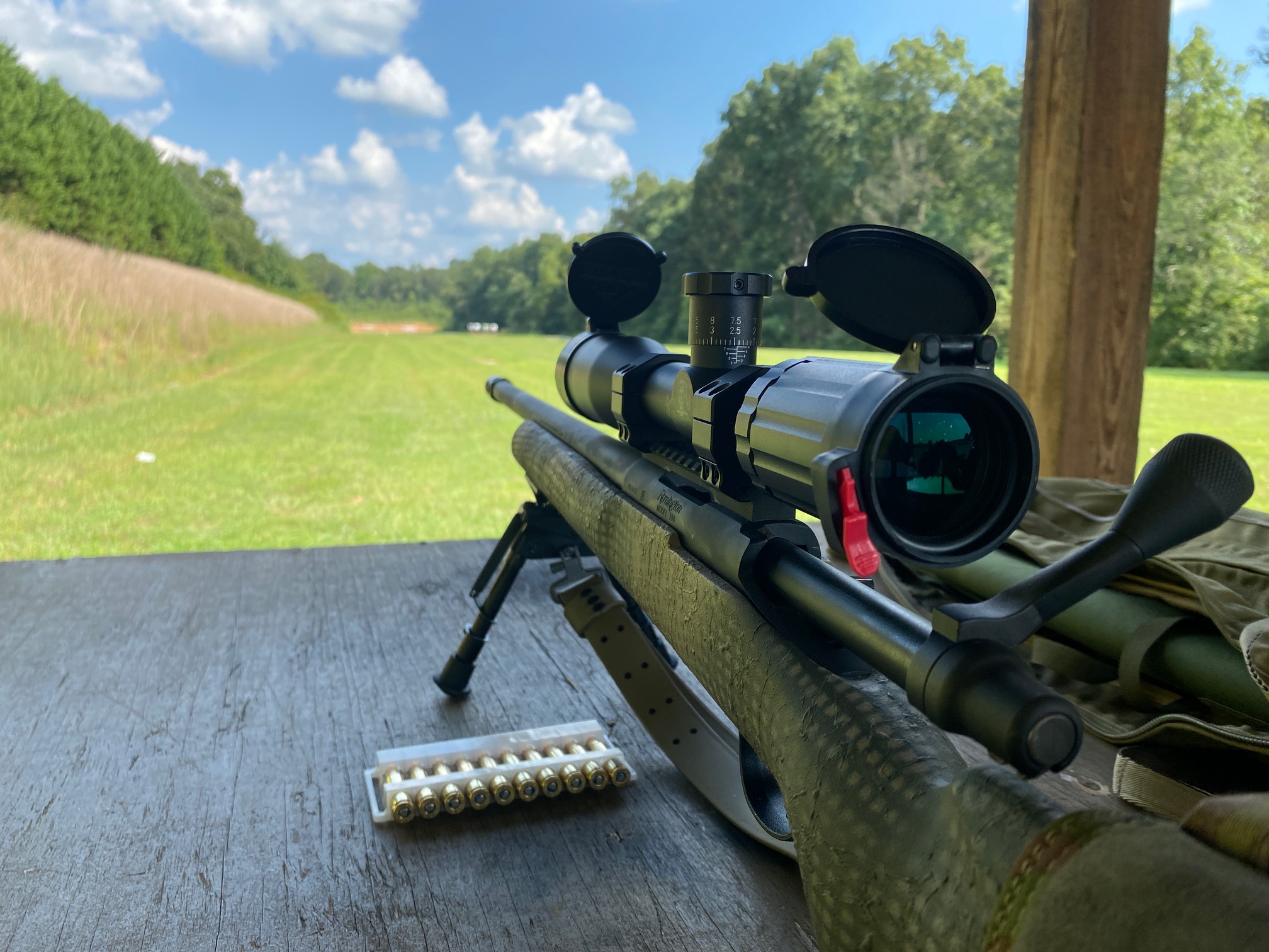

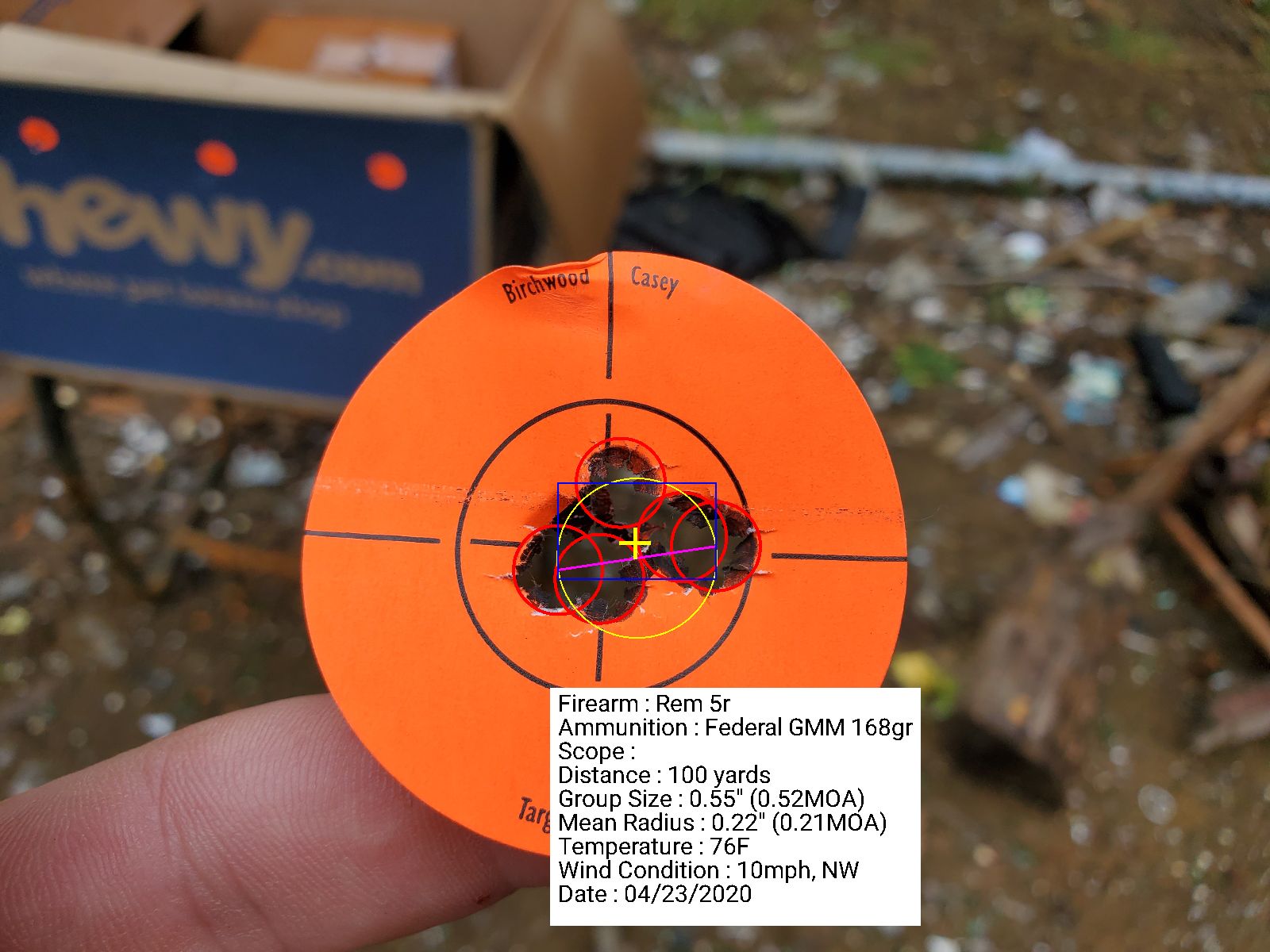

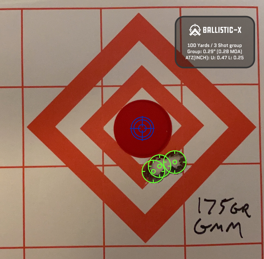

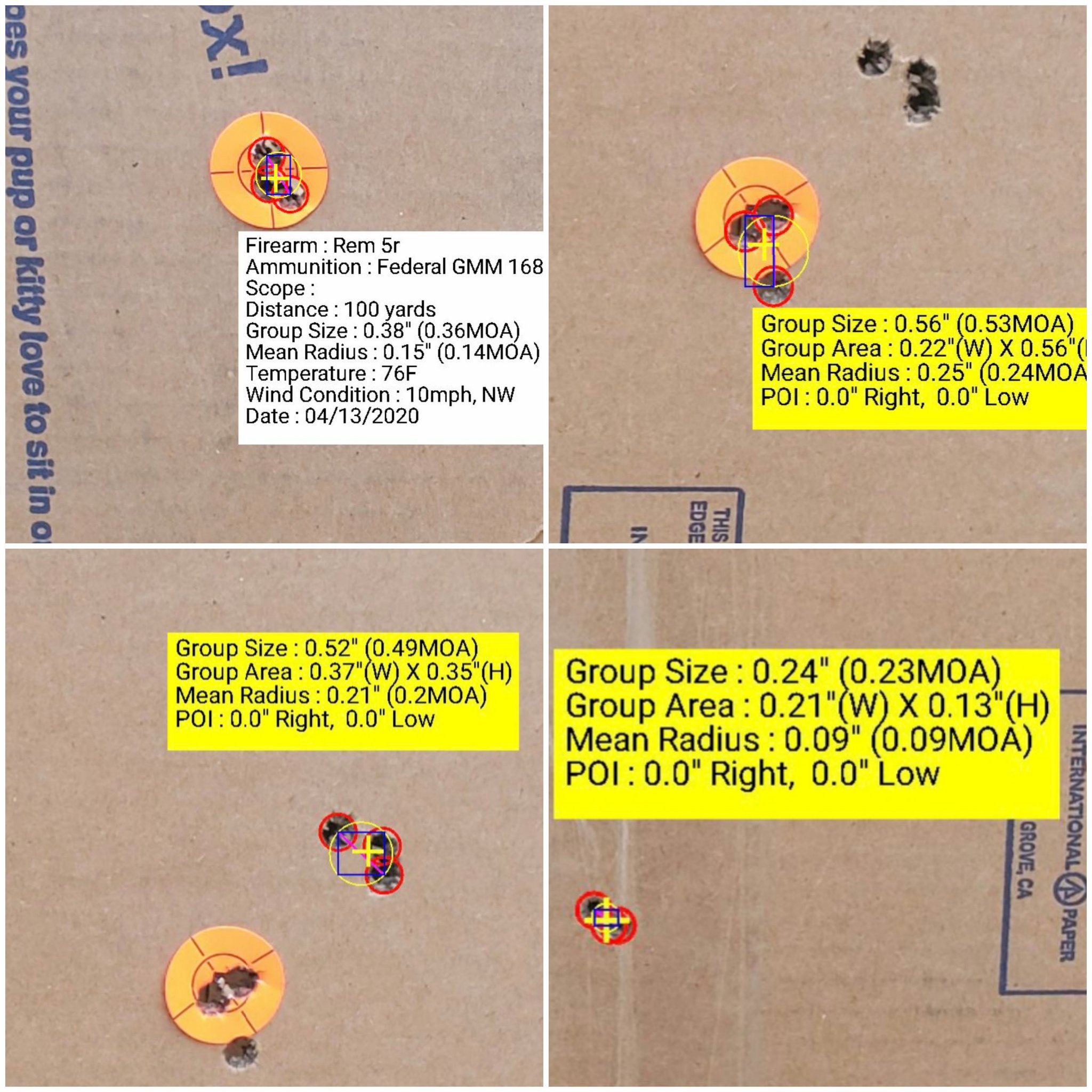

I have had good luck with my 2 5r's. I started with a 24" that my friend wanted so I sold it to him. I have a 20" now and it shoots 1/4-1/2" depending on how well I can manage the heavy factory trigger.

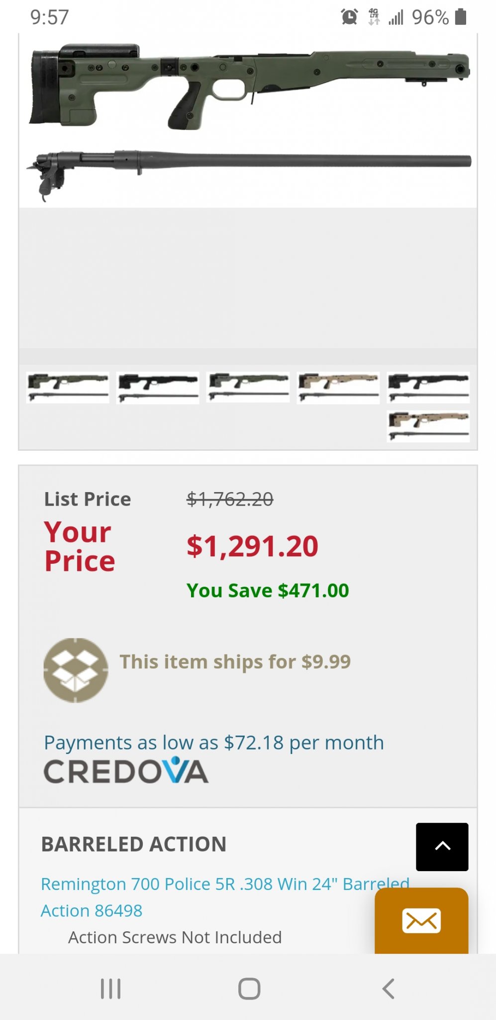

Just get this then if you dont like the HS stock, BTW says its a 5R👌its kinda like your buying the 700P 5R action for $300🤷‍♂️
-Reagan
-Reagan
This kit was actually my original plan, amazing deal, but I'm trying to keep the budget under $1K.
I actually do like the HS stock, I find it to be very comfortable, it's a classic for sure. Arms Unlimited has the non-5R 700P w/ HS stock for $750, just trying to decide if I should see 5R as a deal breaker or not....
Thats a good price at $750, we have a few stores down here with 700p 308 5R's in stock, but they are like in the $875-910 price range.
-Reagan
Just noticed that Remington's website is showing that product # 86672, which is what Arms Unlimited has, is actually a 5R 1:10 barrel.... So I guess the only difference between it and the eurooptic kits would be the twist rate....
Am I interpreting this right?

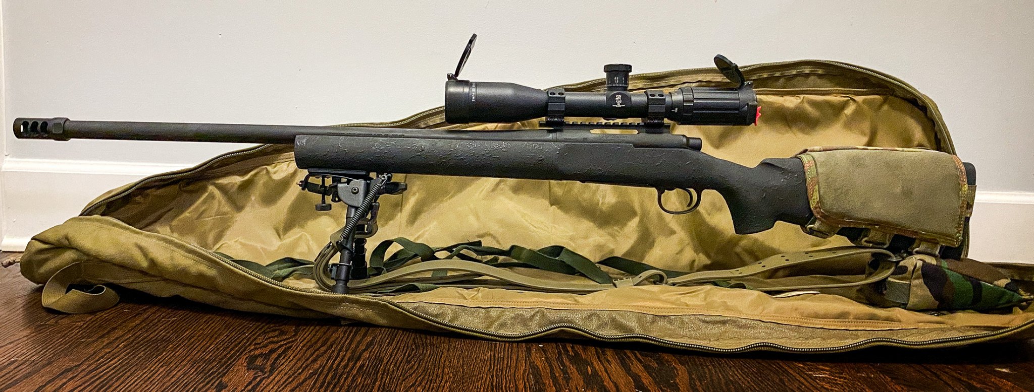

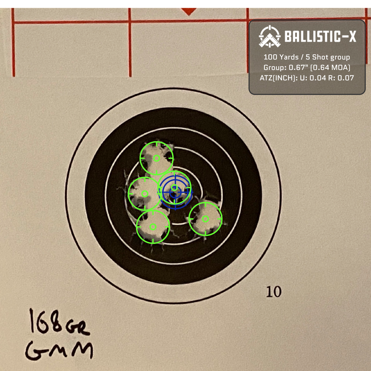

I have a older 700p in 308 with the 1-12 twist and it shoots the 175 smk really good. Just pick one there won't be much of a difference in accuracy between those two. I would plan on changing out the trigger though as the x-mark didn't impress.
Reactions: AN22
700Ps that Ive seen all have the 40x trigger.

Received the rifle today, can't wait to get it to the range. Was surprised to see the bolt already had a tactical style knob, and the receiver was drilled for #8-40 screws. Have a Harris S-BRM on the way for it, and looking at a Badger rail. Fit and finish all seem to be great, we'll see how it shoots when it's all put together....
Went that route on my last build. Lugs make great contact. Finish is meh. Haven't really had anytime to play with it due to graduating soon but accuracy seem good. I dropped it into a used HS stock that fell off the apartments balcony and broke the butt pad and a corner out of the stock. H&S repaired and I had it repainted.
I've had it out once since putting it together. I couldn't zero the scope due to user error and the barrel made contact with the forearm of the stock so I really don't have a judgement on accuracy yet. Seemed ok for all my issues. Will give actual results once the thesis calms down.

The 700P has been outfitted with a SWFA 10x42, Seekins rings, Badger 20 MOA rail, Harris SBRM, APA Lil B brake, Triad stock pack, and a Turner sling.

Finally got my 700P to the range today, and it did not disappoint. I'm a fairly novice shooter and I was consistently getting sub-MOA groups at 100 yards and 200 yards. And 1 MOA at 300 and 400 yards, probably just due to my lack of skill on those. Shooting steel silhouettes at 400 yards was too easy.
Ran a bunch of M118LR, 175 GMM, and 168 GMM through it. Honestly all 3 performed equally.
Attached are two of the best groupings. A 3 round group of 175 GMM and a 5 round group of 168 GMM.
