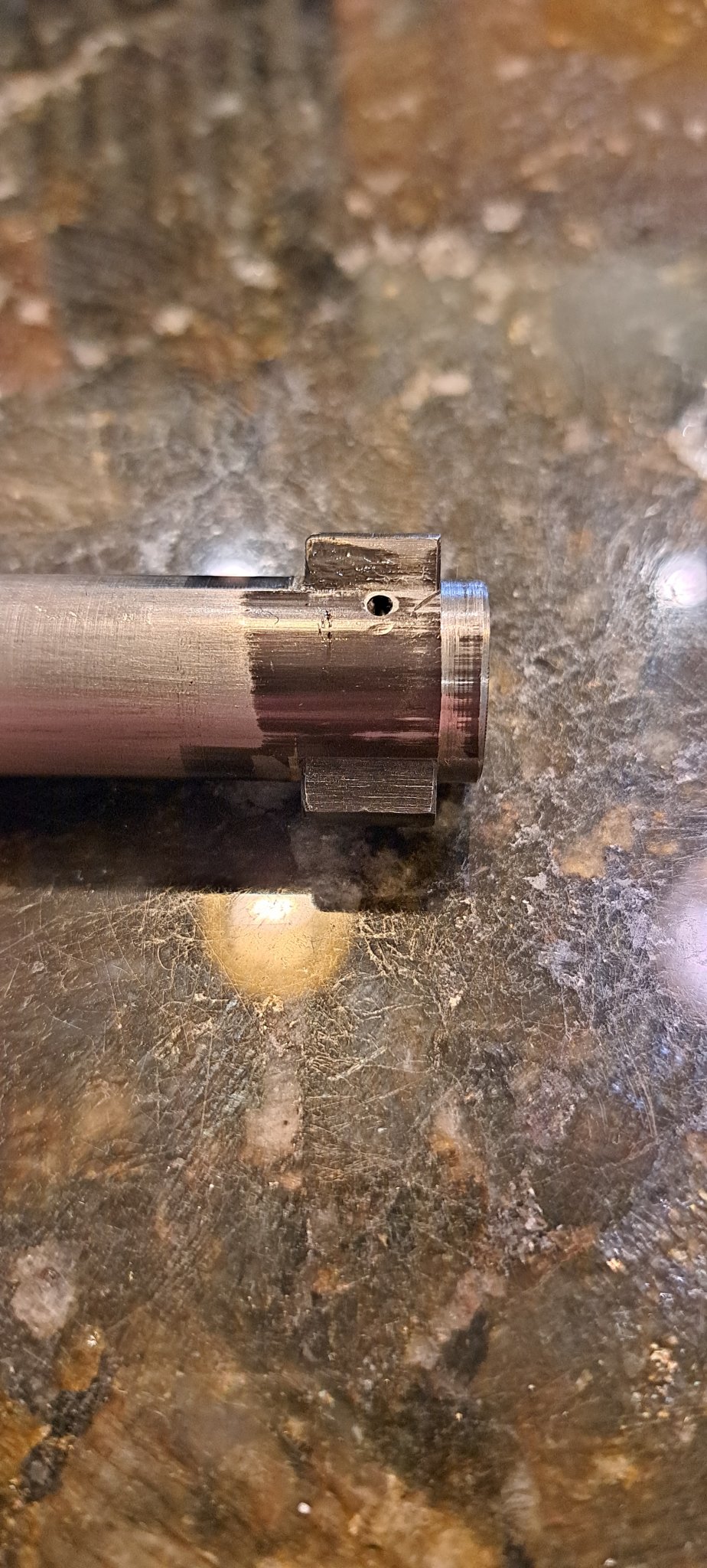

I recently purchased a REM 700 in .223, mainly because I wanted the Steiner P4Xi optic that was mounted on it. I am an 07FFL and have been smithing the REM700 for many years. When I disassembled the rifle when it upon arrival, I found several things that were unusual to me. The barrel is a heavy MTU profile, 24 inches long with a very aggressive crown-maybe 30 degrees. The bolt face has an insert and the firing pin has been turned down to .062". The mod that I have not seen before is the bolt body forward of the locking lugs has been turned down to .670". The counterbore in the barrel fits it snuggly. Is this a common modification in the F-T/R world? I suspect that the barreled action was an F-Class project that either lost funding or ended up in a trust. The workmanship on it is fantastic but the rest of the rifle was junk parts. The headspace checks out so I put it in an XLR chassis and am taking it to the range today. Any info on the .670" turndown will be appreciated. THANKS and Happy Easter!!

You're thinking of a coned breech. Turning the bolt nose down is simply part of the truing process, and not much material is actually taken off. Notice in the photo that is not a 100% cleanup pass.
