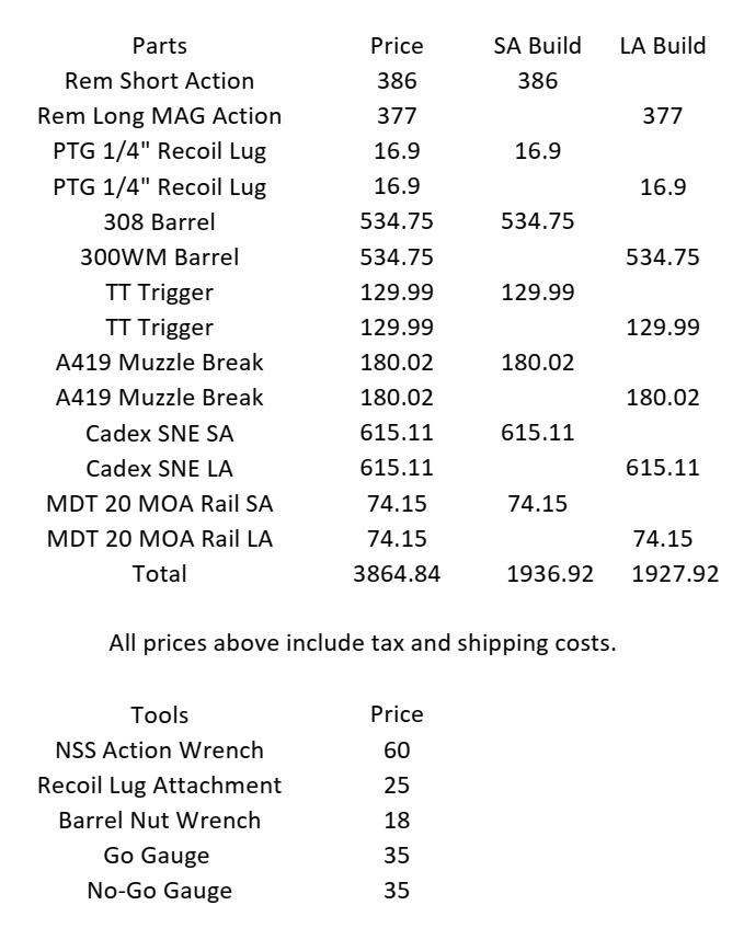

I am looking to put together a 308 rifle on a budget. I've got a KRG chassis already. I am thinking of doing a REMAGE build.
My question is for those who have done one a bone stock R700 action.
Good idea or waste of money? Can it be done with good accuracy results or does the action need some work prior to assembly?

"Needs done" was probably not the perfect terminology. If I was going to do something, that is what it would be, if it needs it. An RR action wont have any, a lot of older actions will have plenty primary extraction.

That's my thought process. If I can take a bone stock R700 action and screw on a solid, high quality barrel and get accuracy greater than a R700 SPS, then I consider it a win. I would't have any work done on a 700 action. The Origin makes far better sense at that point.

Nothing yet. I've only got the KRG chassis now. I think I can get a 700 action and have the bolt knob threaded for around 650.

I just built two Remages, a 308 Win and 300 Win Mag on stock actions with Trigger Tec triggers and Preferred Barrel Blanks Remage barrels. Both shoot .75 MOA and better when I do my part. Total cost to build both was not that bad, below is what I paid, and it took me over a year, and I waited for stuff to go on sale. Also, the only thing I did to the actions is lap the bolt lugs to make sure I have at least 50% contact with the receiver, which both were over 90%.
Now as most said, I would not spend more than 350$ for the action itself since you can get a Howa Barreld action for 450$ to 500$ and get a more feature/updated action that is a bit better. Though going the Howa or Tikka route, you would lose the Remingtion footprint and being able to swap parts, like actions and stocks/chassis.
If you do go the aftermarket action route, most of them have prefit-barrel support, as well as Tikka and Howa now. So, you should not have an issue finding a barrel, just the time to get it...meh
