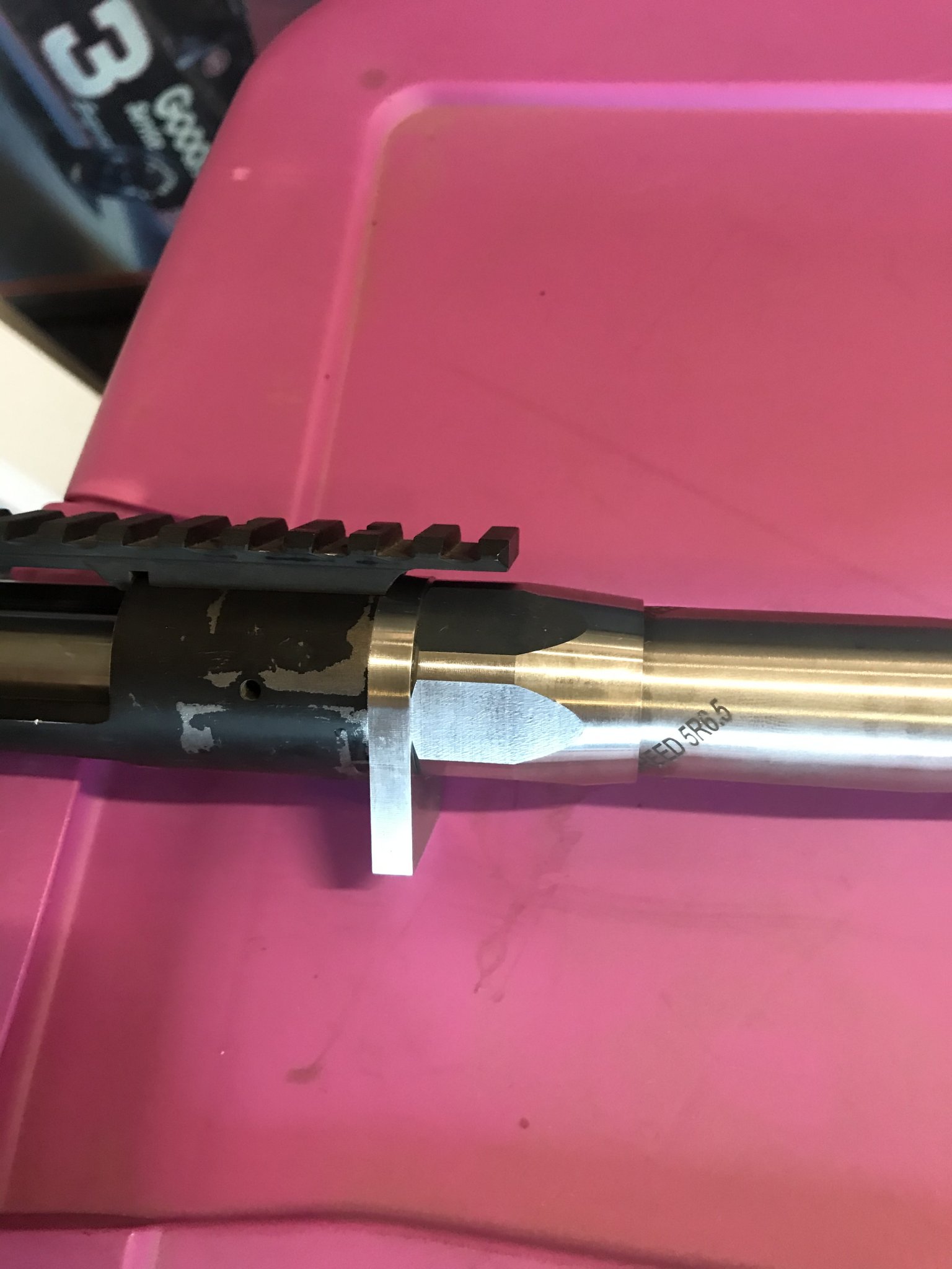

With Corona Fun Bucks coming, I figure its a good time to order a Remage barrel to have on standby for later. Vanity being what it is, I think the savage nut on a 700 looks bad... What other options are worth looking? I see that Zermatt has a smooth nut, would that be way to go on a 700?
I am running a Oregon mountain rifle barrel nut with pure precision recoil lug on a 22 creed I liked how this one looked the best. Need to Cerakote it all now.
