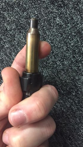

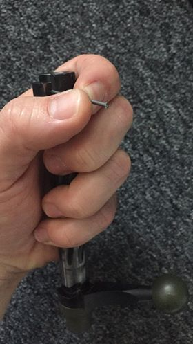

If your changing barrels like tires in a circle track race, one workaround to help expedite is to simply grind a clearance notch into the head of the gauge. Certain companies years ago used to do this pretty routinely and they worked fine. I would still make the effort to remove the fire control out of the bolt before doing it this way.

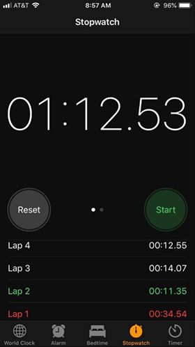

My cousin was complaining about having to do it so I timed myself removing the plunger
"34 seconds to walk to the jeep and get the hammer out and walk back in the door, 11 seconds to grab a nail out of the box, 14 seconds to walk over and take the bolt out of the rifle, 12 seconds and the ejector is out and everything is set down and I stop the phone."
Just dont pull the punch or nail out until you have your finger covering the spring loaded ejector so it doesnt fly out.
To reinstall its basically the same thing, start the pin in first with some gentle taps so it holds itself in position before you insert the spring and ejector to make it easy on yourself.
"2 minutes 10 seconds to put it back in and put the hammer up, that includes 20 seconds looking for the nail I dropped on the carpet"
Hook a case under the extractor and rock it over to depress the plunger when you send the pin all the way in. Make sure you have the scallop in the ejector facing the right way so that it makes room for the cross pin.
Thank you for help and yes id rather remove it before grinding lol
My cousin was complaining about it so I timed myself removing the plunger
To reinstall its basically the same thing, start the pin in first before you insert the spring and ejector to make it easy on yourself.
"2 minutes 10 seconds to put it back in and put the hammer up, that includes 20 seconds looking for the nail i dropped on the carpet"
