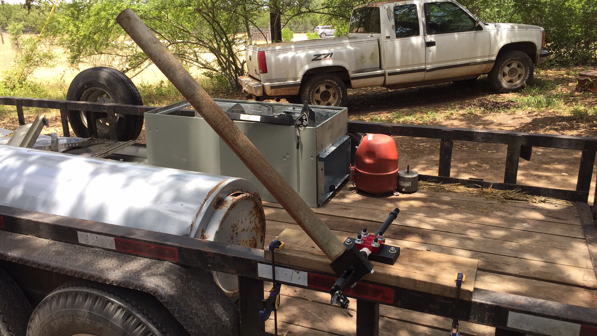

Mine just took a big breaker bar (3” pipe 4’ long) over the nss action wrench handle though. Came off easy like that.

3' breaker bar almost twisted an action that wouldnt bust threads loose for me. Soaking, heat, etc. Noda.. this was with a SAC vise. Relief cut is your friend.. better than trashing your receiver
