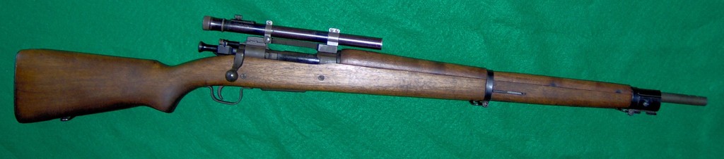

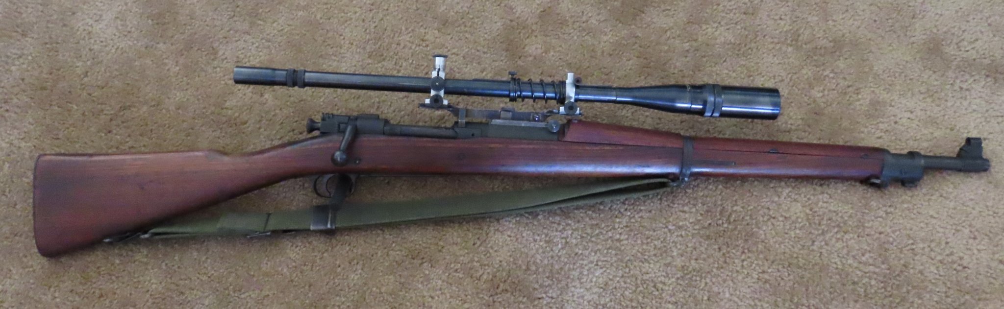

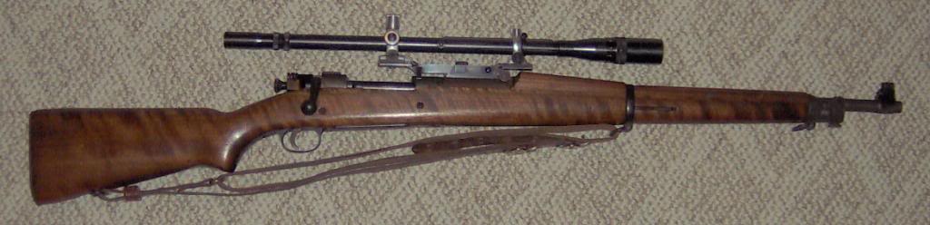

    These are a couple of my Remington 1903's. Not real sniper rifles, just clean 03's with Belding & Mull scope mounts and Unterl scopes. The rifle in the C stock in only marginally accurate (about 1.5" at 100 yards), the rifle in the straight grip stock is a hammer (usually cloverleafs at 100 yards).

    I LOVE seeing Unertl Sniper clones built with straight stocks. When I first started to get into the Unertl Snipers that was so taboo. I love that thought process has changed and you never see anyone mention they were all built on C's anymore.
    With that being said where did you get the Belding & Mull scope mounts ? Some here might not know what they are.
    They were a mount to put a scope on a M1903 that didn't require any modification. You remove the rear sight and they install there.
    I think they did make a few new ones a while back. Someone had a machinist make one. But even those are rare as hen's teeth.
    I actually wish they would make a run again. There was also another one back in the day called the Knoble. Same principle. It worked great as well.
    Beautiful rifles by the way! There is nothing more classic looking than a Unertl on M1903 rifle.
    This style rifle is by far my favorite rifle type. If I could only own rifle, it would be one of these. Nice job!

    I have only seen 3 of the Belding & Mull scope mounts for sale and I bought all 3 of them. I have occasionally but rarely seen one on a Hoffer Thompson rifle.
    I don't represent these as 1941 Marine Corps. rifles or any kind of legit sniper rifle. I do however carry them around at gun shows to hear the experts try to tell me what they are.
    The rifle in the C stock has an 8X scope, the rifle with the straight grip stock has 12X. I have also occasionally mounted an A5 scope, Belding & Mull scope or an early Lyman Junior Targetspot on them to see what other experts have to offer.
    Im working on another rifle, I have a 03A3 receiver, an airgauged barrel from an NRA sporter that was shortened to right behind the front sight base, an Air Service mag, Canjar set trigger and a set of Unertl bases made for the 03A3. The rear base fits the dovetail on the receiver. Since the barrel is already ruined I am going to thread it and install an M60 duckbill flash hider. I have an all black Unertl 10X I am going to put on it.
