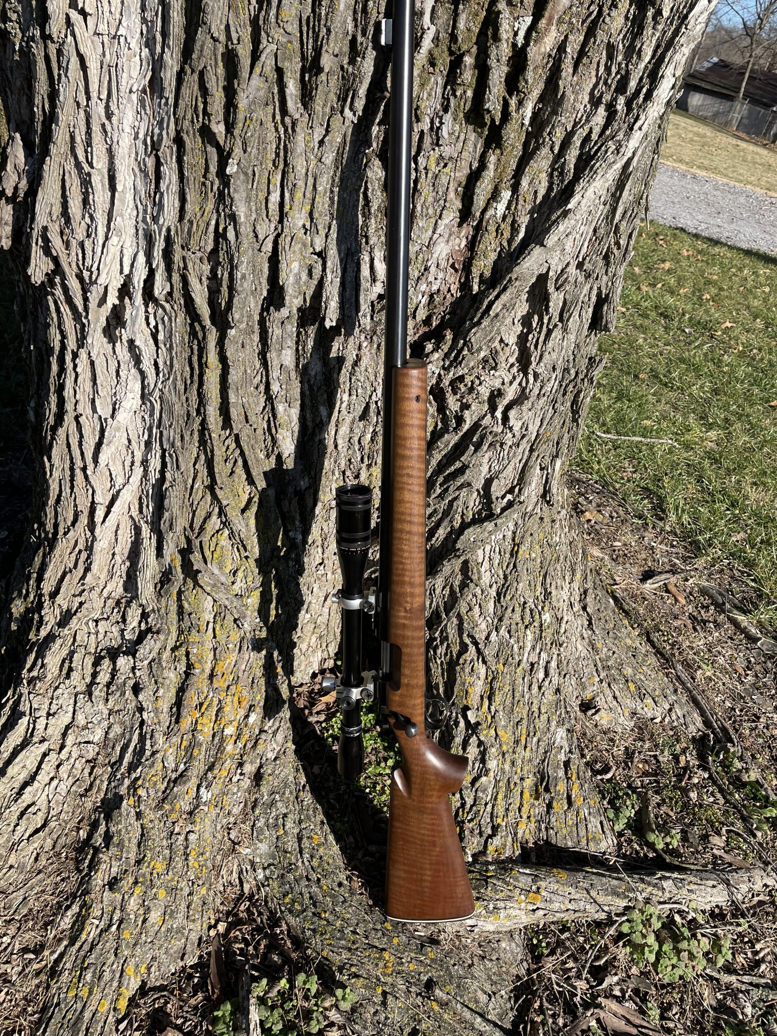

I recently told a story on myself of having two Winchester 52's in my safe for 7 years without ever sending a round downrange with either. Well, full truth be known...I also have a Remington 40 XB that I've had for 6 years that I have also never fired. I was happy with shooting the 52's, so I decided to get my 40XB ready for action also.
I have a B&L 36X scope which was not being used and bought the mounting hardware.
I don't have any range report yet, but here is the rifle...

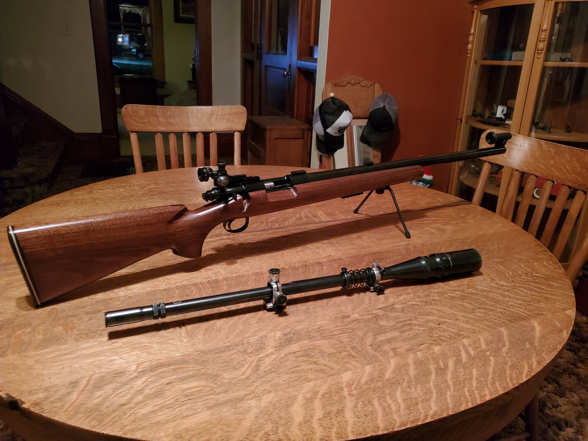

Calfed, I hope your 40XB shoots as well as mine. I found it on a local classified forum, a guy was selling his fathers guns after his passing. He had actually sold the gun he had posted but told me he had another so I made a one hour drive to check it out, It's US marked with a non matching s/n bolt, I got it for $1500 with a Unertl 24X scope. It was in a oil finished Marksman stock that is somewhat beat up. I did find another Marksman stock with a lot of fiddleback to refinish. I left some of the blemishes and the number painted on the end of the fore end. The rifle is not perfect so the stock doesn't have to be. I removed the Unertl and put it on my 52E, but I did buy a Remington 24XBR for the 40XB. I'm awaiting information on scope bases from Outback gun parts.

I got mine for $649 without sights, although it did have the sight base for the Redfields. I pulled the bolt today and it is EP'd with the matching serial number.
I got it at one of those 300 gun online auctions...only one available :) . The Unertl scope you got with yours is probably worth nearly what you paid for your whole set up.

Looks like you have a shooter. (y)
Here's mine with the Remington scope mounted.
