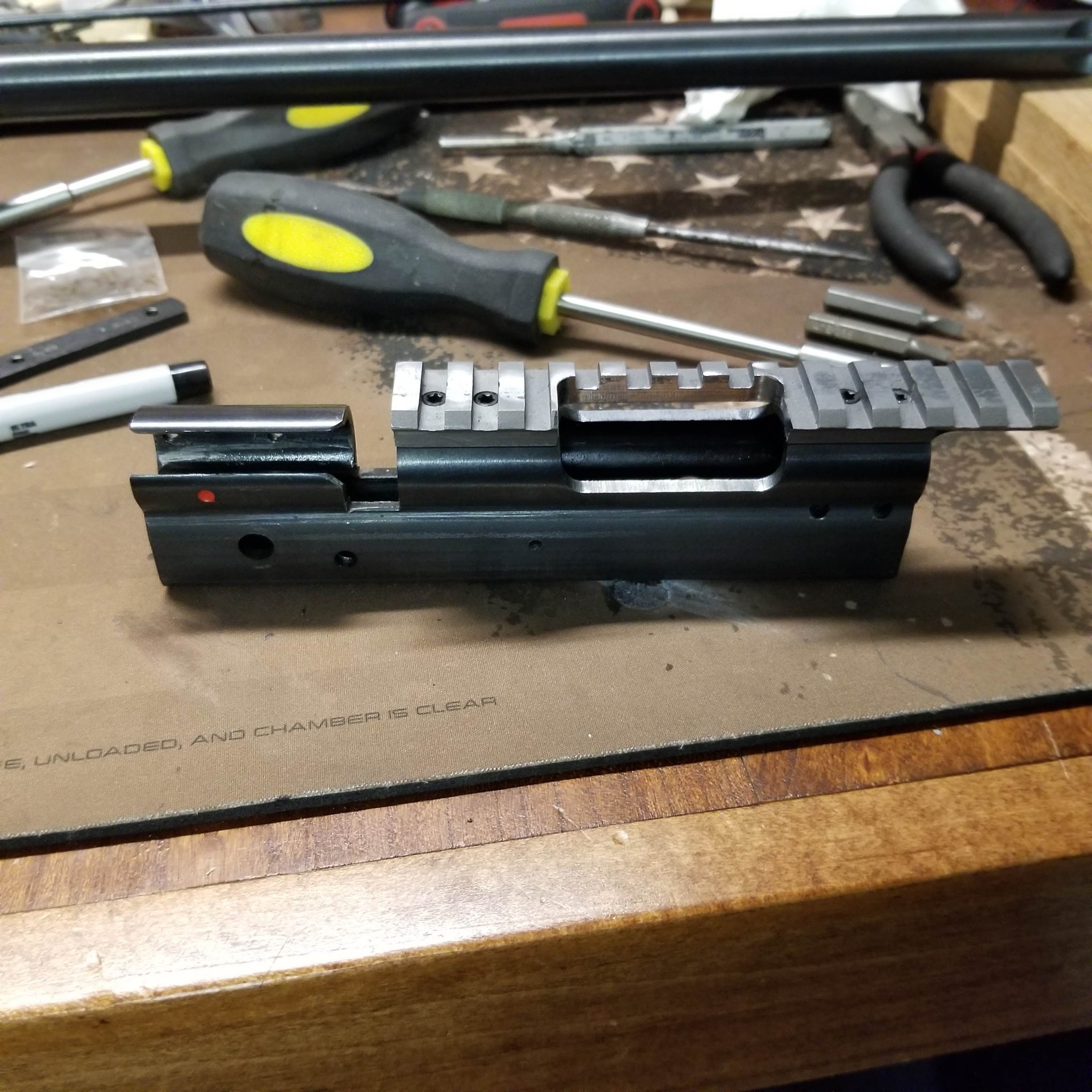

Try the EGW Winchester 52 Target (fits Kimber 82C, 82G, Rem 37) Picatinny Rail 0 MOA I use this on my 513 T and it works well.

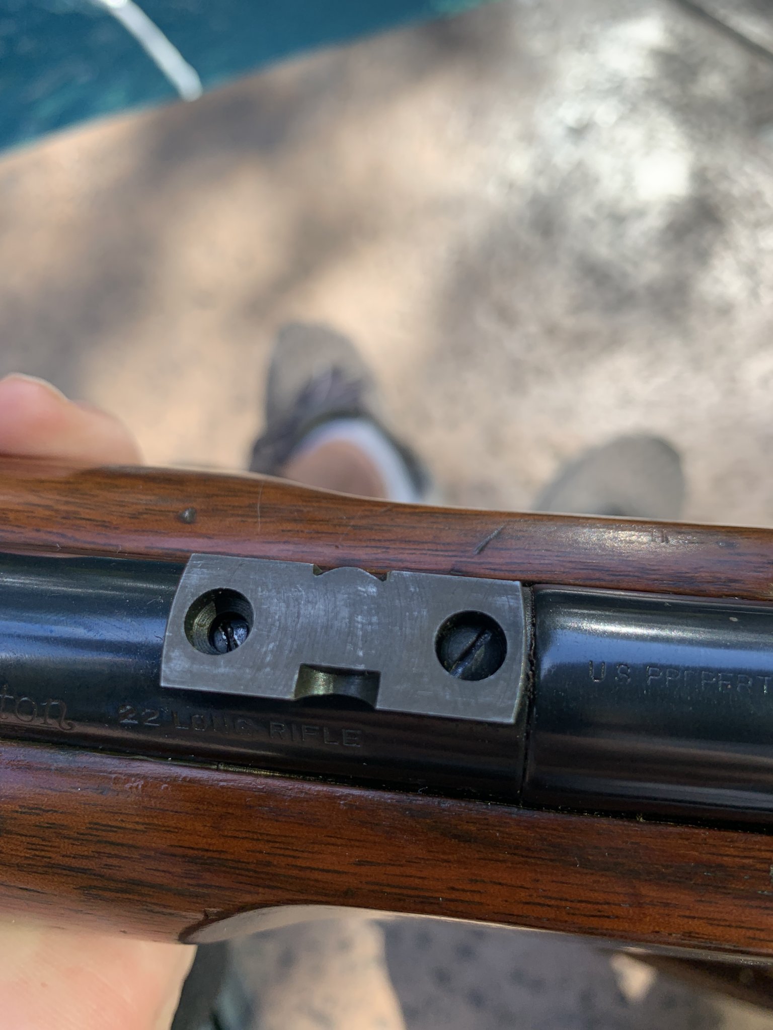

Here is a pic of the rear base on my 513T. I assume the EGW rail would mount here, right? I think this base was for a Unertl scope. Also do you know how long the Picatinny rail is? I was going to mount my old Weaver K4 (or K6) to it and the K4 has only about 3-5 inches of eye relief.
Sorry for all the questions, but I do really appreciate the help.

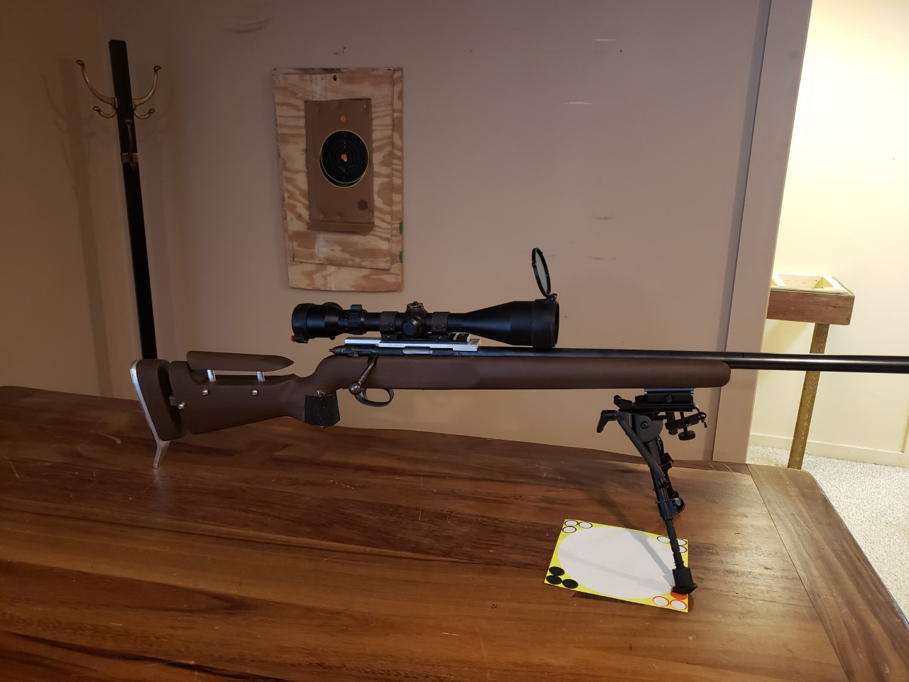

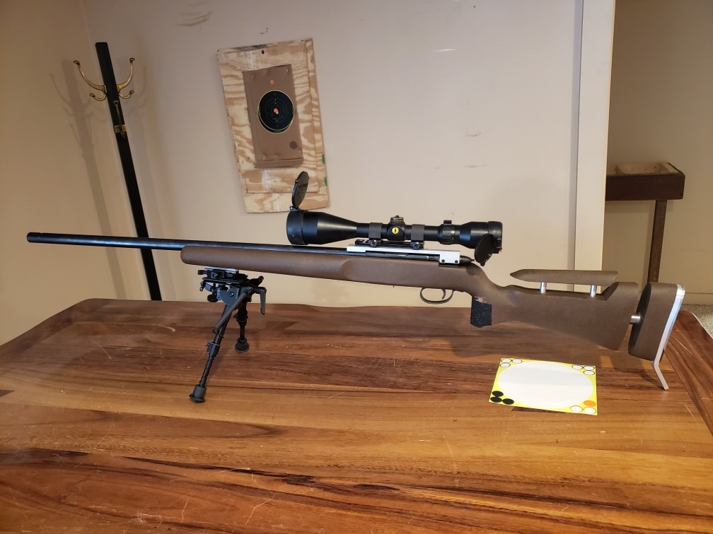

Personally, I'm in the camp that you make the gun what you want it to be. If it requires drilling and tapping....do it. If mounts exist....grab it.
These guns were MADE to shoot in competitions. The RFC crowd can look at added on wood cheekrisers or cut short stocks with butt hooks attached and side drilled optic mounts and they go, "Ooooo.....Aaaaah.....look at this vintage rifle....wonder what kind of ass it must have kicked back back in the day.".
And then in the next sentence they come unglued because I drilled and tapped my 513T and won my first match after like 4yrs off. And later qualified the for the NRL22 finale with it.
View attachment 7463354 View attachment 7463353
If you don't want to do that....I get it. I'm fine with that. There needs to be some minty examples out there. But few actually are. These guns weren't ever expensive or rare or considered "fine firearms for their day". They are good and they were built for end users who weren't gentle on them.
Sorry for the rant. Hope you get your rifle up and running. But if you don't....don't sweat it. You can buy a Tikka or Ruger brand new and it be easier and cheaper.(Remington can't even try anymore it seems :( )
I've owned multiple Rem 40X's and my current match rifle is a Bergara B14R. It's not a 40X on feel but it kicks the shit out getting a 40X running for match shooting.

Makes a lot of sense. So, either a Weaver # 42 or #43 base will work. Wonder what a ‘smith’ would charge to drill those holes? I don’t have a good drill press.
