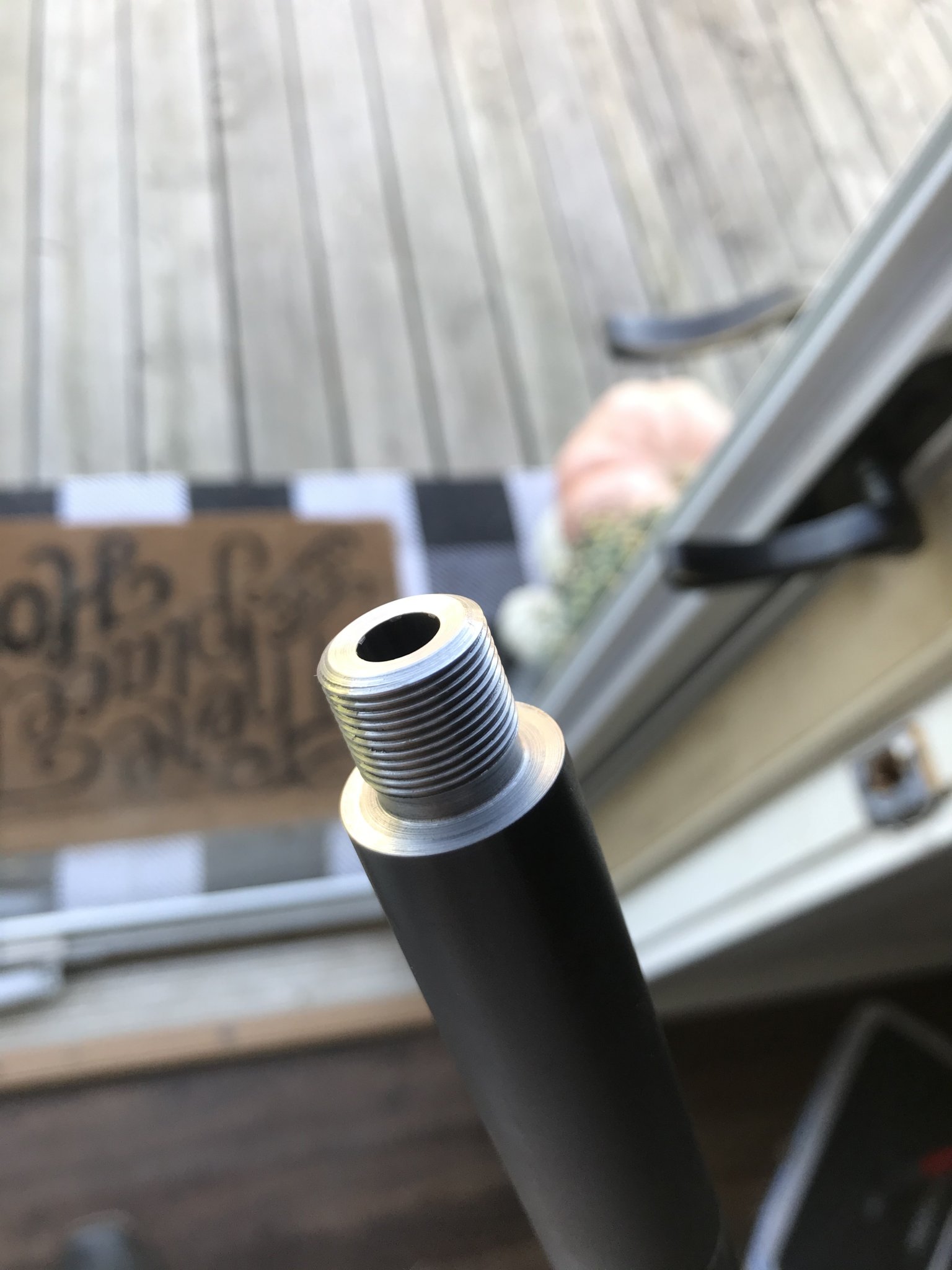

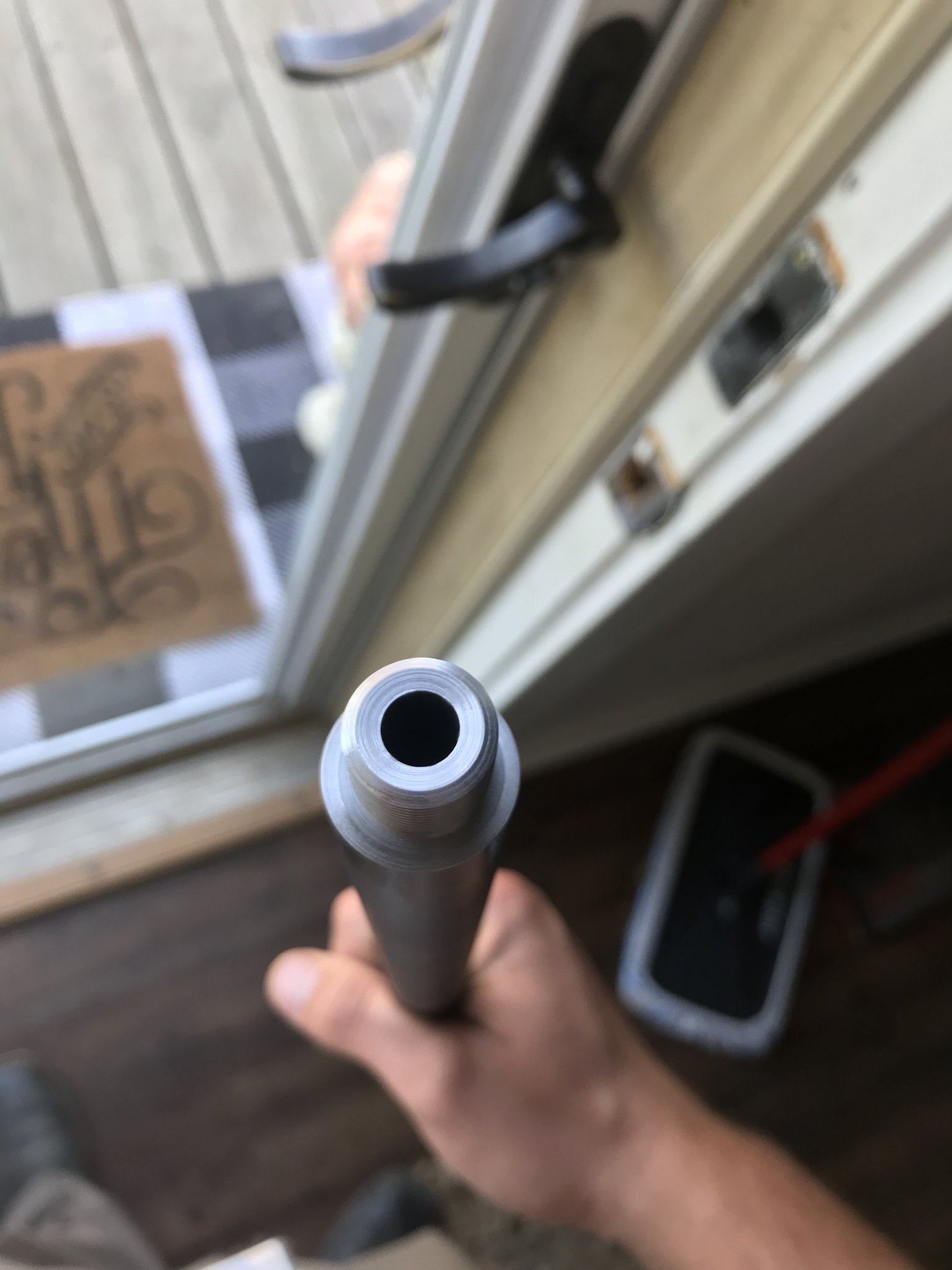

I need some help. I recently bought a Remington 700 tactical with a 20” non threaded barrel. This gun was manufactured in 2013 per Remington.
The barrel is 1:12 twist. I had barrel cut and threaded and re-crowned by class 3 machining in Dallas it looks great.
When I bought this used gun I shot some 168 Federal gold metal match. Gun shot decent 3 shot group right a inch at 100yrds I sent to get cut at 16.25 After it got back I cleaned the barrel with a brass brush and hopps solvent. “Maybe I shouldn’t have”
Now I can’t get this gun to group at all 2.5-3.0in group all it will do.
Factory Ammo I’ve tired
Hornady 168amax
Hornady 178 eldx
Federal gold metal match 168
Remington corelock 150
Winchester PowerPoint 150
Gun specs-
1:12 twist
Timely trigger
Magpul Hunter stock
TPS base
Warne rings
Vortex viper 2-10 pst
Omega 30
I’ve shot 44 rounds all different ammo can’t get under a 2in group...

You've ruled out the torque on the scope rings/mount and action screws, correct? And that the barrel isn't touching the stock anywhere?
Did you change anything else when you had the work done?
Hmmm.
Check barrel tightness.
Check headspace on brass fired after cut and brass fired before.
I think most smiths would remove a barrel for that work.
Pull from stock. Look it all over (action and recoil lug area).
Re-torque into stock.
Double check all base and rings torque.
Shoot it without the break. No thread protector.
Pull a Q-Tip out of the muzzle against the new crown to check for any lips or burrs. However, from the look of the work I think this would be unlikely.
Thank you,
MrSmith
Reactions: Dpp
I'll take a different tack.
Naturally, the fact that you say it shot OK before sending out to chop and thread- and it shot differently when you got it back would logically lead us to think it's related to that...
But as the saying goes, "correlation is not causation".
You cleaned with Hoppes, which is just a powder solvent.
Have you stripped the bore of copper since you bought it?
Bullets coming out too slow. You took almost 4" of bullet velocity and stabilization at a slower 1:12 twist off the barrel. Unless Class3 goofed up re-installing your barrel (I'd be surprised if they actually had to remove it), the twist rate is probably your issue. Class3Machining did my Savage threading and it's dead nuts bore-centered and the crown is tippy top. Suppose you can check to see if your new crown is not the same all around its diameter.
My 308 barrel is a 1/10 twist. Likes 175 gr. bullets the best, in my experience. Never fired anything heavier, though. Does 168s nicely too.

The crown looks good, I would try a 155gr. Bullet, 1-12 may not be fully stabilizing the bullet. I have a 700 sps 1-10 that loves 168's. I also have the same can.
Shoot it without any muzzle device on? Get a base line off of that. Then add muzzle device, see if there is any difference. Got to find the variable.

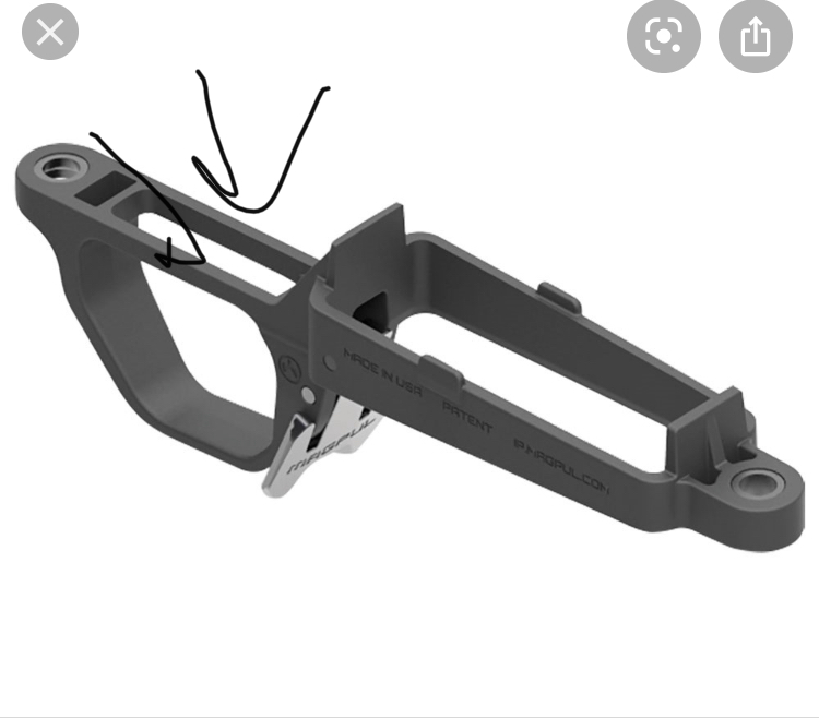

Hi Guys,
I think i have narrowed my problem.. The pervious owner painted the stock and the thickness of paint actually cause the trigger to rub the sides of the trigger guard i found this out by closing the bolt and the firing pin would let go.. lucky i didn't have a round in it i knew than something strange was going on.. I took the stock back off and inserted the bottom metal and noticed it wasn't very smooth but basically the trigger was in a bind due to paint thickness and I removed the paint around the trigger.. Gun is shooting much better. Thank yall for all the advice. Now i just need to practice.

Hi Guys,
