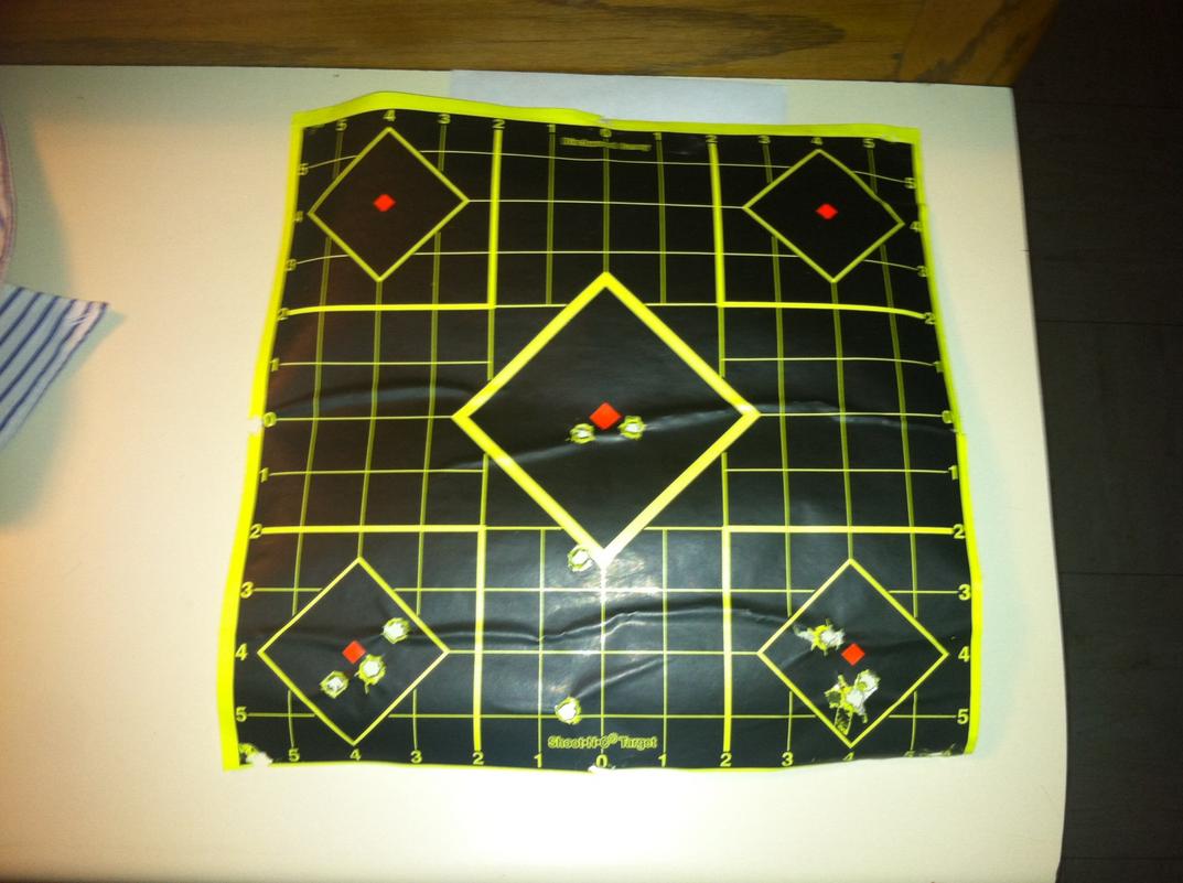

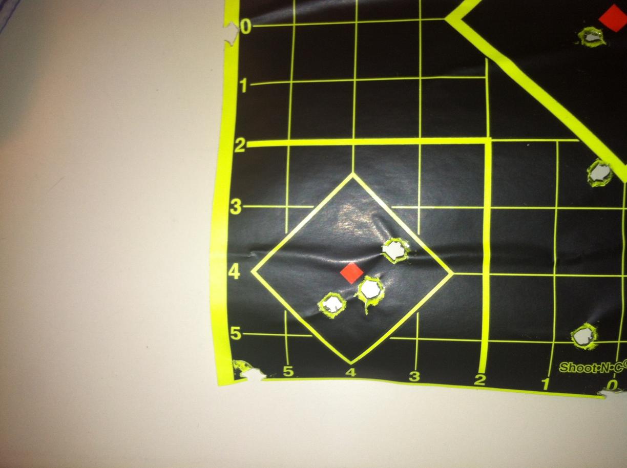

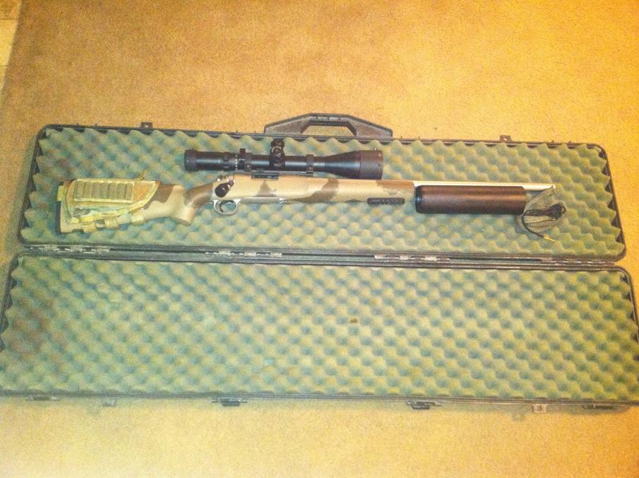

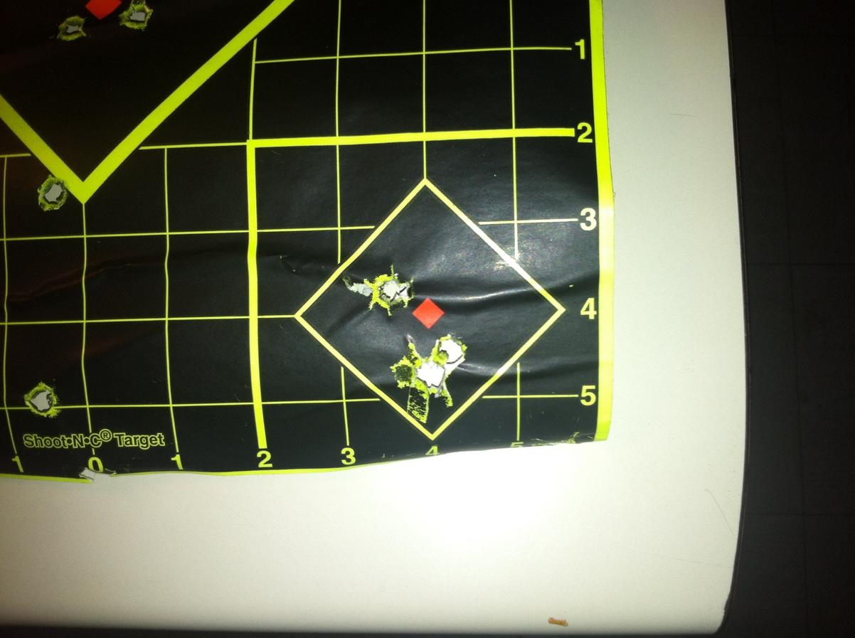

Hey guys. I just bought a brand new remington 700 5R in .308. I shot 30 rounds through it to break it in using the shoot 1/clean method for 5 rounds then shoot 3/clean for five 3 shot strings then shoot 5/clean for two 5 shot strings. It took about five rounds to get on paper and zeroed and from there shot two groups. I immediately replaced the X-Mark Pro trigger as soon as I bought it with a timney 510 set at 2-2.5lbs. I'm running a PRI steel one piece base with 20moa torqued to 20in-lbs and a millet LRS in steel v-tac rings torqued to 30in-lbs with the cross bolts torqued to 50in-lbs! I'm shooting federal gold medal match ammo in 175 grain that is marked 7.62-51 instead of .308 which is the exact same ammo as lake city XM-118LR. I'm shooting from sandbags in the prone position with a zero value wind. The two groups I shot are 3 shot groups that run 2MOA AT 100 YARDS!!!! I have read where guys on here are shooting .2-.5moa with this same gun ammo setup! Did I receive a bad one that needs to go back to remington? I have heard they have been having quality issues or do I just need to shoot it more to see if it closes up? It has 45-50 rounds down the tube. I had a remington 700 SPS Tactical in .308 several years ago that I done nothing to except take the X-Mark Pro trigger down to about 2.5lbs and left it in there as well as the cheap hogue stock and just had a basic luepold vx-3 3.5-10/40 with duplex reticle that I was shooting 1964 heads tamp lake city 7.62-51 168gr BTHP Match ammo though that shot a 5 shot .75-1moa group at 100 yards all day every day off sandbags with a zero value wind!!! Can someone please give me some helpful info??? I have over $2,000 in this rig plus ammo that my 20 year old ruger m77 in .280rem will outshoot!!! The two groups on the bottom of the target are my actual groups. The others were getting it zeroed. The one on lower left was first group then lower right was next group. Thanks guys!

Yes, what did you torque it to? How many foulers did you have through the barrel after doing that nonsense break in? Have you checked torque on everything else? Tried a different scope? Shooter?
It's not spraying a 6" group which is a good sign. You also have to keep in mind that while these are good barrels, they are not high end barrels that are hand lapped. It's not uncommon for these factory barrels to need 100+ rounds to smooth up. On a 308 running 100-200 rounds is nothing as far as barrel life so I typically run a bunch of the cheapest M80 ball I can get down the tube before I pass judgement. Often time that's all it takes.
Forget about ridiculous break in methods with cleaning, the best break in is rounds going down the tube.
You have only shot one type of ammo so far? The 7.62 fgmm is not the same as the .308fgmm. Get some other ammo, try fgmm or black hills.
Everybody wants to blame the gun when it doesn't shoot .2. Remember, it's not a custom gun. I'm sure it can shoot better than 1moa if you find what it likes and practice wih it.
Ditto on checking reassembly/torque values/scope mounting/etc. and running some different ammo through it. I'm getting .4-.6 with my all stock 5R using Black Hills 175's, but that doesn't mean your gun will like BH. Gotta find what your gun likes.
you have a few things to look at here. First is you...get a bipod and use it. How's your position are you behind the gun good, are you following through and getting good trigger control? Next is ammo, try different ammo...my 5r is picky about some ammo...next your scope...u might check it on another gun to make sure it's working correctly...next is take ur gun apart and check that there is no debris between the stock and the barrel...even a small speck can cause what's happening...
The 5r is not an out of the box .5 moa gun its a 1 moa gun...that's not to say some are not, but it is a factory gun. You will prob need to have it bedded...
I once had a VTR that wouldn't shoot for shit no matter what load I tried, my own , or factory match. I'm talking like 2 or 3 " groups at 100 yards. I got so pissed off I just gave it to my farm hand with a few 165 game kings I loaded up and said Good Luck ( deer hunting). Well a few weeks later he asked if he could zero it. I said sure. I promise this is true... He put 5 shots inside of a quarter. I was so confused... WTF!!
Later I came to the conclusion that it just had to be shot enough times to get it pinging good. So then I gave him my old faithful Ruger M77 .280 :)

Thanks guys. Also what is wrong with the millet? I was told it's the equivalent or better than the Bushnell elite line. Bushnell owns millet now. I was under the impression it was one of the better choices under a $1,000. Nightforce atacR is next on the list but finances are tight and income tax is spoken for already. Any ideas on a similar powered scope setup with similar magnification and objective for under $1,000? And also with the 168's how do they perform at distance? I went with the 175's because they are a little more forgiving in the wind as I'm not the best at reading wind yet. How much additional velocity is gained by using the 168's over the 175's? Is the benefit worth the cost? Thanks guys!
Millet is a lower end optic, but attractively priced for the features. My 5R has had the same Bushnell Elite Tactical 10x40 since I bought it. Ive shot awesome with it since new and havent changed anything as not to rock the boat. I believe a Nightforce is a waste of alot of money, I hope the guys here dont bash me on that but its my opinion. I just acquired a vortex viper pst 6-24x50 FFP Illuminated and am very thrilled with the optic and warranty it comes with as well.. best part of all I used the point from my credit card to purchase it, the only rewson I went with that calibur of an optic.
As far as the 175s go vs 168s.. 175gr smks go further and stay flatter in flight especially out to 1000yds. Price is a dollar more per 100 and my reasoning is go with the better projectile the rifling was designed to perform the best with and shoot the 175s.
