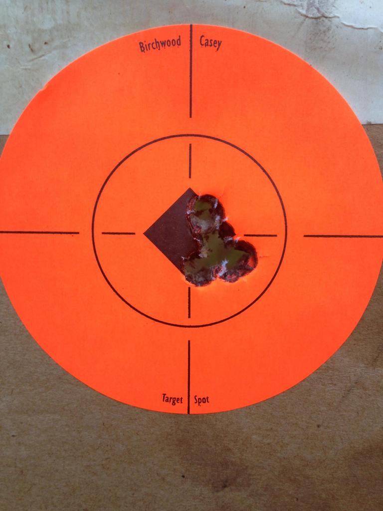

This was the third range session with the same rifle.
First was zero, 2nd was shooting out to 400 yards, third was getting use to setup vs a .223 (how to manage recoil).
175 grain Federal Gold Match.
