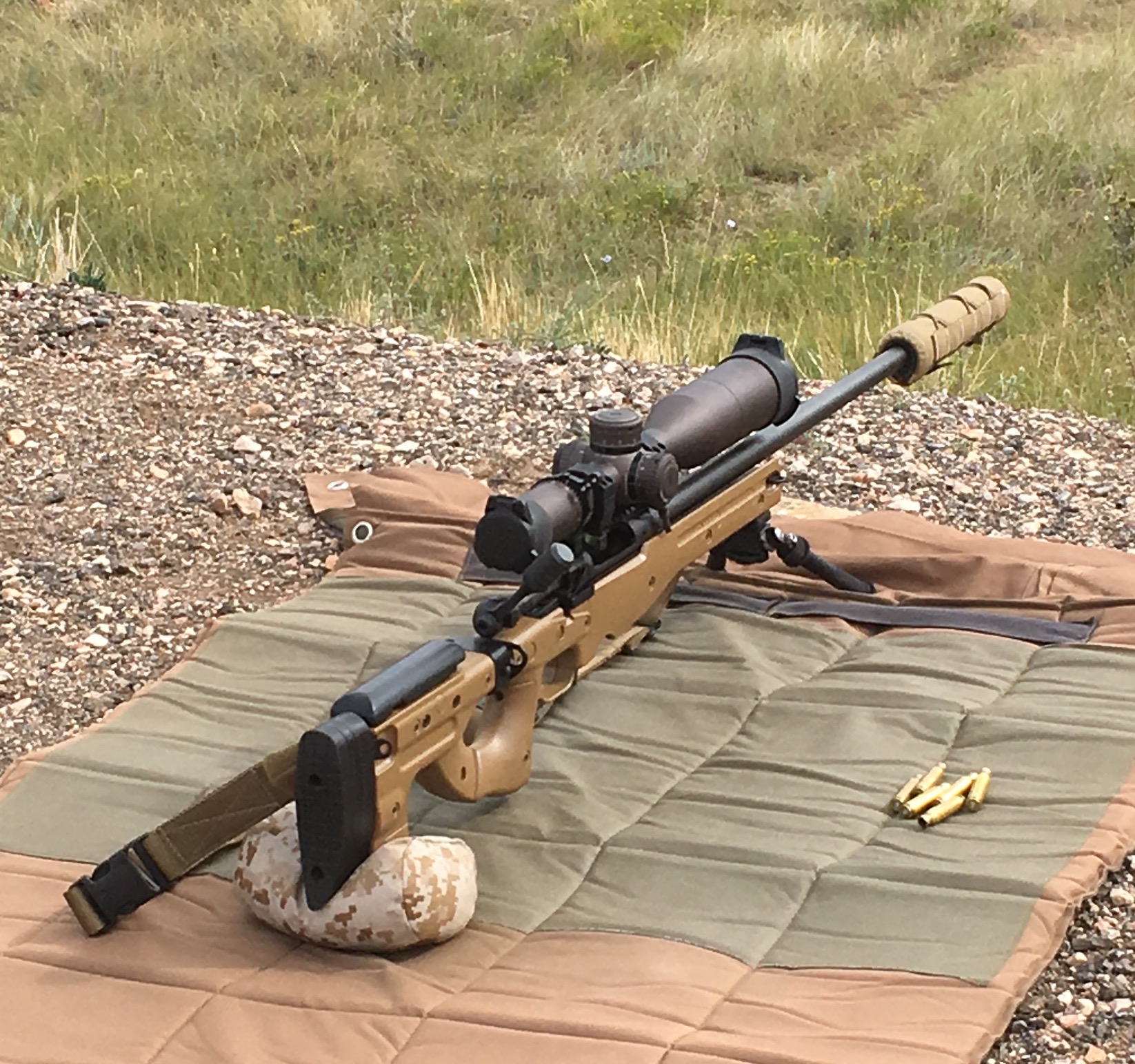

Well done! Post a pic when you have one. This was my old Savage in an AICS.
