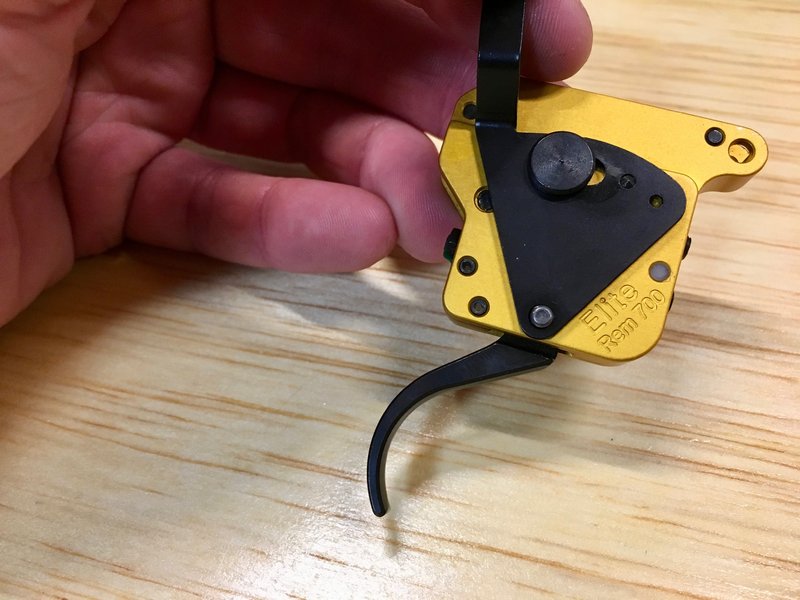

Timney Calvin Elite:
I really like this trigger as well. I find the ergonomics to be very nice. It did feel a bit “off” when running a vertical grip on my MPA chassis, and I think the angle and set back of the trigger shoe is best for traditional rifle stocks or a pistol grip with a bit of angle to it. The trigger shoe is a nearly perfect balance of width in my finger. I find it to be very comfortable as it is very subtly curved on the edges of the trigger shoe. From the factory, this trigger has the most pre travel and a slight bit of over travel of all the single stage triggers I have used thus far. It’s not horrendous, but definitely noticeable. But its standout feature-set is its adjustability. You can adjust not only pull weights but also sear engagement and over travel engagement making it one of the more adjustable triggers akin to the jewell; However not externally adjustable which is a bit of a pain. This trigger has a good crisp break, not the most crisp, but solid. I think it is still a very good value option and one of the best in terms of adjustability.
Price/value: 8
Availability: 10
Adjustability: 9
Reliability: 9.5
Crispiness: 8
Ergonomics: 8
Warranty/ CS: 9
Overall: 8.79
Pros:
Price/value: 8
Availability: 10
Adjustability: 9
Reliability: 9.5
Crispiness: 8
Ergonomics: 8
Warranty/ CS: 9
Overall: 8.79
Pros:
- Clean crisp break
- probably one of the easiest to get a hold of
- very adjustable
- nice price point- street price usually lower than MSRP
- nice low pull weights if desired down to 8 oz
- very reliable
- good ergonomics - best set up in a stock in my opinion
- Not the cleanest break of triggers tested
- very adjustable, but not externally adjustable
- Yellow housing for sure hurts my operator status
- a bit much trigger shoe sweep when running a MPA vertical grip.
