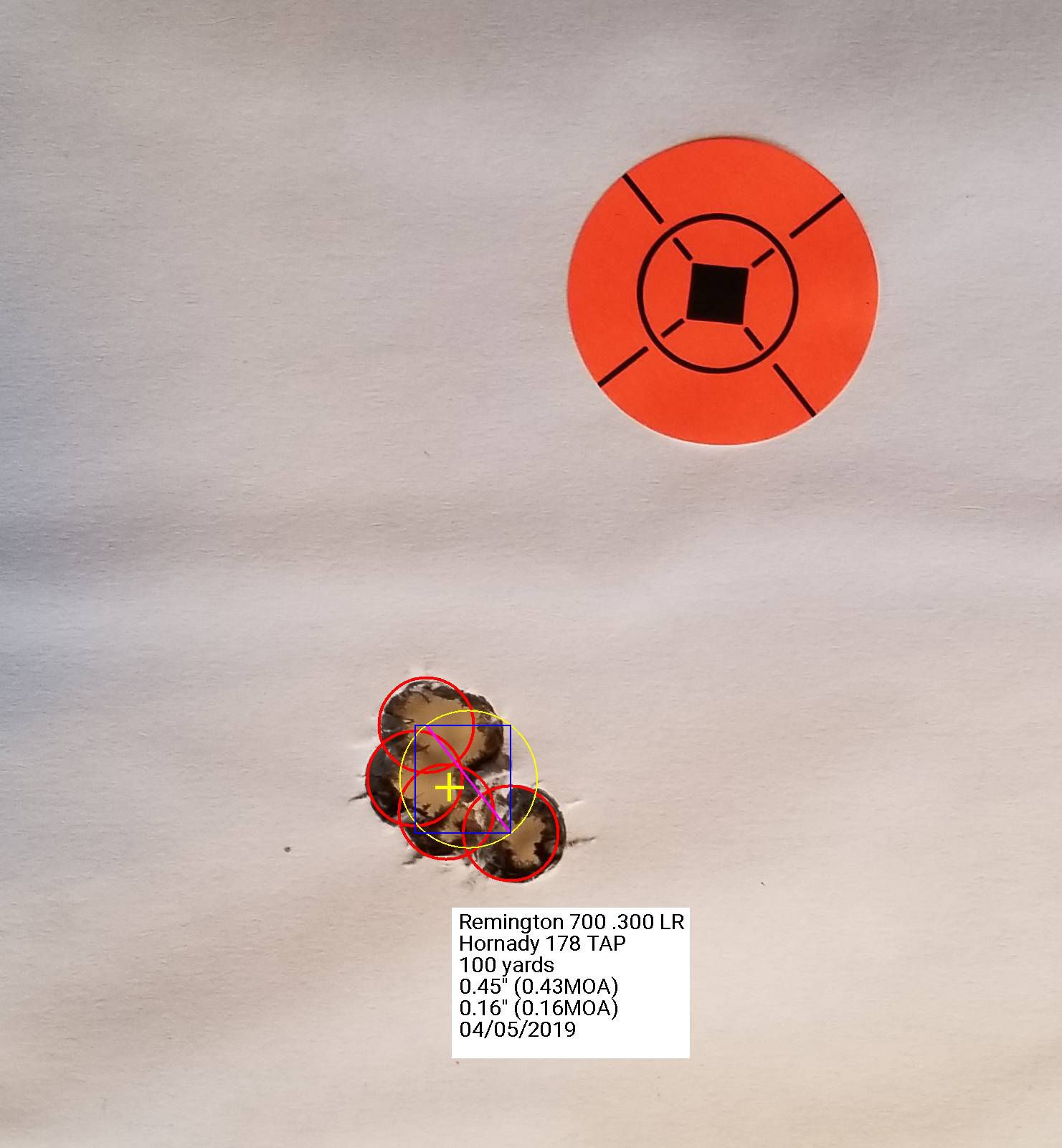

The second range session wasn’t any better than the first. I decided to do three shot groups instead of my normal five in order to conserve ammo. Even with three shot groups the only two that shot well was both of the ABM loadings with .86 with the 185gr and .45 with the 230gr loadings. The only five shot group I did was the Hornady TAP and it came in at 2.42 inches. All of the three shot groups did better than the five shot groups as one would expect. I didn’t shoot the Superformance considering how poorly it did last time.
What’s interesting about the ABM ammo is the overall length is longer than the others at 3.62 for the 230gr and 3.54 for the 185gr. The rest came in under the SAAMI max of 3.34. I think this may show some insight into some of the issues regarding accuracy.
So the re-crowing did work, as I expected. Next will be to pull the action out of the stock and see if I can find anything wrong. I’m also going to thread the barrel and put a comp on it and adjust the trigger. I would like to knock another pound off it. If I can’t I may look at getting a new one. I also may make a chamber cast and see how far the lead is. I’m also going to shoot the Hornady TAP and 195gr match until I see some improvement with them before trying the others, I have a larger supply of them.

I pulled the action out of the stock and the screws were not properly torqued down, they broke free with very little effort. There were also two plastic shims between the stock and bottom metal.
Once out of the stock I put a Jewell trigger in and set it at 2.5 pounds. I put the stock back on without the plastic shims and torqued it down to 45-inch pounds. I also have some 220gr SMK’s that should be here on Wednesday. I intend on loading them long and see if that helps. Until then I l have some pulled M118 173gr FMJ match bullets I’m going to load up and see what happens. Hopefully, I can get to the range in the next few days if the weather’s not too bad.
