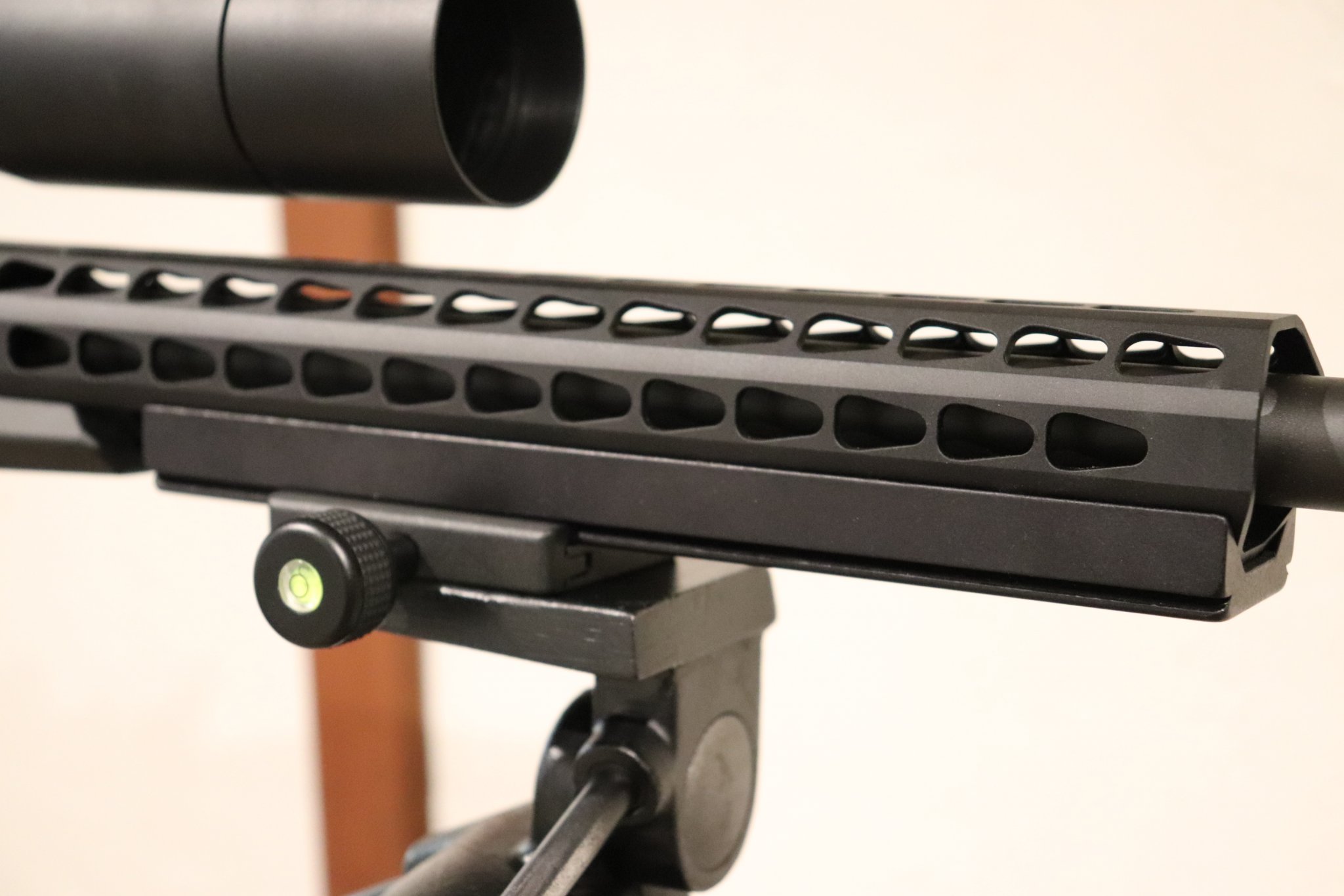

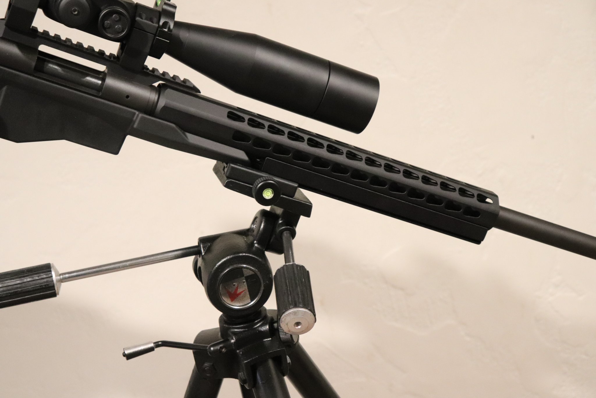

Just FYI I originally purchased an arca rail for my AX chassis from MHA customs. I decided not to use it for the AX but lo and behold it's also a perfect fit for the PCR .
