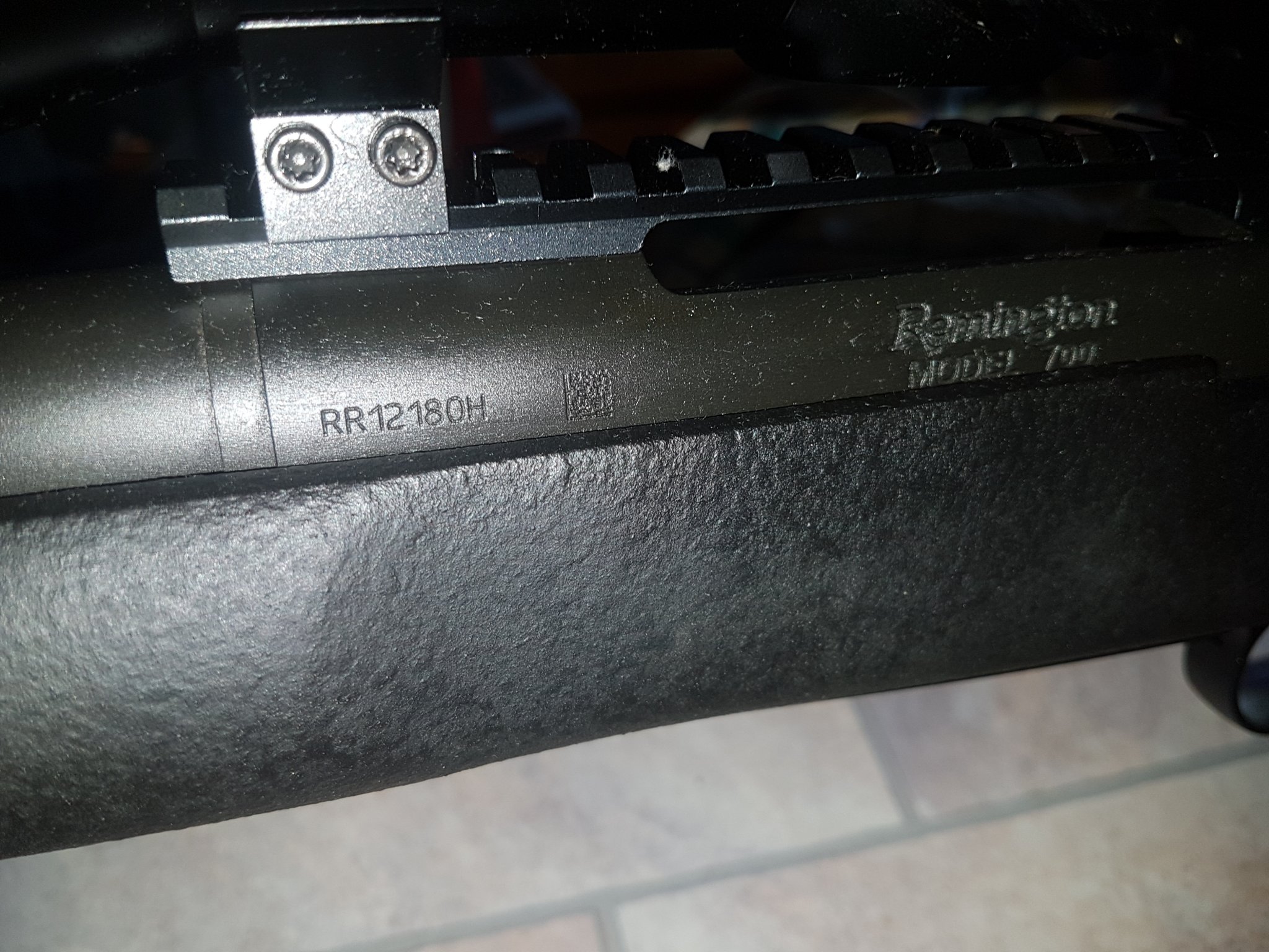

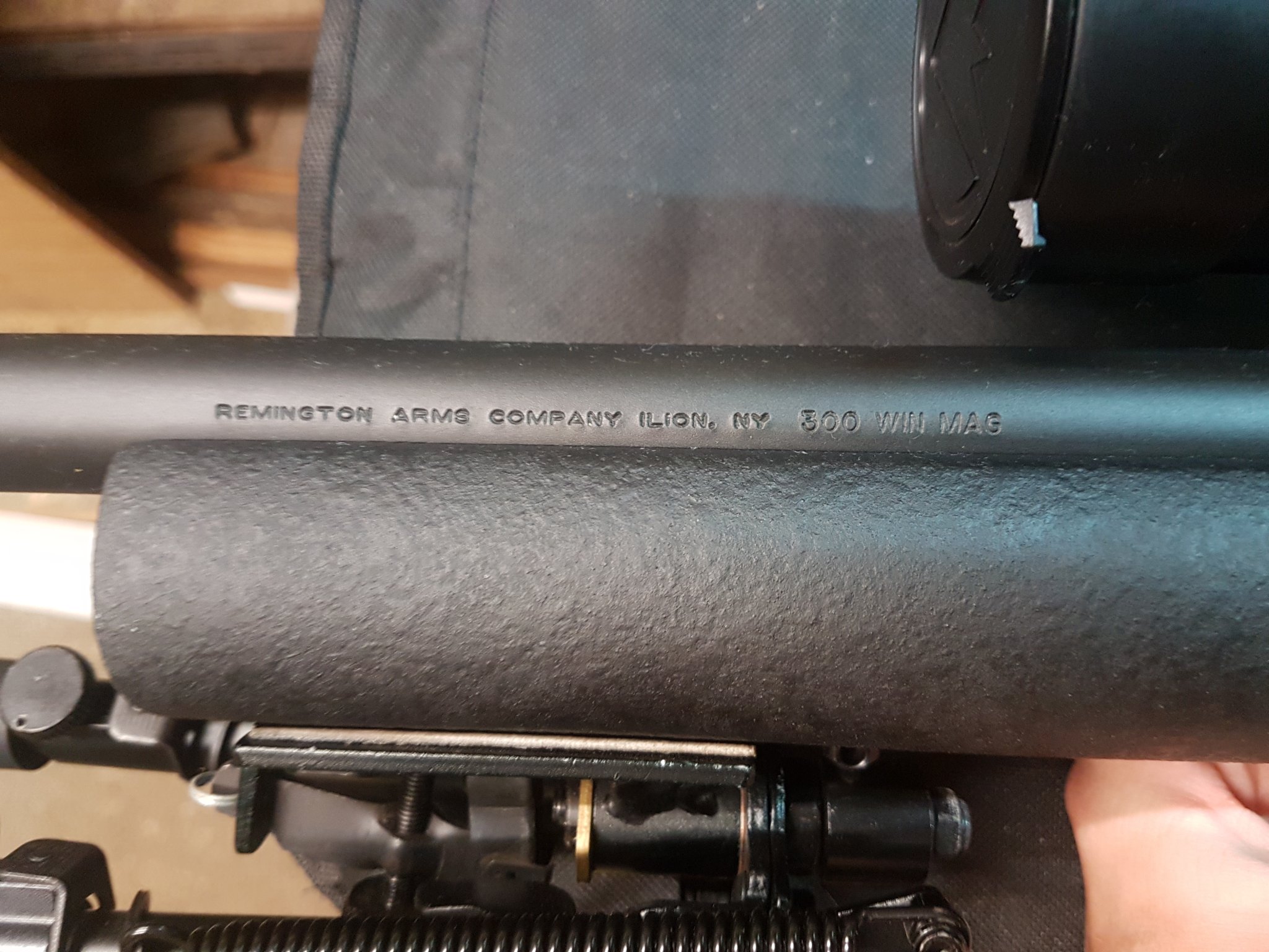

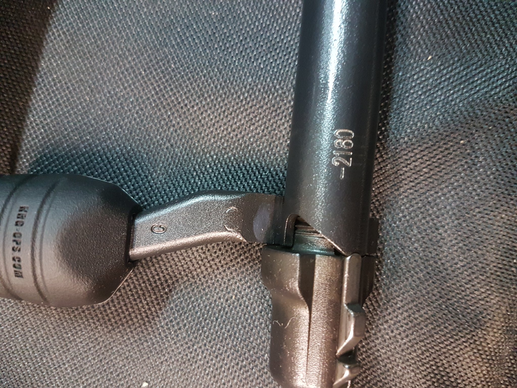

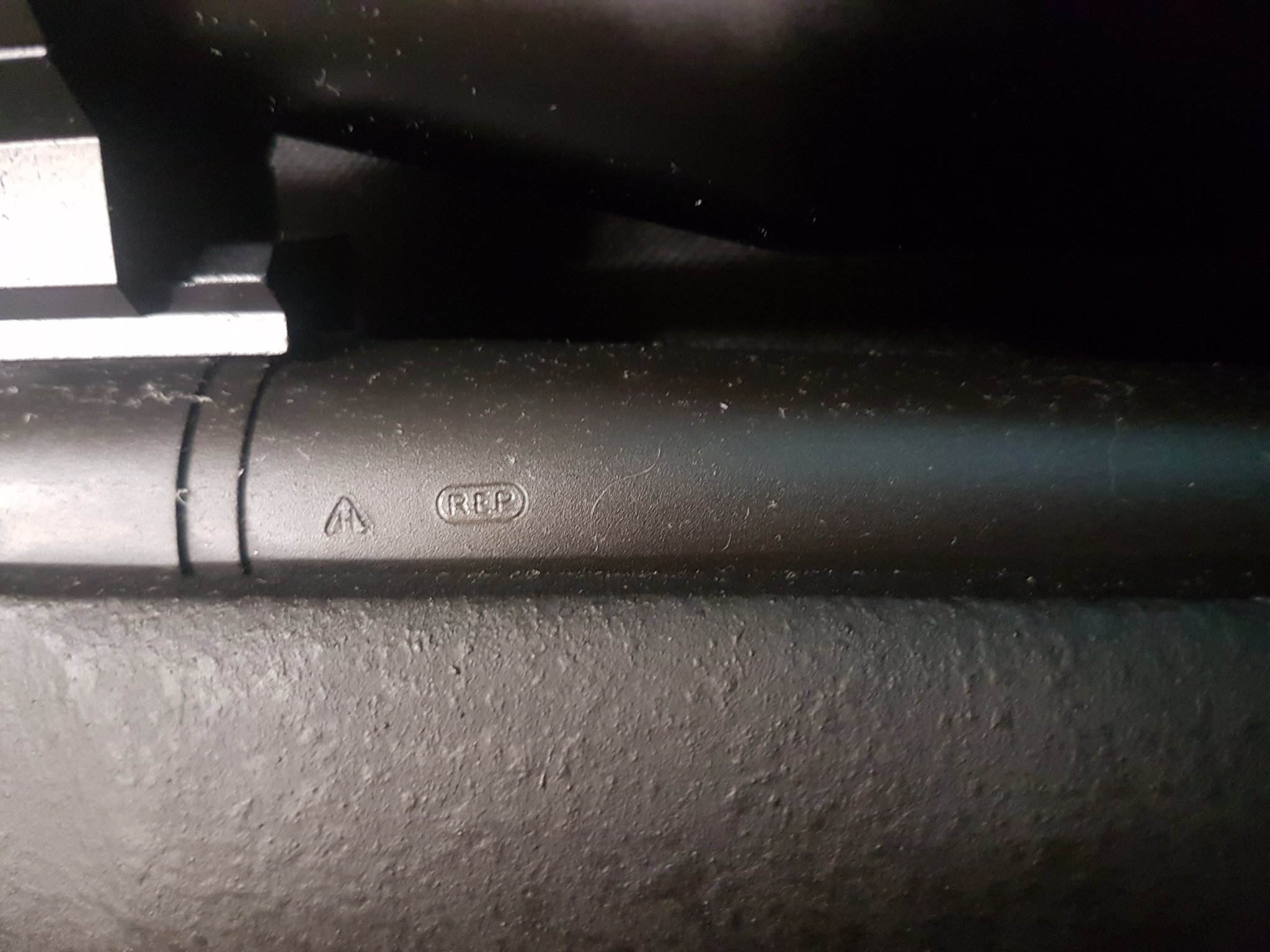

Hey everyone,
I have what I believe to be a Remington 700 Police in .300 WIN MAG, after doing some reading I found out I could check the rifle's manufacture date by checking the barrel code, but when I went to do this I discovered that it's barrel date code is missing. Upon further inspection, I found it is also missing a test mark on the right hand side. It appears to be the factory barrel, as the finish is the same and it bears Remington's stamp.
I sent Remington an email, but haven't heard back, so I figured i'd ask if anyone here has any ideas as to why this could be.

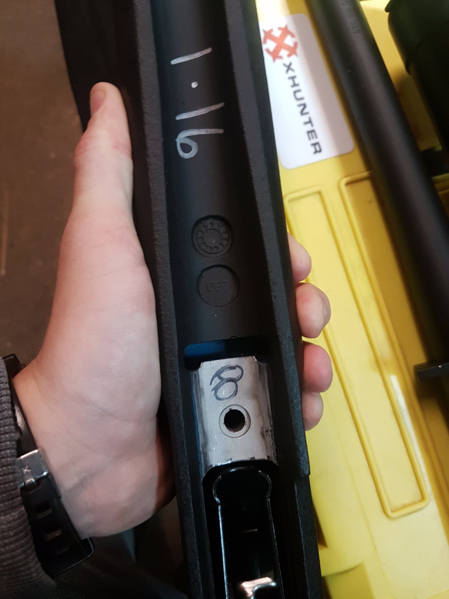

So I took the stock off, no actual stampings to be found anywhere on the barrel or action, just these markings on the stock, not sure that they have anything to do with the rifle itself. 1.16 could certainly be a date, but surely they wouldn't just write that on the inside of the stock....

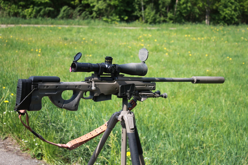

My rifle also has that, even at a 3.502" COL, I am still not tuching the lands. But it shoots great, so it is what it is. A few hundred rounds more and I am rebarreling and rebuilding it to something that resembles a Mk13mod5 anyways.
This picture was taken this past summer:
7038401
It now has a Nightforce 5.5-22x56 NXS with Nightforce Ultralight rings. And the pictured PM2 is back on my 6,5x47 Lapua match rifle.
The rifle itself started out just like yours, a bone stock Remington 700 Police.
