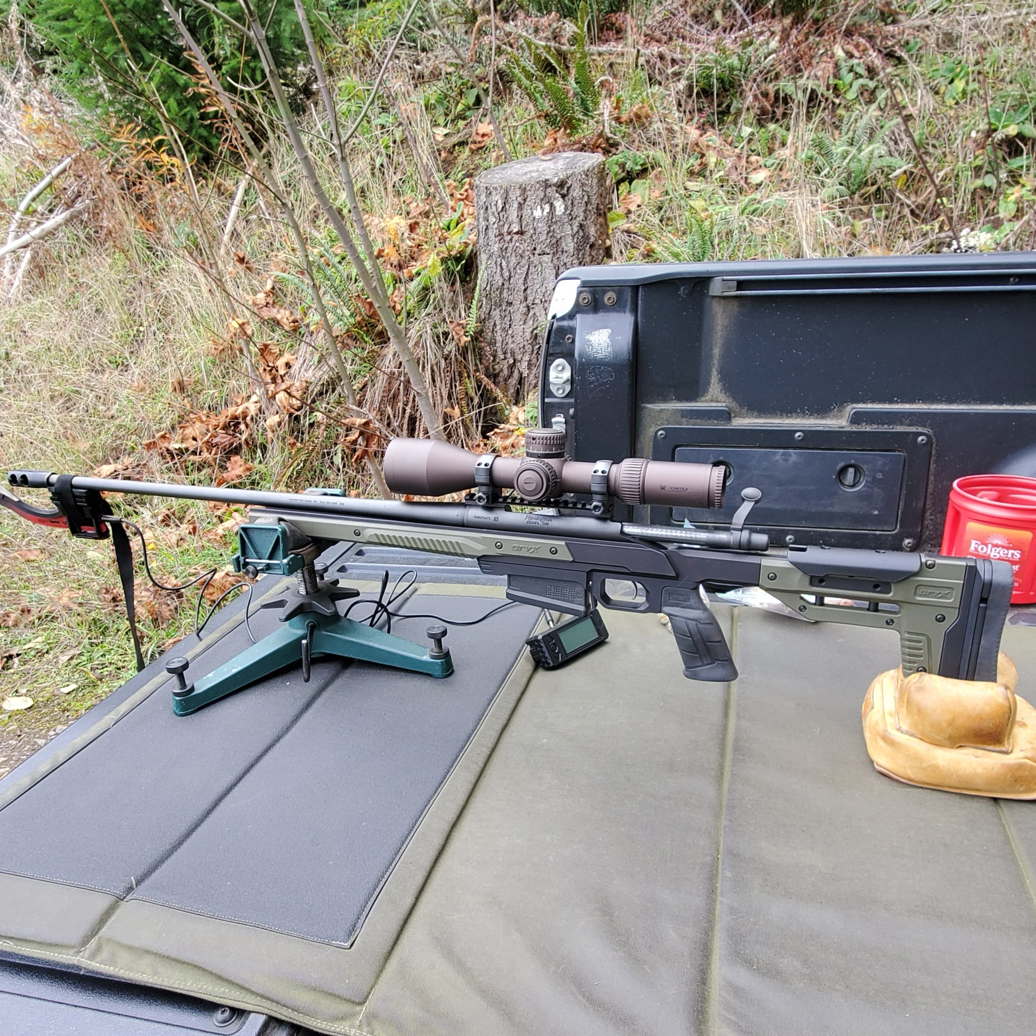

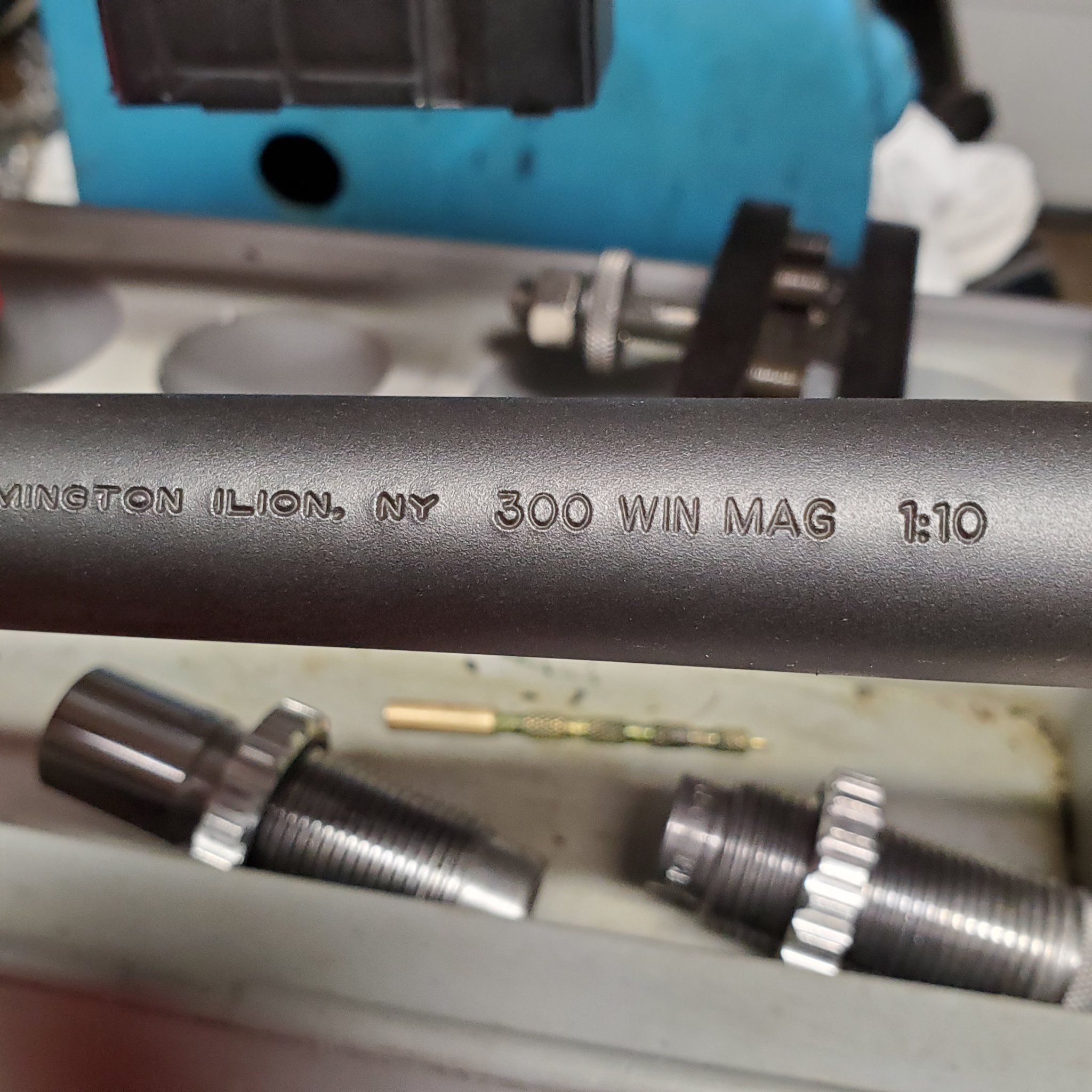

I just put the stock factory Rem 700 in 300 WM 26" barrel ADL, in an aluminum chassis. Get 3.715" steel mags.
Adjust the trigger and your ready to go.
It will definitely go 1 mile, especially if you handload.
I bought the rifle for the action....but decided to shoot it.
It shoots as well as some custom rifles.

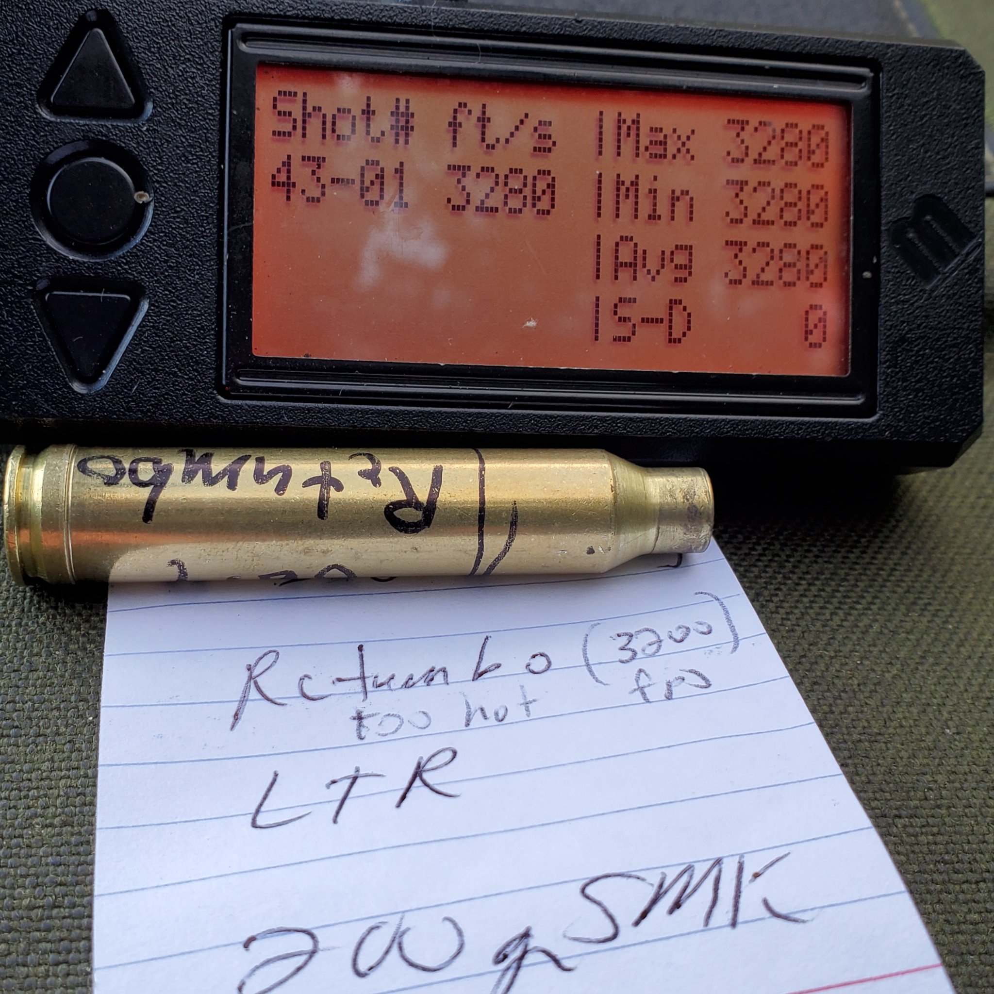

Mine loved 200 SMK .715 G1 BC . I ran them to 3280 fps but thats too hot but 3100 to 3150 fps is easily doable.

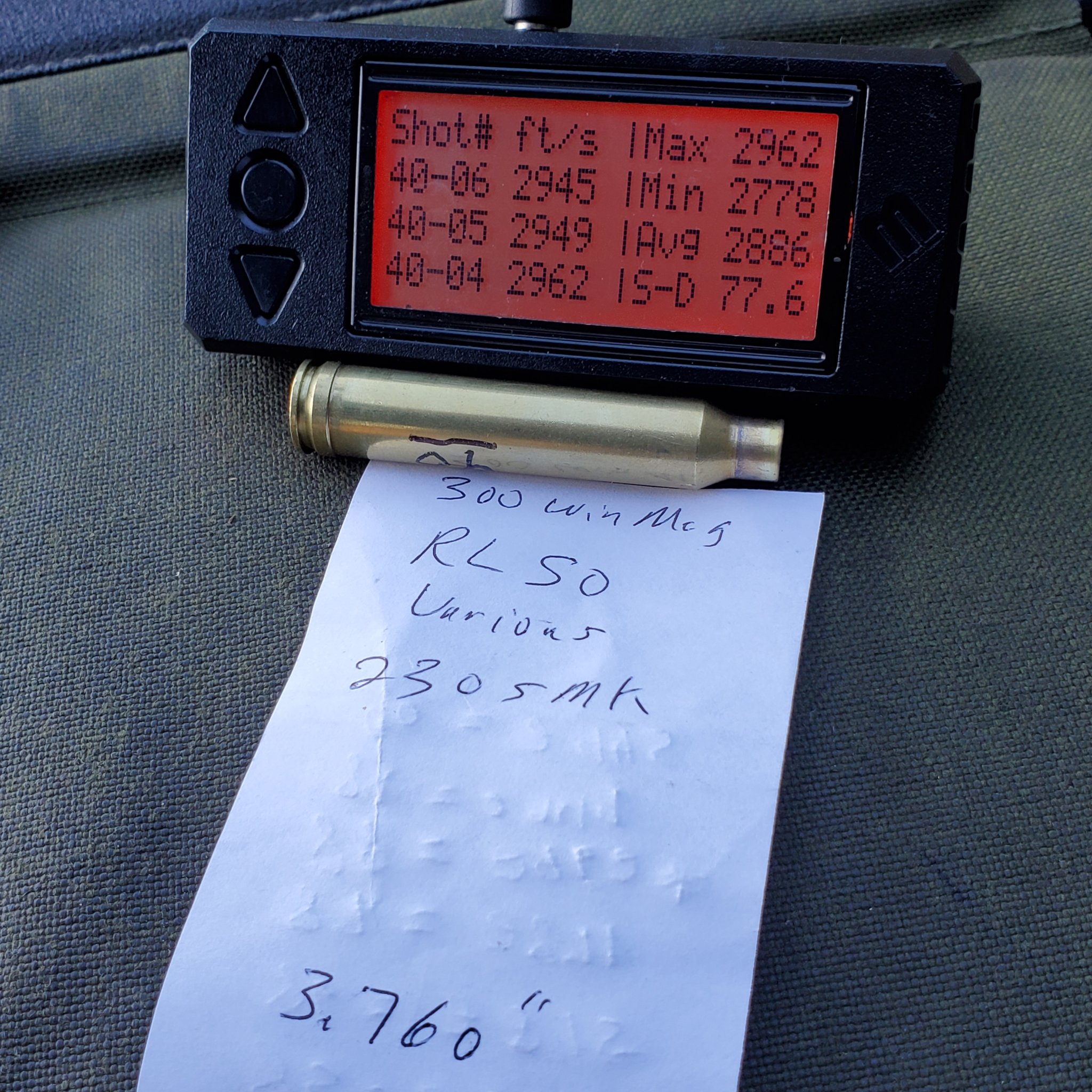

Ran the 230 SMK to 2960 fps.
That's why the long mag...none of the 3.4" stuff when you csn go 3.7" add lots of slow burning powder.
The rifle was $540 on sale, less than $400 for chassis on sale, mag was about $85.

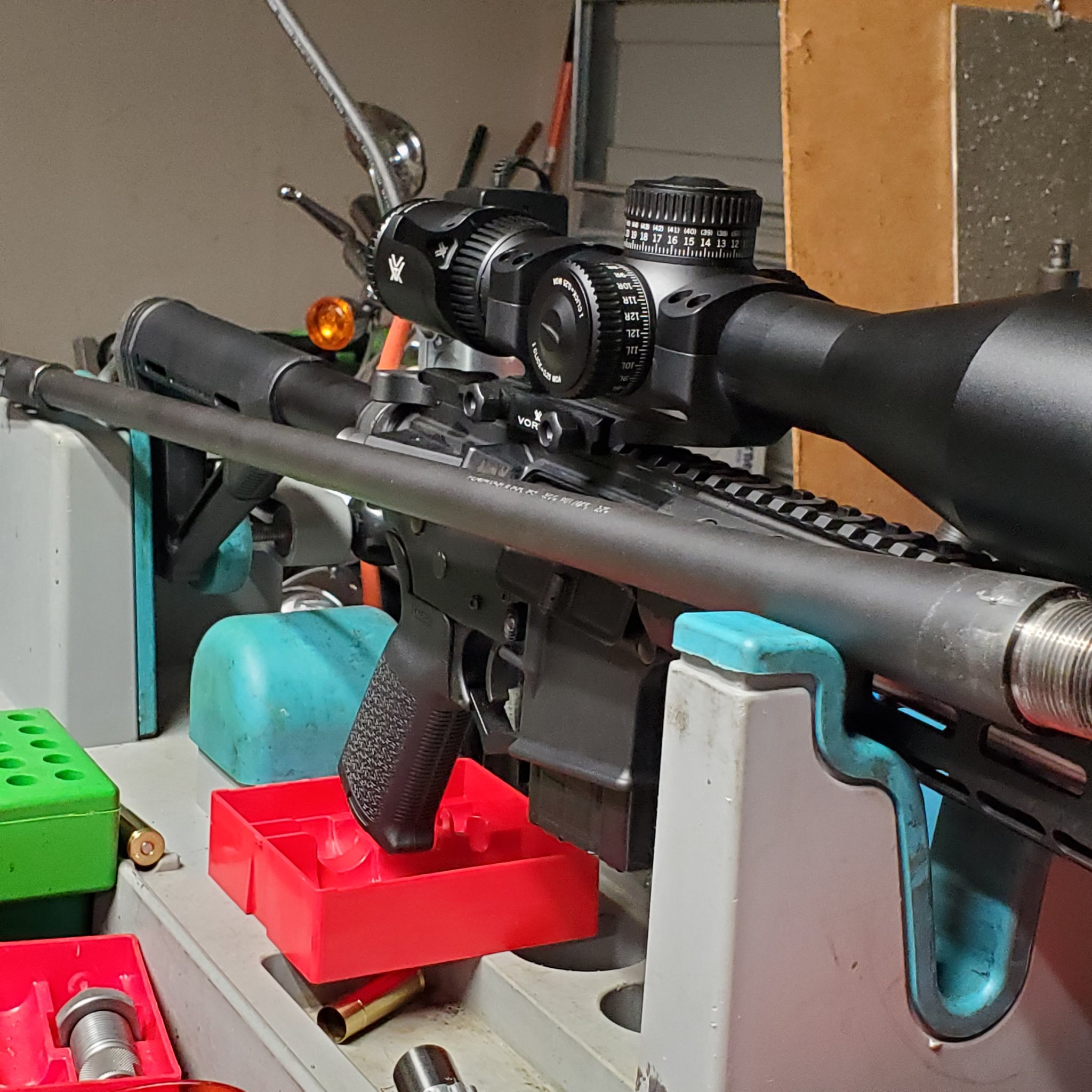

I did thread the factory Re barrel for for a Precision Armament M4-72, so one can shoot it in comfort.
So for an additional $485 chassis & Mag you can really improve the 300 WM...
