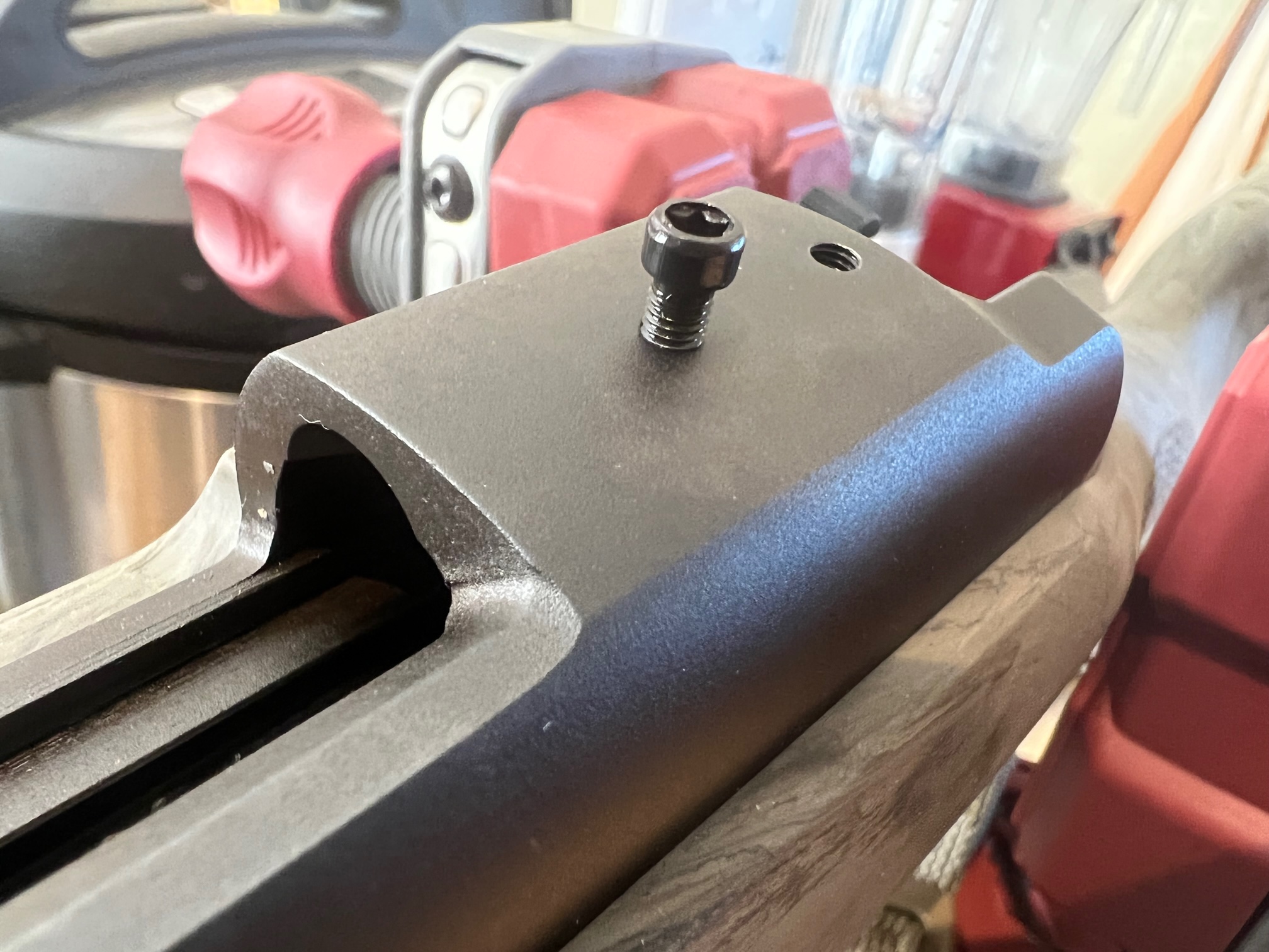

If I put the screws in by themselves (directly into the receiver, without the rail), it has the exact same issue - It starts to thread, feels great - and after maybe 2 rotations, you can feel it start to bind - it gets harder to turn it - I've not been willing to force it at all of course.
It happens the same with and without the rail.
It happens worse on three of the four holes - on the furthest forward hole, it screws in farther before it starts to "bind".
It feels to me, identical to how it feels when you have a very similar type of threading geometry, that starts to bind - and it feels like it will start to strip the screw if I turn it more (so I don't).

Here is a picture of where it starts to bind slightly - the front two holes (especially the very front one) are much better before there is an issue - the screws go in farther.
I don't have a picture of the screws I took out, unfortunately, because I stupidly threw them out, thinking I would not need them again. Stupid, I know.
If the plugs were in and came out easily, the rail screws are either a different size or a different thread pitch. In my opinion, there’s very little chance that the holes are wrong AND the plugs were wrong….it’s way more likely that the rail screws are the size for those holes. Can you take them someplace like a hardware store to check them or at least put your calipers on them and check the diameter?

Yeah that logic makes sense to me too, but I've read about multiple other people having issues with putting in rails with the correct screws - which required a 6-48 tap to make it work better. So in those cases, it seems most likely to me that the screws that came in the receiver from Remington just had looser tolerances possibly.
I'll put calipers on the screws and see what the diameter is - but it matches the holes within a very small amount - you can kind of see that in the picture. And they actually go in maybe 4-5 turns on the rear two holes, so the screws certainly match the holes pretty closely.
Ahh, well 6-40 is standard screw size for the general screws.
6-48 is what the rem 700 should be and is what the screws are that come with the NF rail.
Your rifle may have 6-40.
If you went to the hardware store and bought a 6-40 it probably will thread in.
