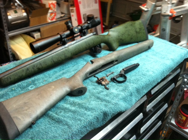

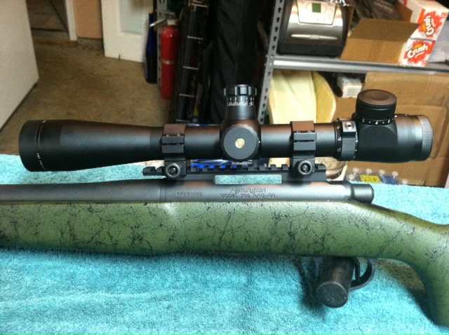

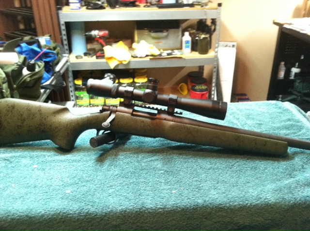

I just finished putting a Bell & Carlson M40 Stock w/ new metal bottom on my Rem.700 AAC, also installed a Timney Straight Trigger, and toped it off w/ Leupod M4 3.5x10 Illm. Mil. Dot. wasn't hard to change everything out(Trigger was easy couple of pins and the bolt spring) and I looked around on the internet and found most the parts on sale. Here is a pic.

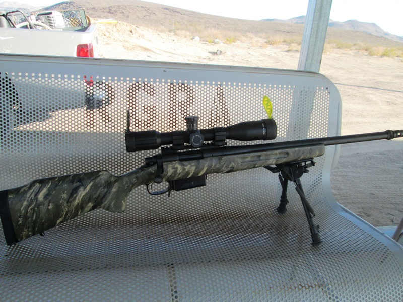

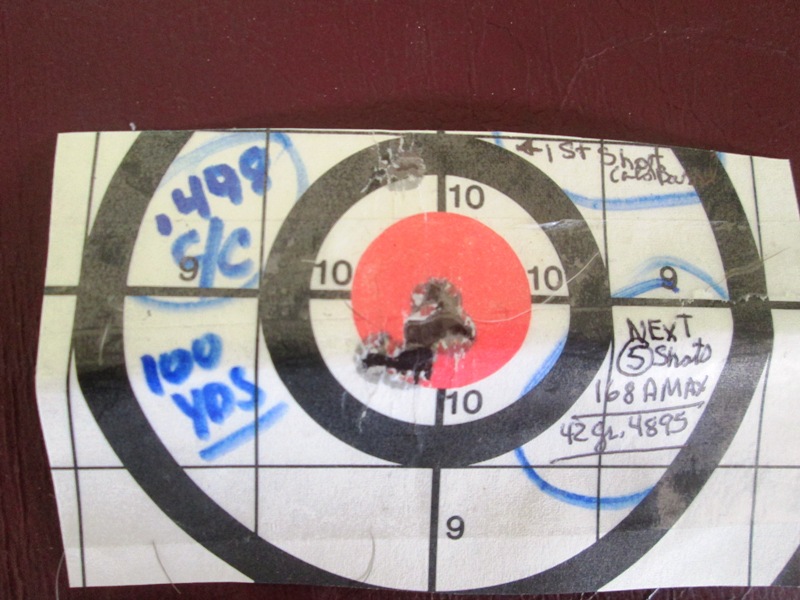

i love mine. swfa 10x scope is amazing. i went with mcmillian stock i got from a member on here, and added dbm, started reloading because as was said on here factory ammo sucks, match ammo is so much better, have fun with it!.
