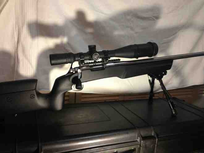

Rem 700 AAC-SD, McM A5, Badger Metal all over, Timney and Leupy Mark4.
I shoot it in tactical matches as well as long range precision matches out to 1100 yards. It struggles past 800 yards but I scare the shit outta the steel.
My next build will sit in a Manners T4A DBM mini-chassis...
